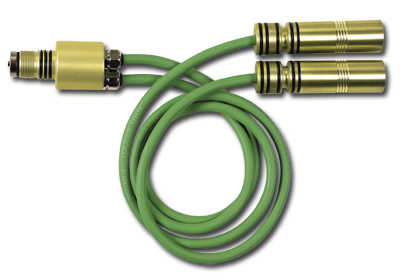

Following these great instructions I've managed to get into the connector on a friends Greenforce 2-outlet umbilical to try to repair a broken connection.
http://www.green-force.com/images/Cable2_lr.png
Unfortunately it appears the broken connection is at the other end. Any ideas on how to get into the other end (the end with both cables in it)? I've undone the agro cable glands and tried pulling the plastic plug (using the springloaded screw) but no matter how hard I pull it won't come out.
Am I missing some trick on getting into this one? Any help gratefully appreciated.
cheers
tsg
Hi,
I never had such one in my hands, so am not sure how to get this one open.
I would expect that you need to unsrew the 2 agro glands so both cables can slide in when getting the plastic cap on the other side out.
I've noticed that rotating the plastic thing while trying to pull it out can help to get it out. Somehow the friction is so high that it is difficult to get it out. by rotating it, the friction gets lower because it is already sliding (although in a perpendicular direction).
I assume the 2 cables are simply soldered in parallel to the connections on the other side, so both cables will need to slide in I guess. But again, I never had such a cable in my hands.
hope this helps,
Johan
