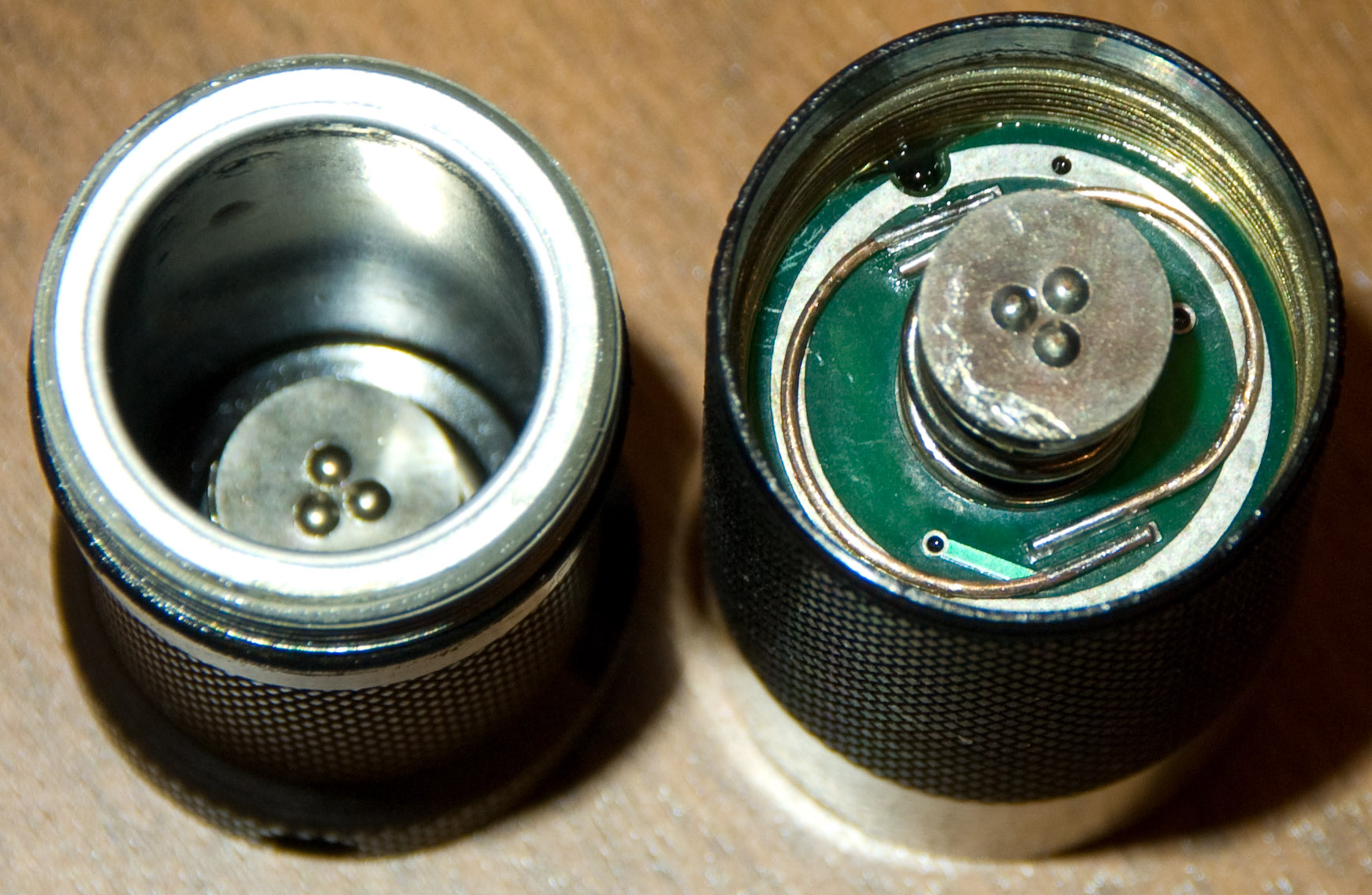

I see that Twisty also has the drawback that the two wire-like parts of the contacts are prone to failure.
Yes, the direct wire contact is kind of reminiscent of the one on some older McGizmo designs, and while very durable and being liked for the lack of any clicky type of switch which could fail, is also open to failure itself if the solder points get fatigued.
Here's an old picture from 2008 by member Bob showing the switching parts.
Unfortunately, here if tighten it too much, the spring can be pulled out of the solder. I had this happen and managed to fix it. Don had a more reliable spring design, there was a protective ring with a slot and when tightened to maximum there was no lateral load on the spring

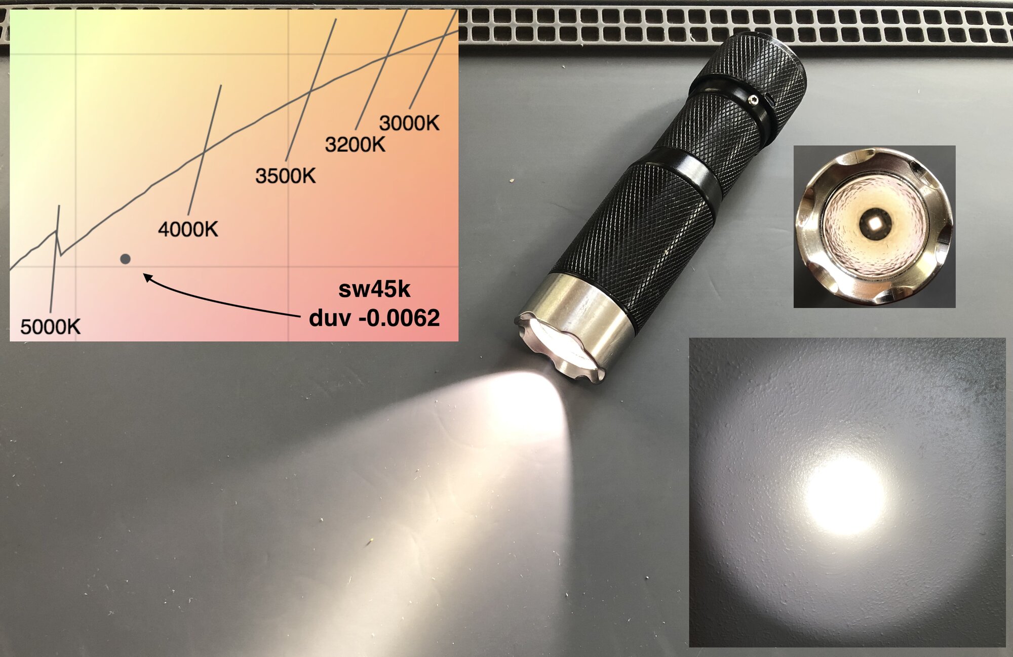

On an sw45k Rotary:
Force Preset on B mode set to the Rotary Dial (single clic),
10 lumen C mode (double clic)
Strobe on D mode (triple clic)
Preset A gives 200 lumens (hold for Turbo)
Locator Flash enabled but toggled off
Step Down (burst) disabled
Programming menu disabled
