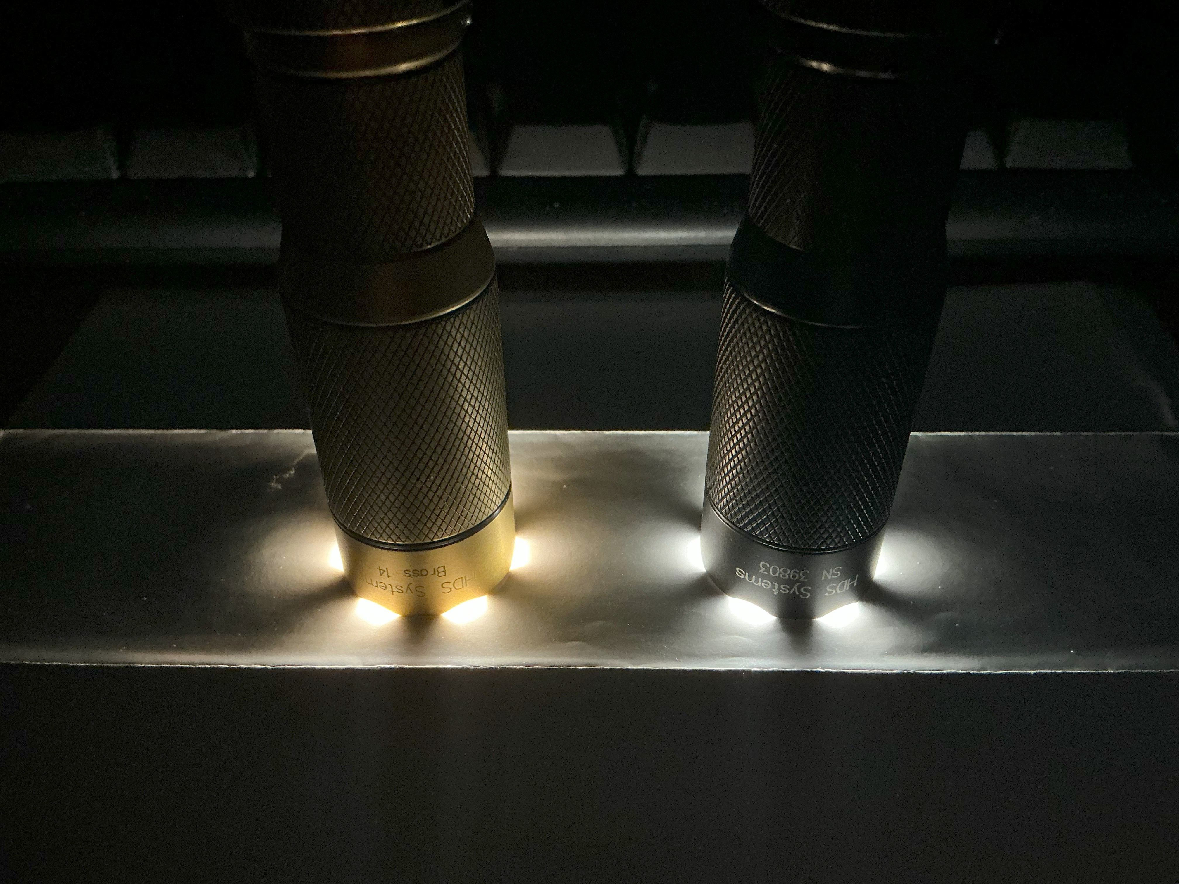

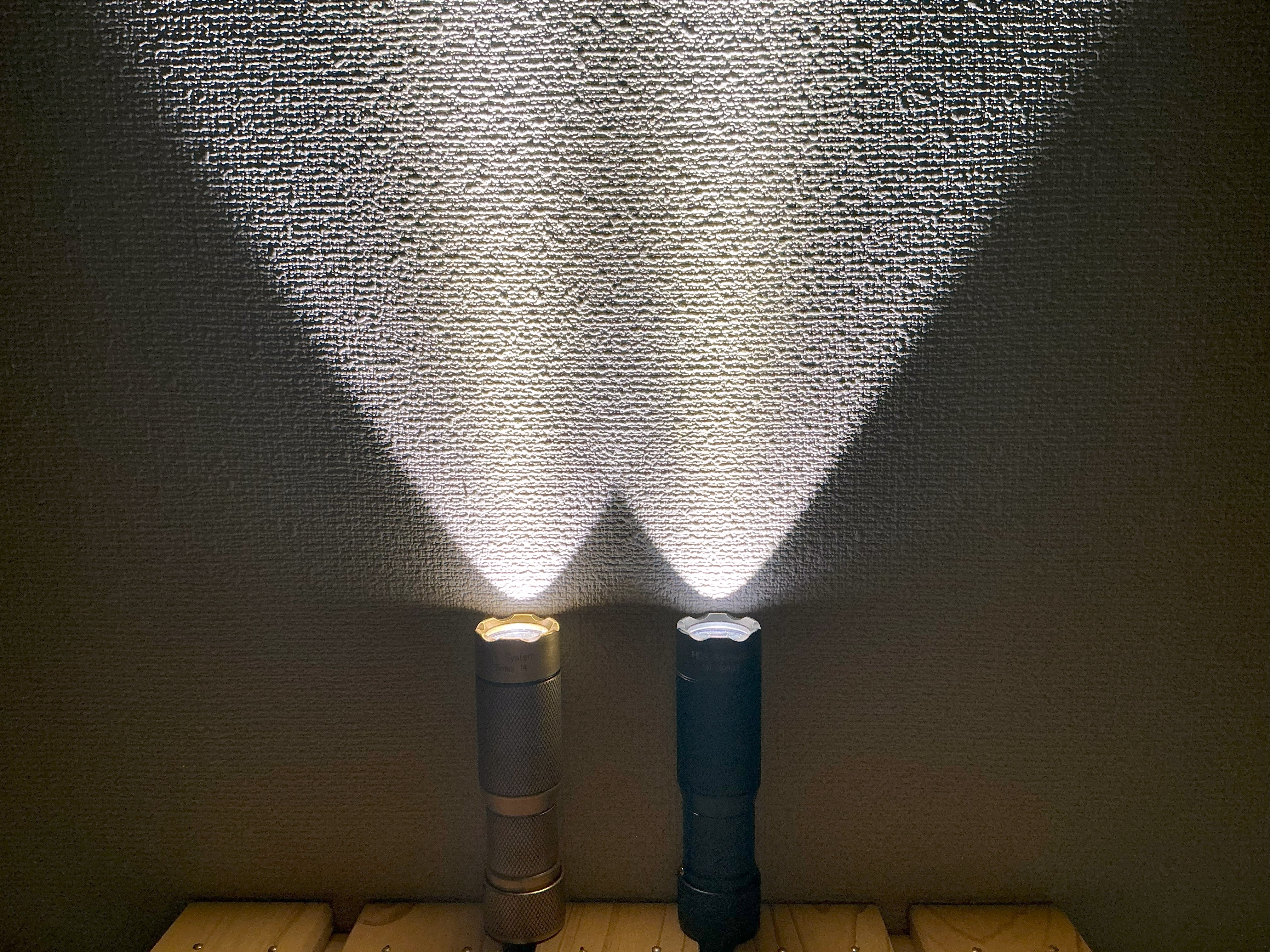

So I've been wanting a McGizmo for a while now but didn't want redundancy in my collection so I went with a Mule on a 1x123 pak. It will be my first mule and didn't really know what to expect so I figured I would just take the reflector assembly off of my rotary and turn it on and see what I think and I was pleasantly surprised by how much I enjoyed not having a defined hotspot but rather just a wall of beautiful light from my NB45.
This got me to thinking how to go about "muling"? my rotary since I really enjoy the user interface. First, I thought about just popping off reflector assembly but it is attached to the bezel and lens. This leads me to thinking I need to modify the reflector to not reflect. How would I do this appropriately? I was surprised that there wasn't an aftermarket mule reflector assembly out there.
The HDS had diffusing reflectors (very small run), a normal reflector is coated with some kind of diffusing substance. The beam shape is essentially the same as the Mule, maybe a slightly narrower beam, but it's perfect up close. I was a fool to give mine a blue glow-in-the-night one and sold after, because I wanted a green one, and finding green ones turned out to be almost impossible
and here are a couple of photos of the rays
Someone here achieved a similar effect by sandblasting a standard reflector, or matte painting it, or both
I think it would be possible to order a cone made of this material that fits into the reflector, but it would be insanely expensive
There is also paint based on barium sulfate. The price is huge, but if you buy it together for 20-30 people, then buying 0.5 liters will be enough for a large number of reflectors. Or it is better to buy 2 kg of pure barium sulfate for several people together, and as Hogo mentioned, using optically transparent epoxy resin to achieve the desired effect
Oh, I see 375 grams for $30!!
I don't really care about glow in the dark, I just need a good Mule
For diffuse reflectors, you can get high reflectivity (>97%) white sheet materials from a couple of vendors, and it's pretty reasonably priced. Typically, it's die-cut or thermoformed, depending on the geometry required. A few examples from a vendor that also can do the forming: https://www.ingemanncomponents.com/category/reflectors/

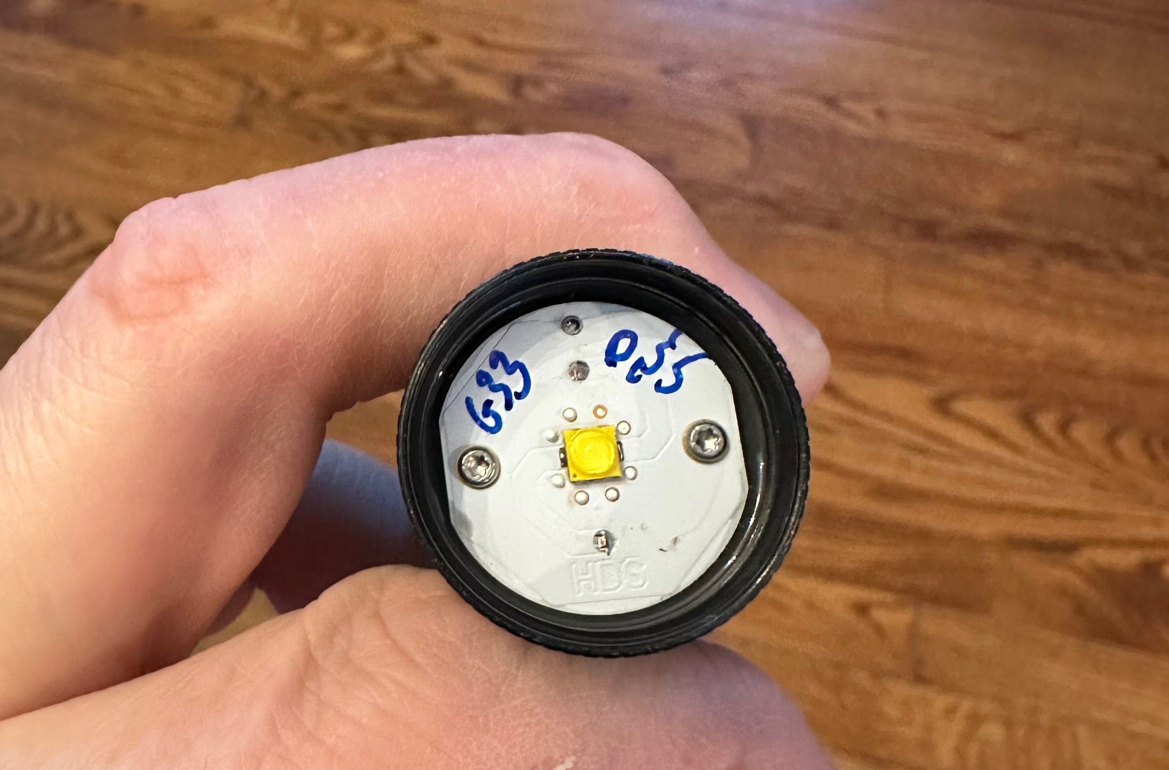

Can anyone decode what’s written on my Panda's board? Thanks!

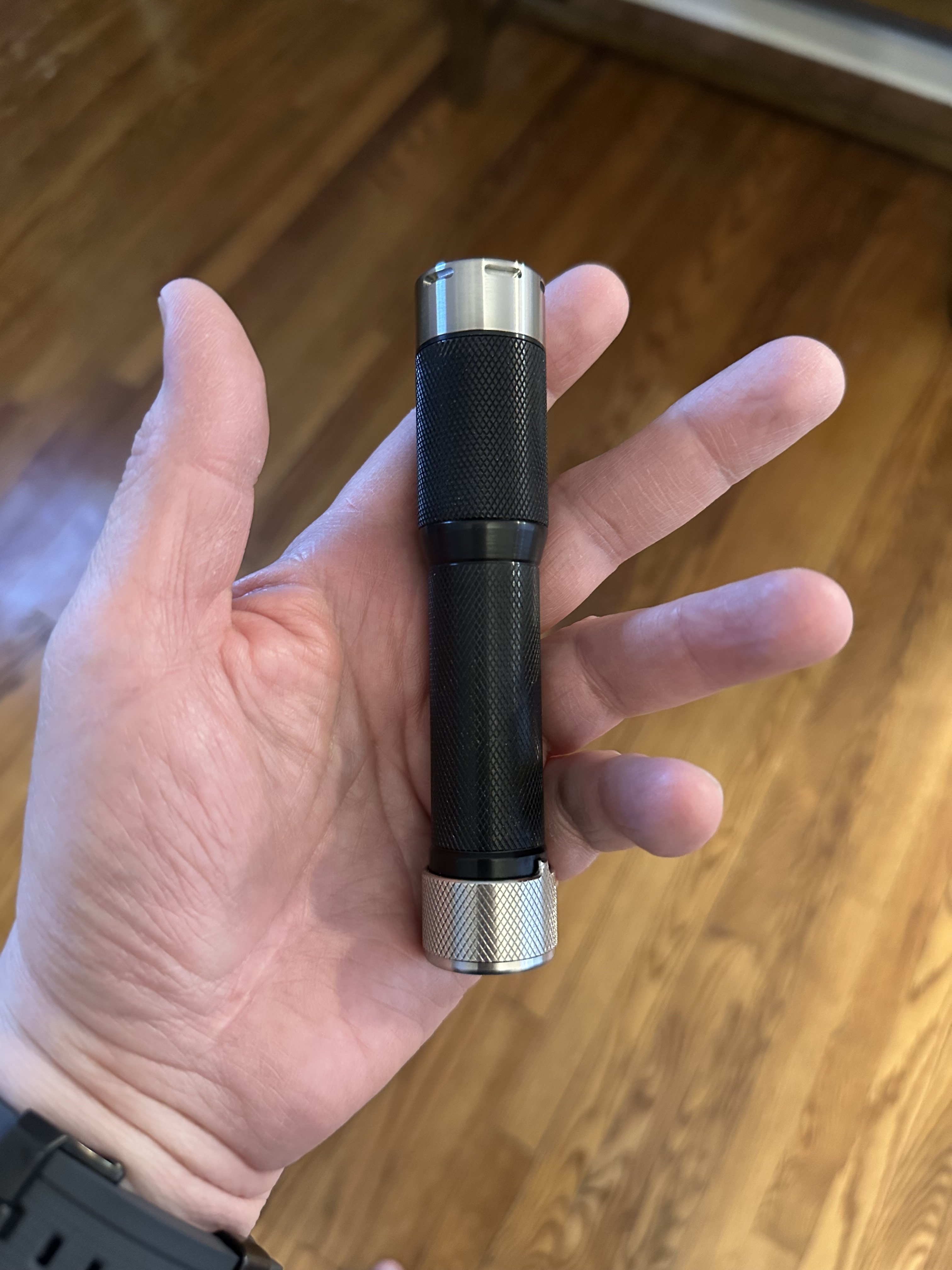

Just swapped the stock bezel for a smooth titanium trit slotted bezel 😍

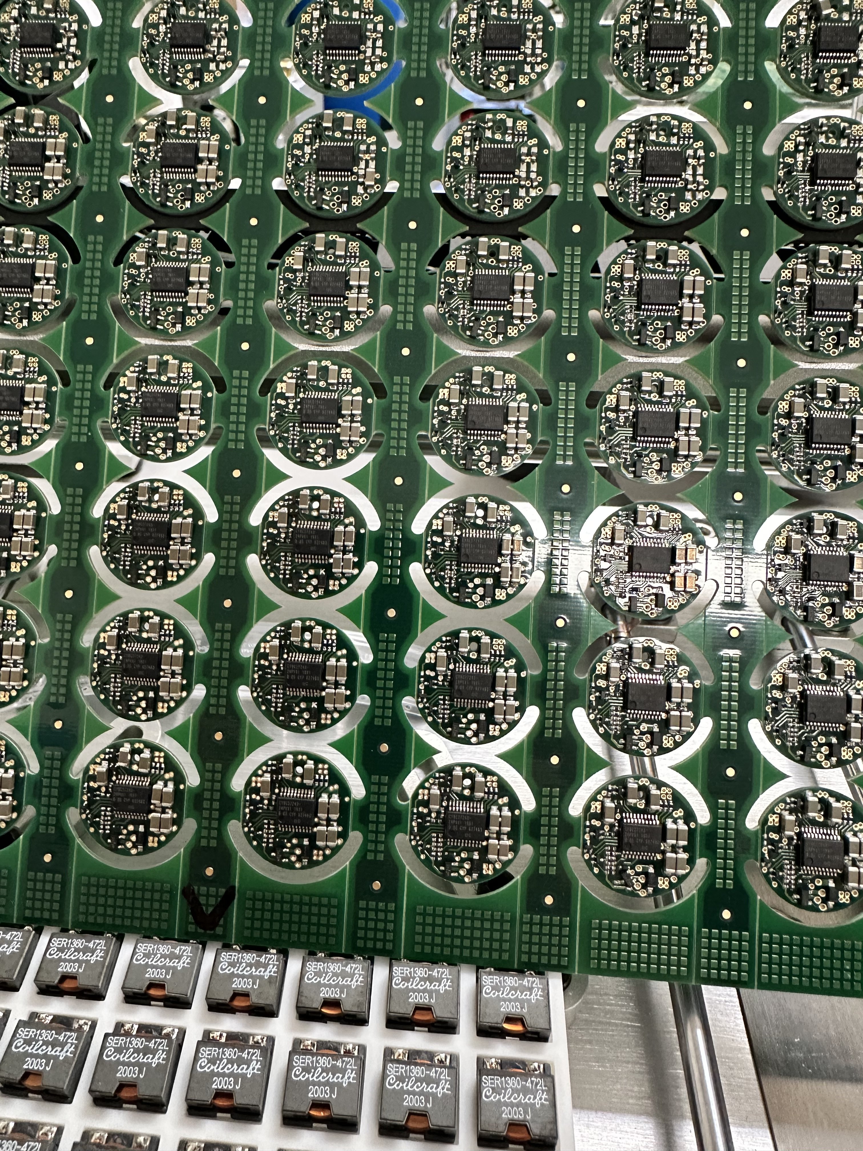

All HDS lights that have been shipping now have all electronics made in house. We are moving to making more things in house so we are not dependent on the whims of other companies and the delays that that can create. It will also allow us to make changes and improvements on the fly.

All HDS lights that have been shipping now have all electronics made in house. We are moving to making more things in house so we are not dependent on the whims of other companies and the delays that that can create. It will also allow us to make changes and improvements on the fly.View attachment 74243

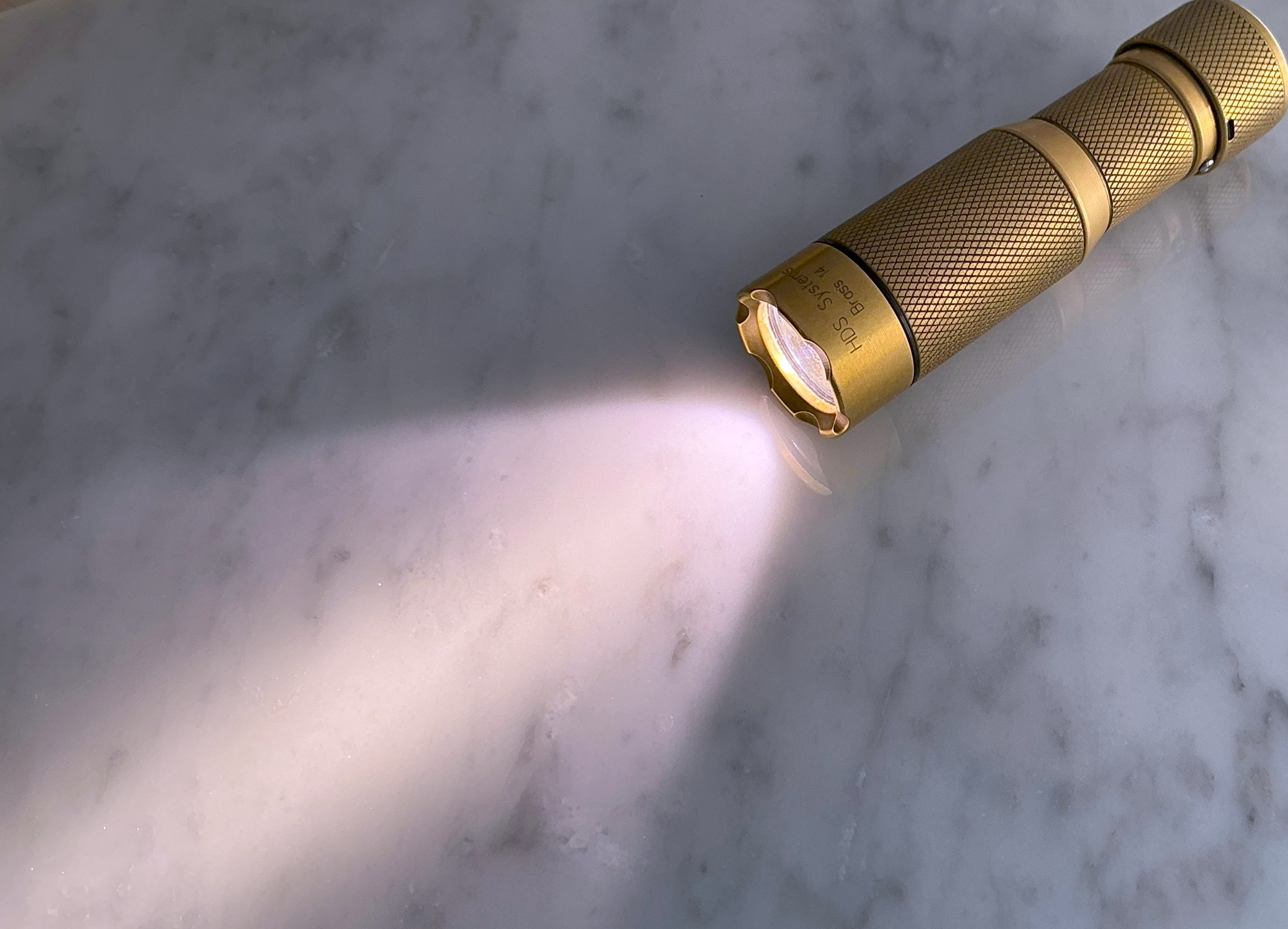

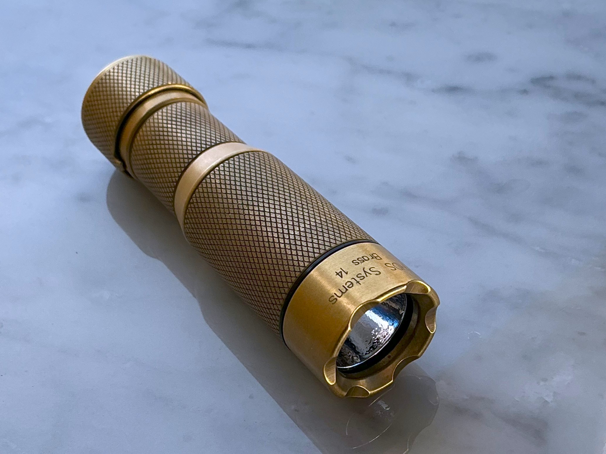

I finally got my hands on a SPECIAL METAL RUN. My first impression is that I was surprised at the weight of this little light. It is heavier than the elzetta bravo. The texture and weight of the brass make this HDS rotary very special. It is interesting that the brass NB45 is slightly more rose-colored than my NB45. I don't know if it's because of the bezel color or the LED specifications, but I prefer the reddish tint, so I like that too.

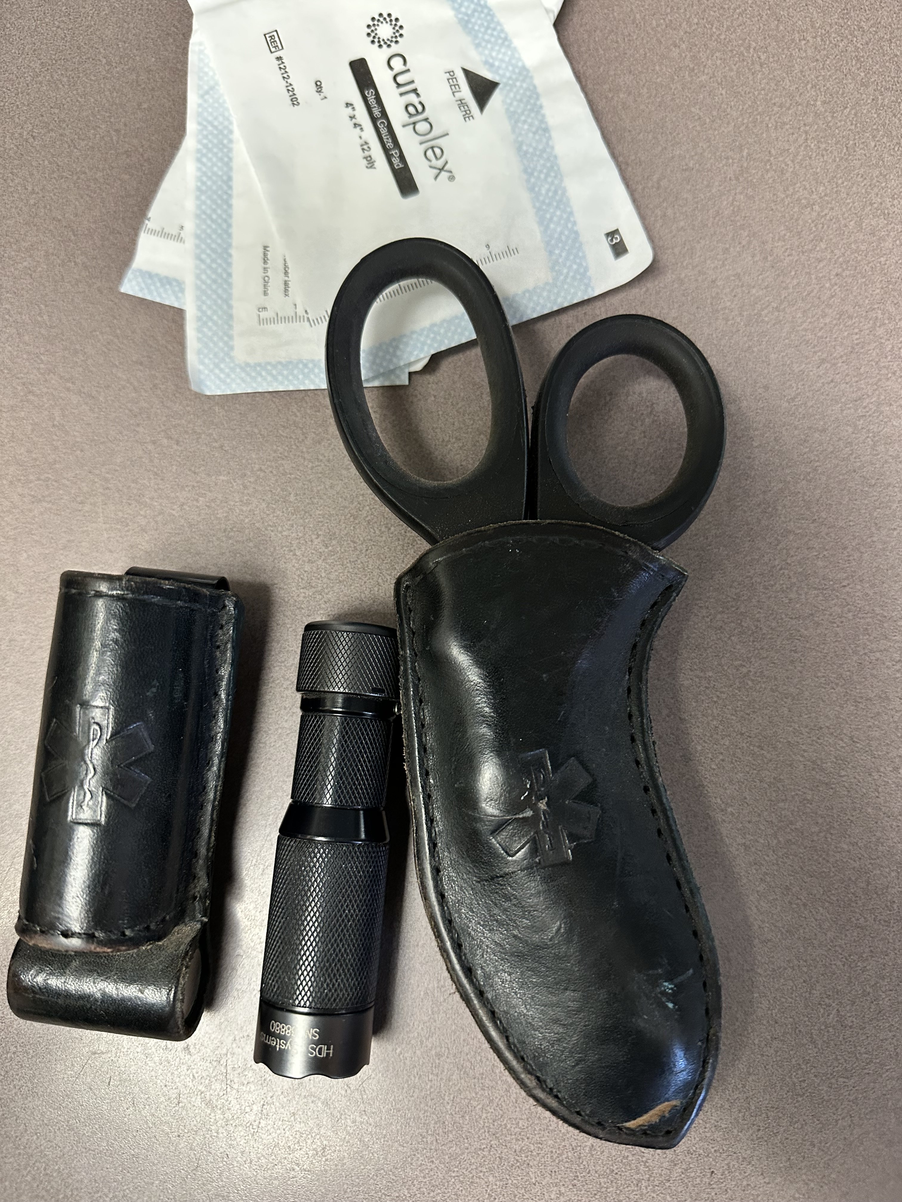

I carry a 200 lumen High Noon at work. I have on several occasions used the strobe function to signal a medivac chopper in the Arizona wilderness… at high noon, in order to help them locate us and the improvised landing zone. Each time I do it, I ask the pilot if a. He could see it, and b. If it was helpful. I get the same response each time… "yes" and "yes". Just like this morning. The pilot said the on board paramedic pointed out the strobe and thus the landing zone. Apparently, there was another white truck 1/2 a mile away and the ambulance was hidden under some trees and was difficult to see from the air in the valley we were at.

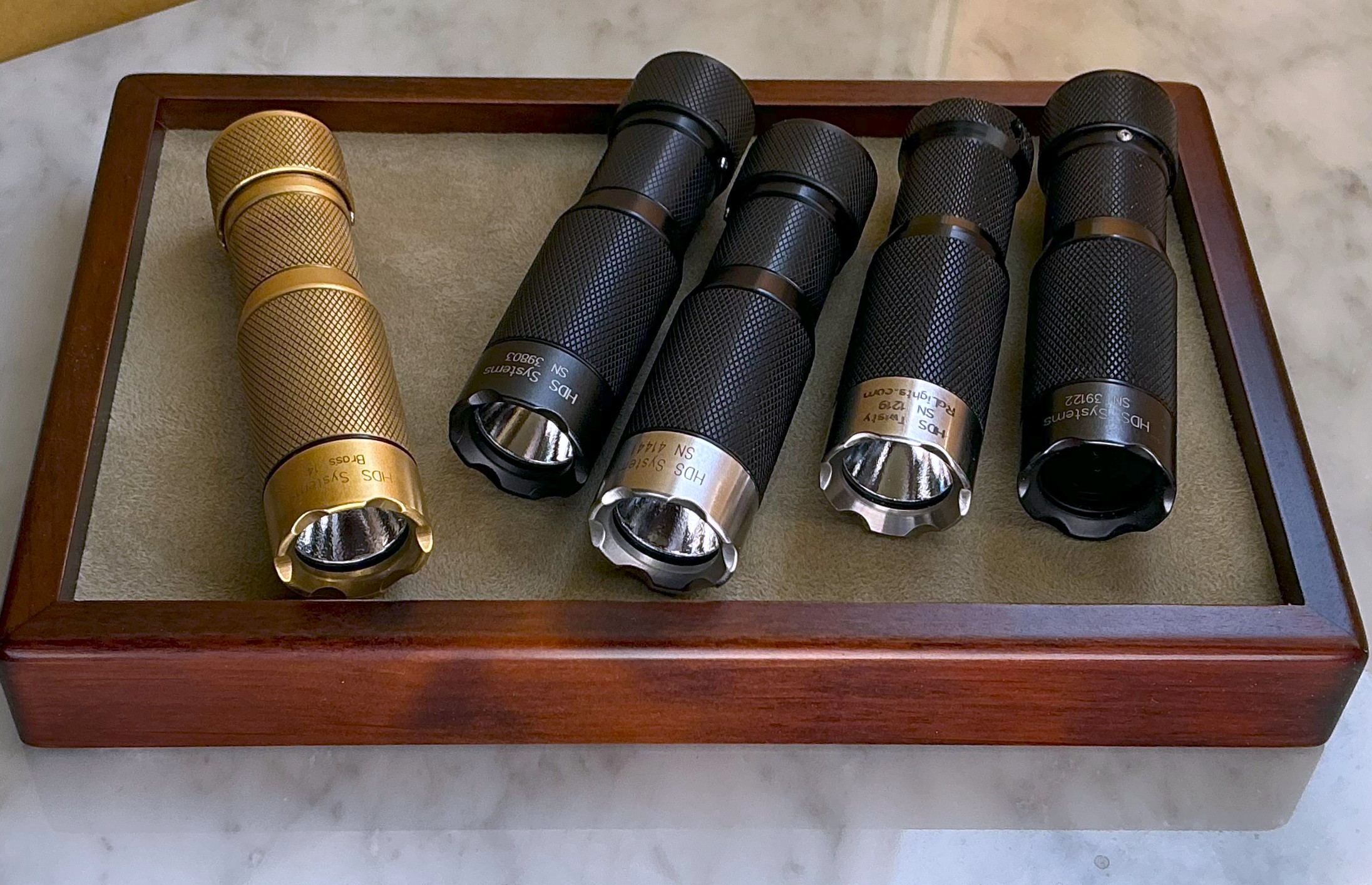

The brass Rotary was here sold
The Special metal Rotaries are great. I m happy to have tons of Special metal rotaries.
