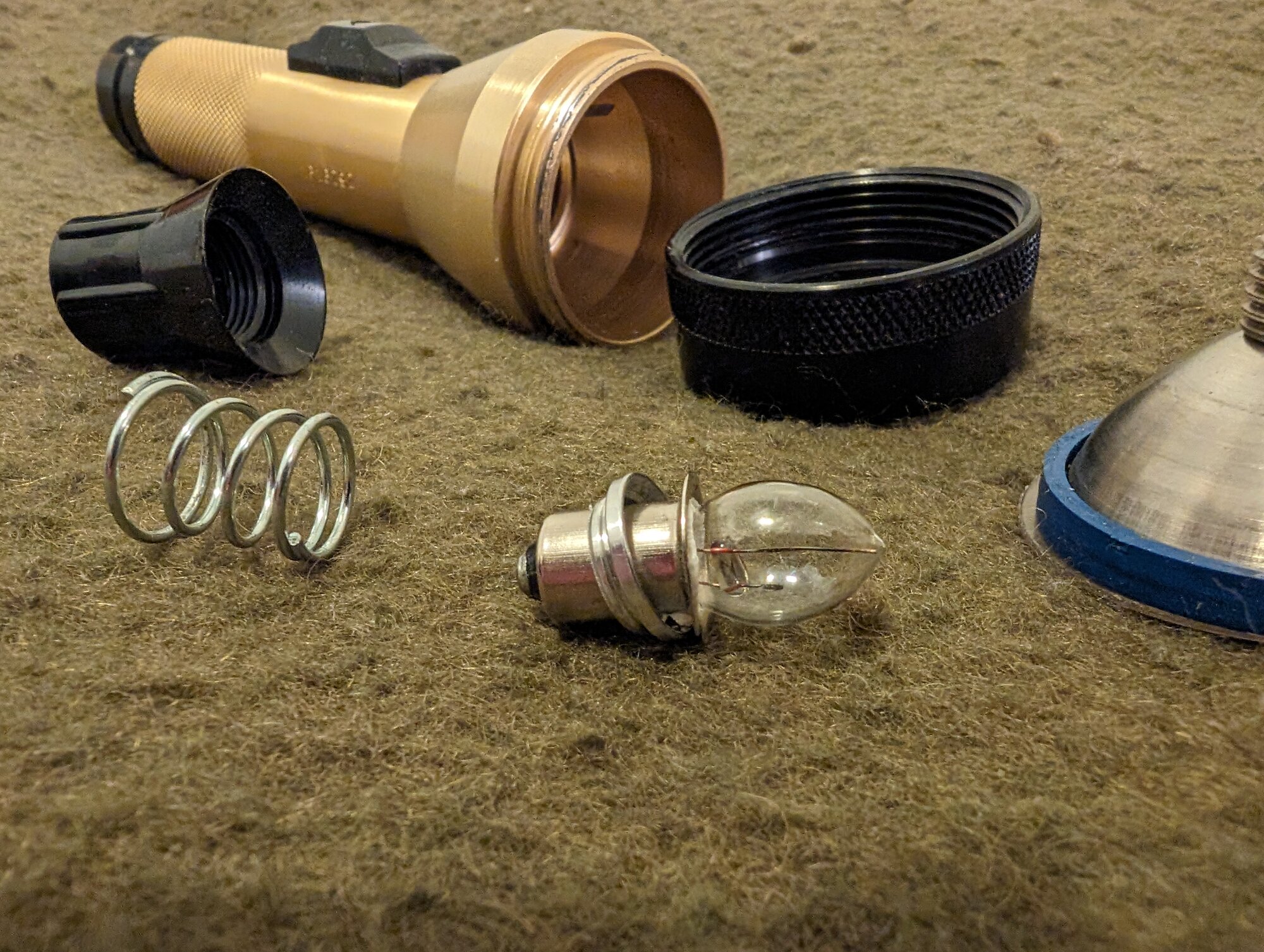

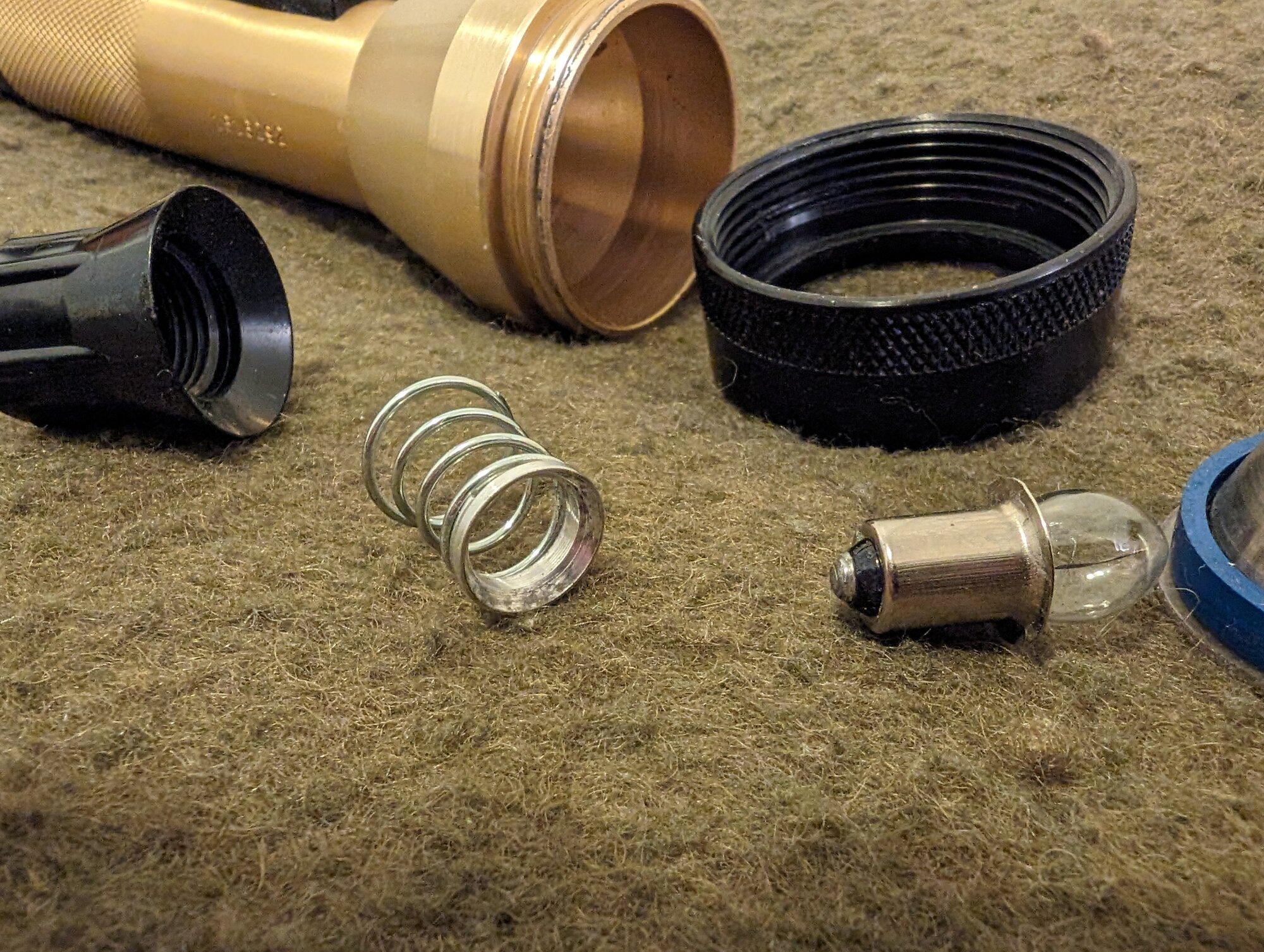

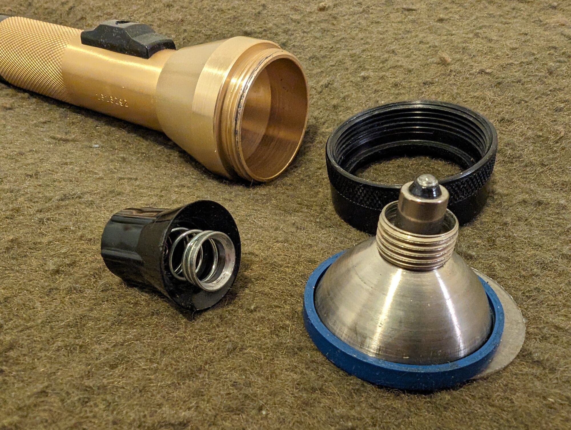

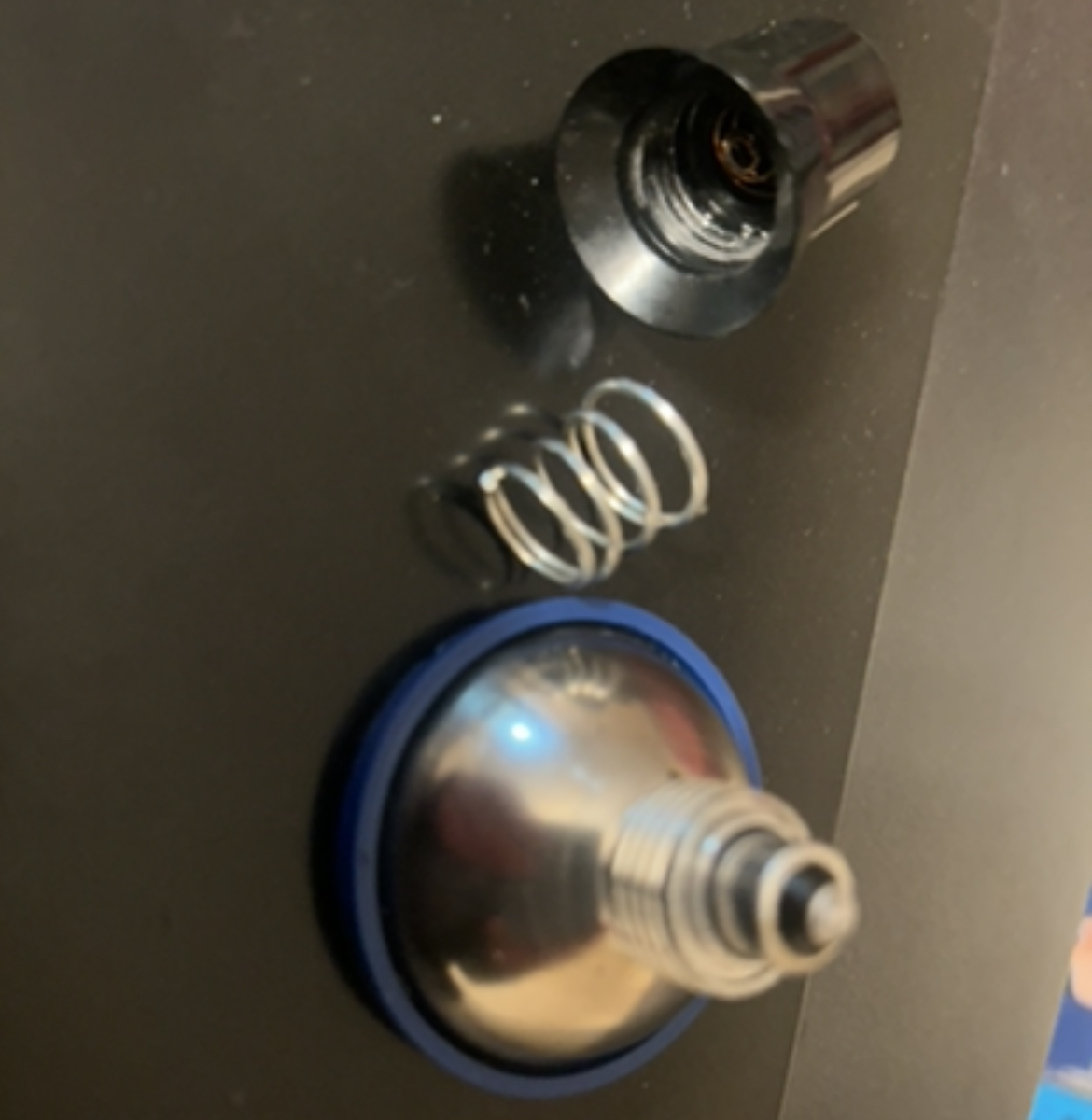

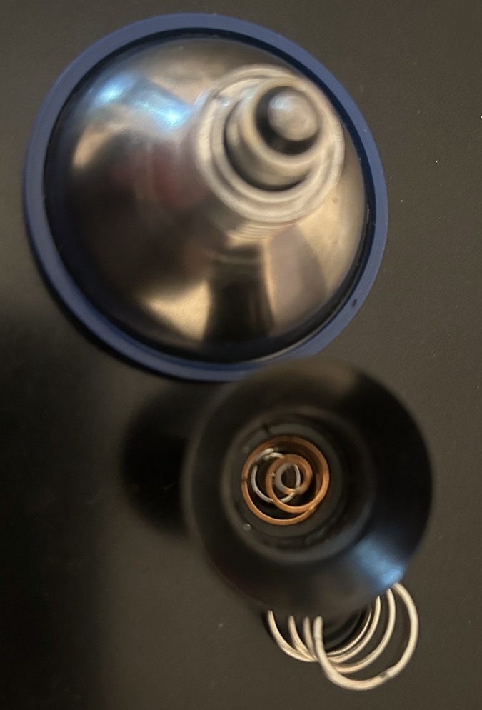

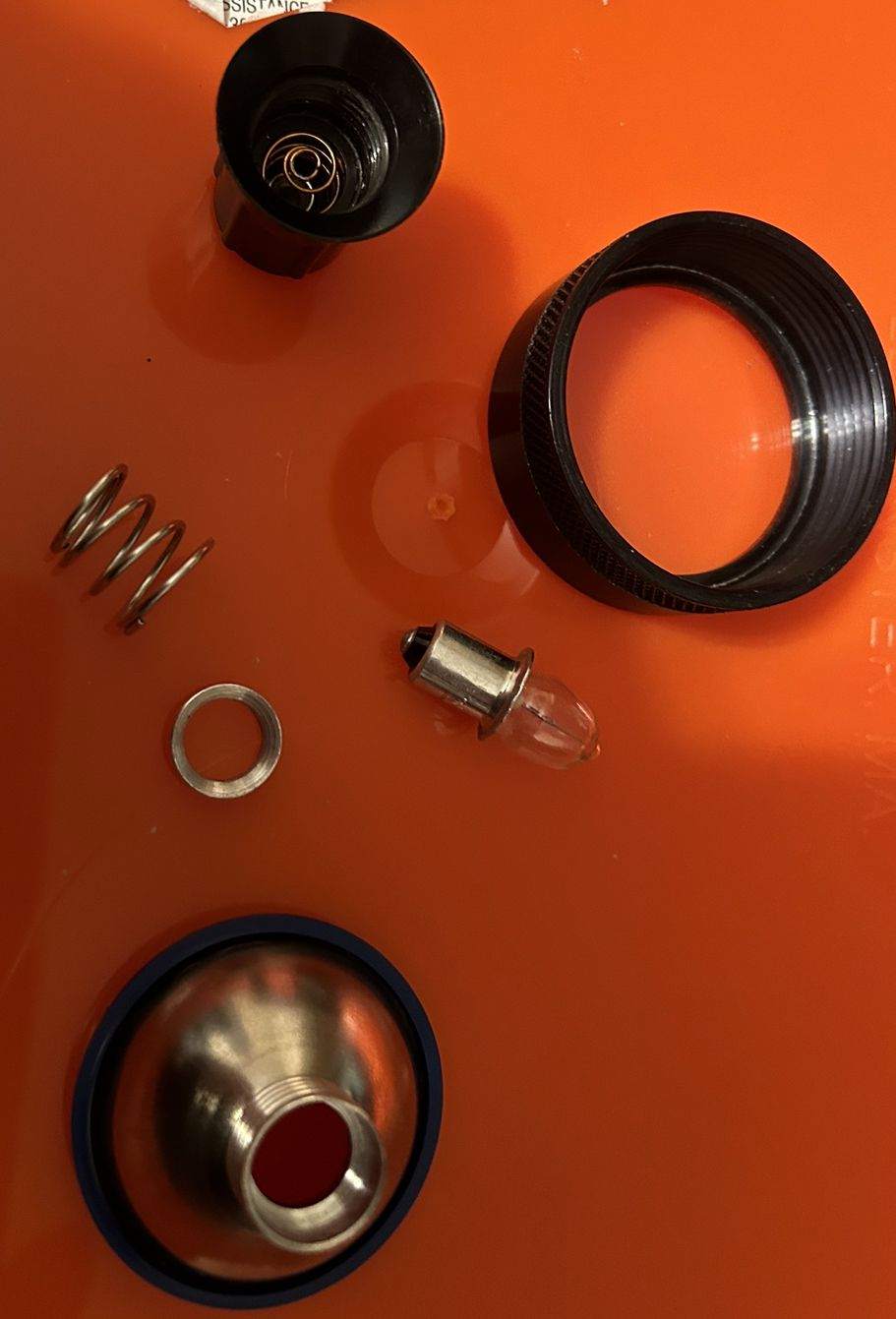

Now what?
    441.5 KB
    664.6 KB
Huh, I think the bushing at the end of the bulb retaining spring has come off and gotten stuck in the socket. You need to gently pull/push the bulb out. That silver ring surrounding the bulb base should be on the end of the large spring.

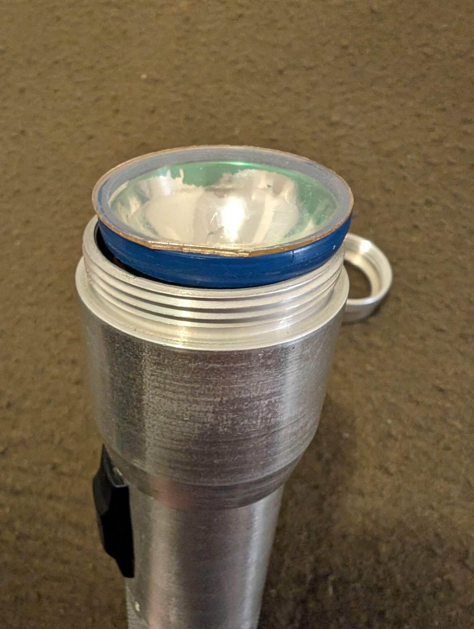

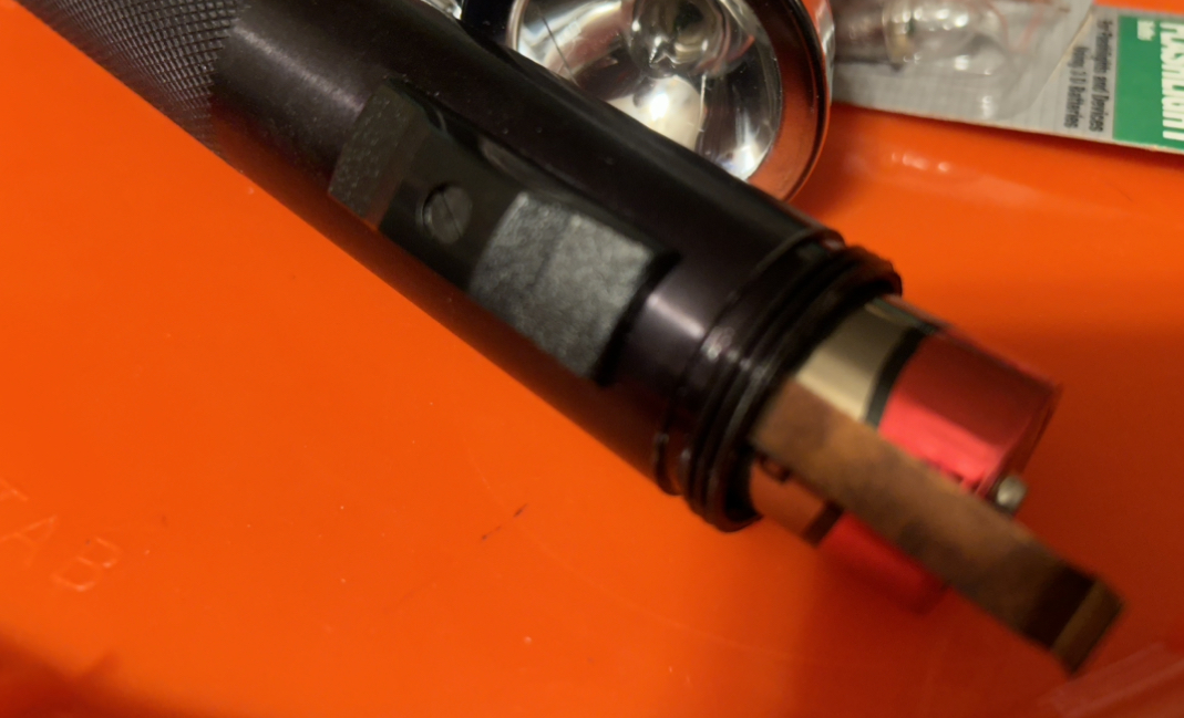

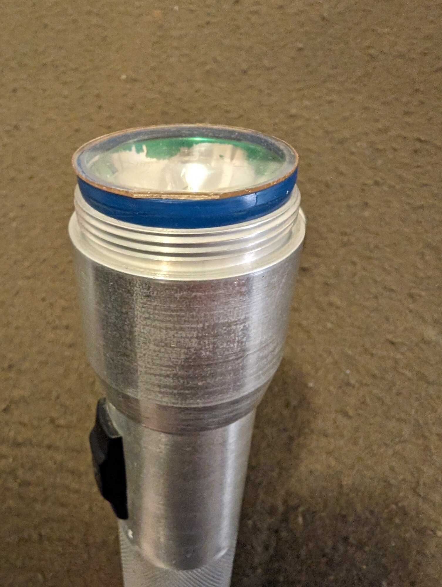

Now that I changed the bulb the switch doesn't work. If you whack a palm it it will turn on but either position the switch does nothing. How do I fix this?
Post a pic of the light. If it's the black plastic sliding switch you may need to bend the flat negative contact down just slightly. One way to test the correct switch alignment: Take the bezel off so the reflector is loose resting on the head body. With the switch in the on position it should push the reflector sideways a little, but not in the off position.
If it's the metal 3-way switch, the negative contact always needs to gently be pressing on the reflector. The switches themselves rarely go out of whack unless someone's tinkered with it.
