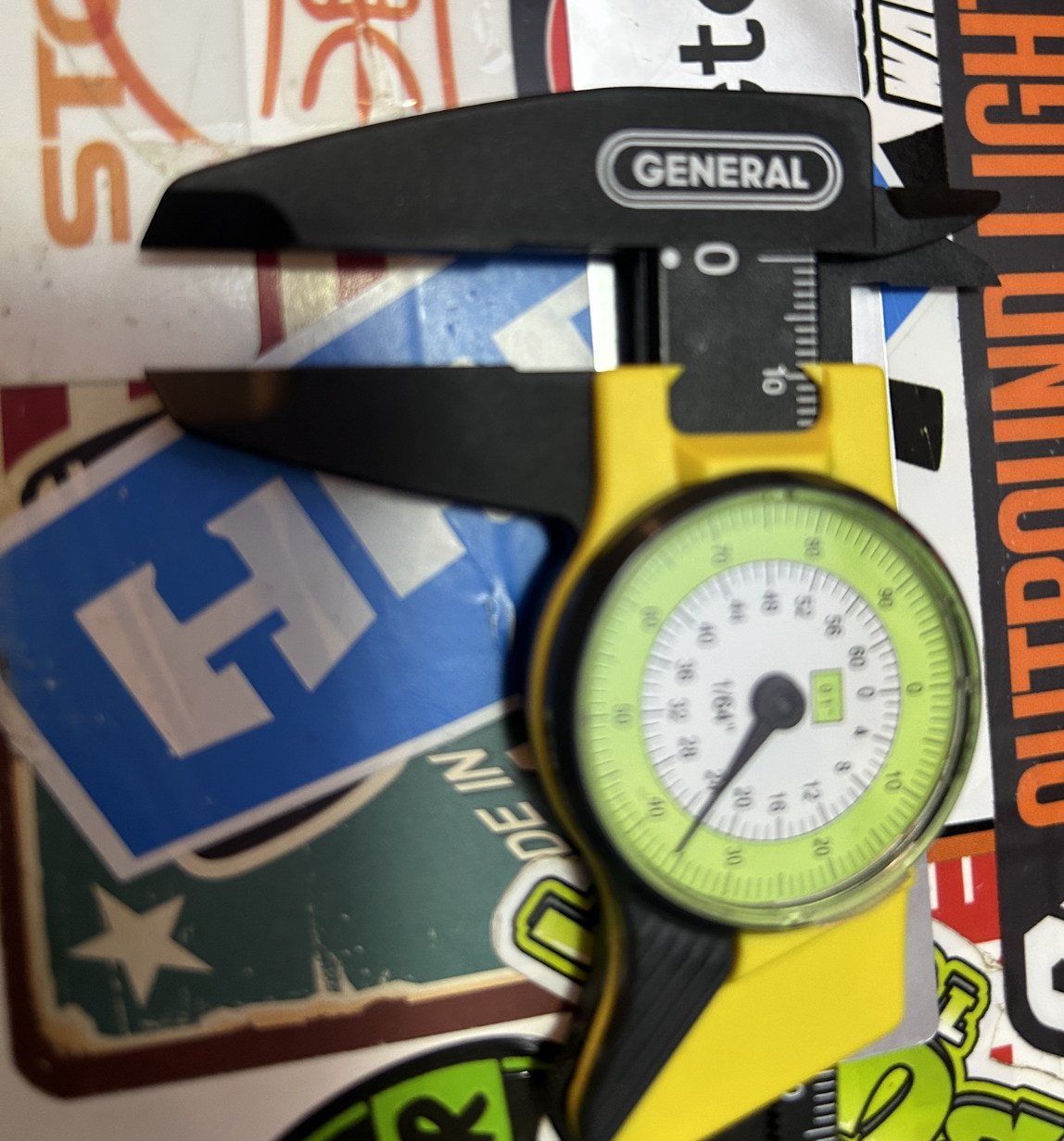

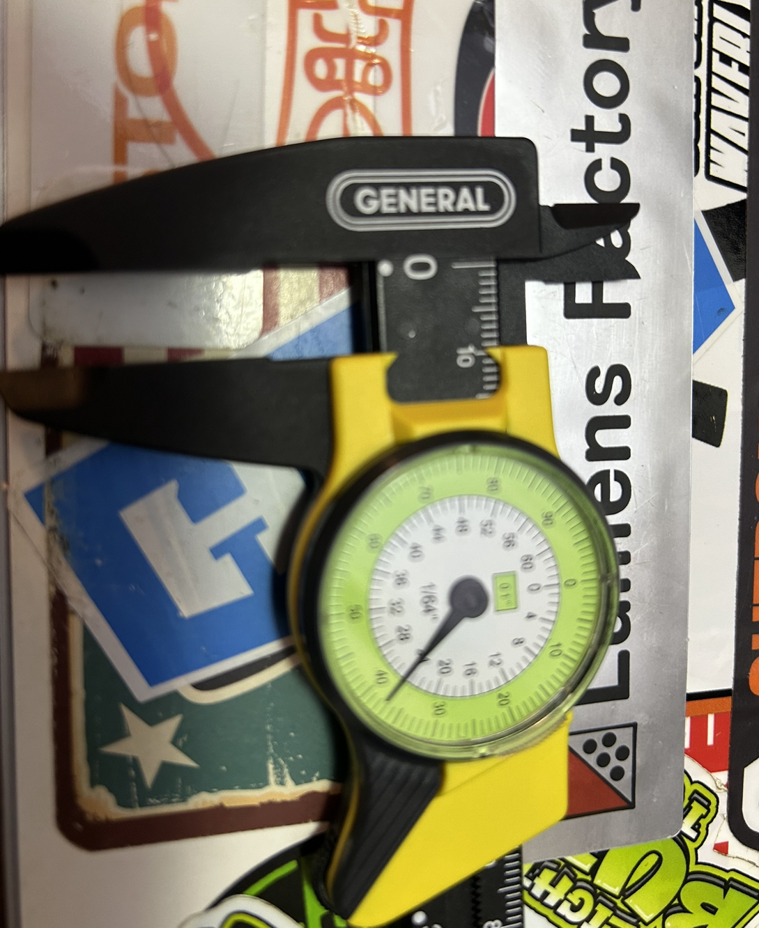

Actually just got one that had an ancient GE "Perma-Cell" rechargeable stuck in it (not leaking thankfully) so I can measure a period battery. The old GE cell is the same length as newer Panasonic, Rayovac, and Dorcy carbon-zinc C-cells at about 49mm. The Energizer and Duracell alkalines I have measure between 49-50.5mm, with the newer batteries being the longest. A whole stack of those could be at least 7mm off original specs.
There was some variation is how long they actually made the body tubes so being too snug is a real possiblity.
