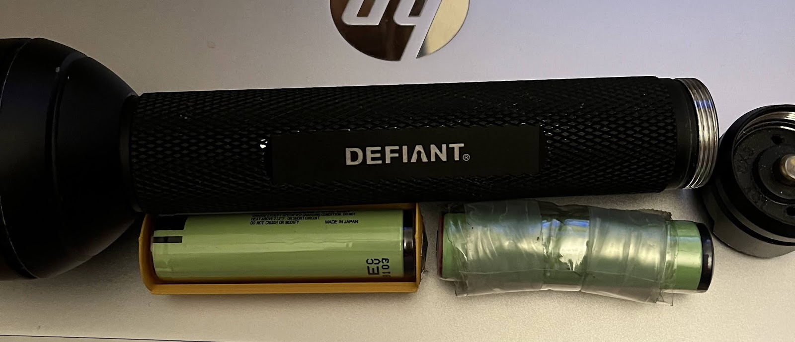

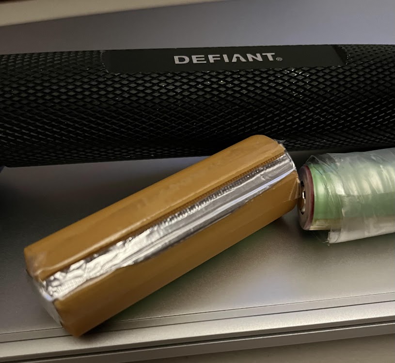

Participating in this thread made me think of this:
On a napkin I drew up a concept, and had my Grandson make up a CAD plan for a 3D printer. His teacher printed it out.
It is a spacer that converts a 3C cell light into a single 18650 light. It acts as a carrier for a backup/extra 18650 cell. It allows for the current to pass around the back up cell.
If you depleted both 18650's you can replace them with fresh ones, or switch back to using 3 alkaline cells.

My daughter and eldest son both own 3D printers. Can I get the printer control input plan to try? Would it fit in the large number of 3 D cell Maglites I already have in hand thanks to the generosity of people here?
Tom Horne
The dimensions for a 3D mag are completely different. No it won't work.
With a 3D mag you may do well just using alkaline cells. For a rechargeable option, you may go with Tenergy 8000 or 10000 mah NiMH low self discharge cells.
They may give a shorter run time, but the output will remain higher longer. The discharge curve is more flat than that of an alkaline.
