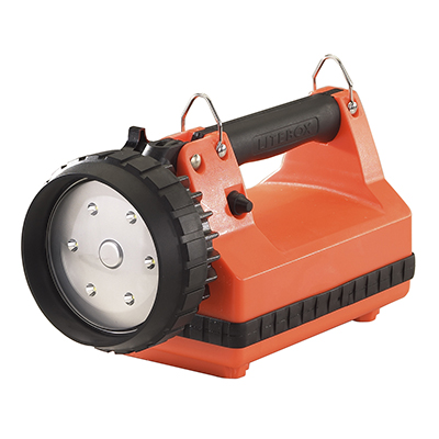

Keep in mind that such searches are Very Low Incidence with Very High Consequences events. A counselors load out cannot be heavily oriented to such events. Weight and size are issues. As an example one counselor might carry a collapsible back pack pump tank fire extinguisher, with a soft bag tank, foam nozzle, and a 5 oz. bottle of foam concentrate, but only during "Very High" or "Extreme" fire weather conditions but they would not carry it full of 5 gallons of water @ 8.3 pounds per gallon unless the weather service issued a Red Flag warning for fast fire spread and easy ignition conditions. Under red flag conditions the counselors would have to reapportion their loads so that one of them could bare up under the 45 pound weight for the filled fire pump alone. Red Flag conditions existing prior to trip departure would cause additional staff and logistic support dedicated to fire prevention and incipient fire suppression or the cancellation of the trip altogether depending on the availability of the additional staff.
The flood or zoom focus light would have to run for ~8 hours to cover the night portion of the first operational period before the search was supported by public safety personnel and search & rescue volunteers and logistics support for things like replacement batteries.

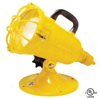

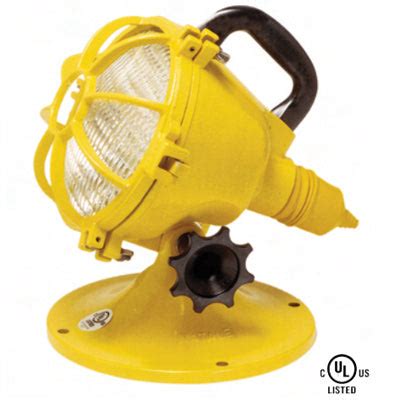

Remember that what we need is a somewhat wide beam of even light. Something along the light distribution of a fire service portable flood light portable flood light large.jpgPortable flood light small.jpg
in a far smaller battery powered light. The rangers don't hesitate to use 12 volt flood lights
carried on a strap over their shoulder because they only have to carry it during a search. Something with much less weight and size, that a counselor could carry on an entire 5 day trip without hating life, with ≥8 hours duration and is what I'm hoping to find. [He doesn't want much does he?]
This is were the expertise of forum's members comes in to suggest a lighter and smaller light that could last as long as the Streamlite Litebox while producing a wide pattern, with an even light distribution to support the needs of searchers working in greened up deciduous woodland.
