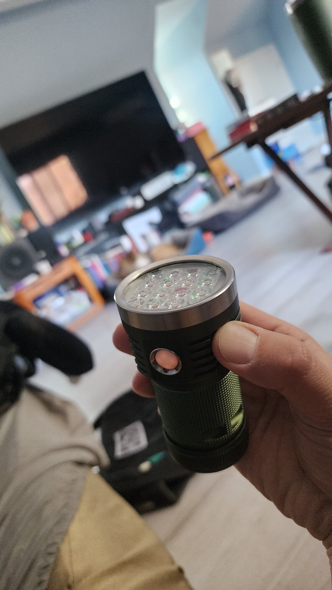

This soda can size light is a beast!
It's a dual led setup, 4500k and 6000k.
