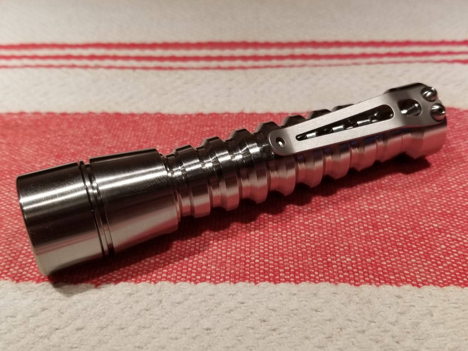

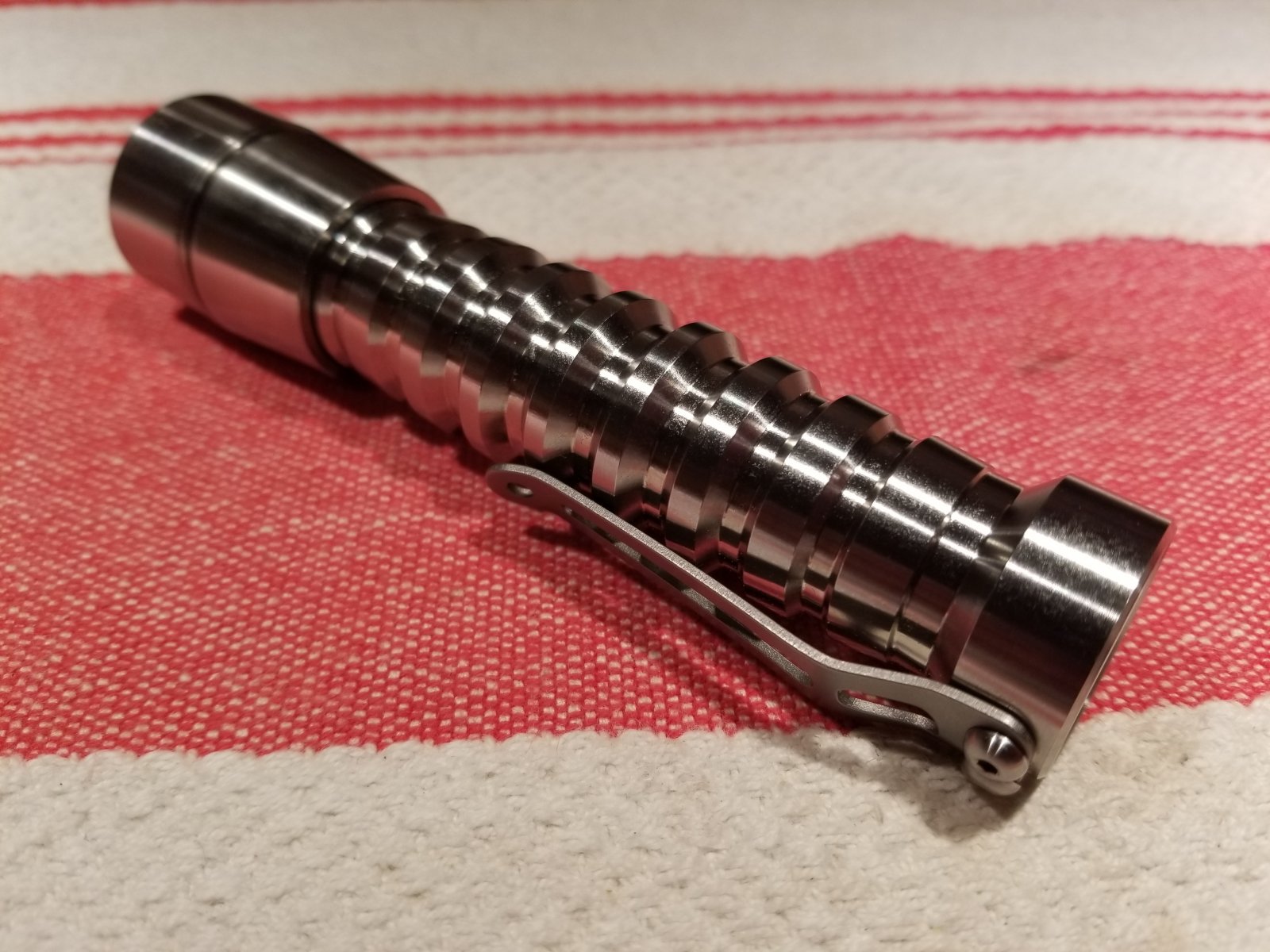

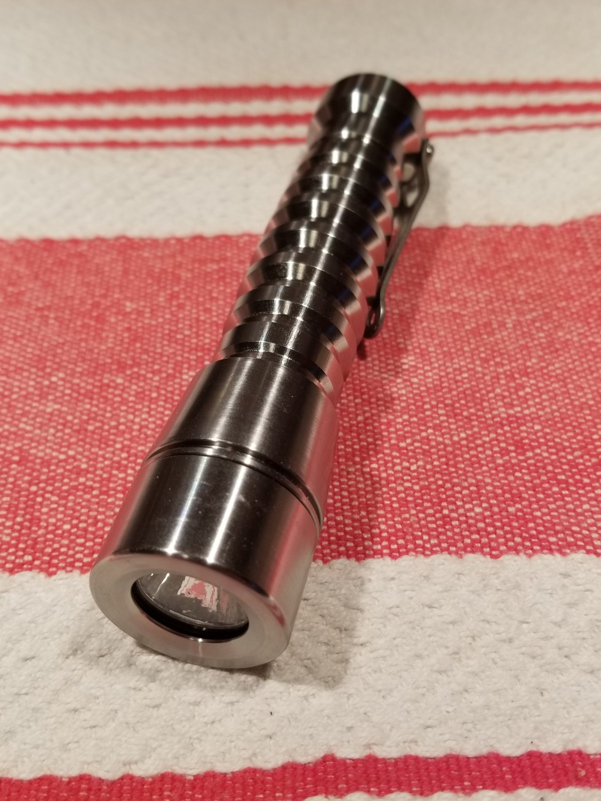

Here is a picture of a VME head on an Aleph 1.5 body with an RPM tail. Overall length is 4.5 inches. I use one CR123 and a spacer in it.
Malkoff Ti VME head, McGizmo Ti 2x16340/1x16650 McClickie Pak, and Malkoff M361 N219C 92CRI 3000K drop-in:
