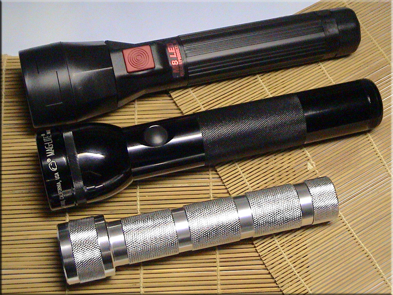

Here's a pic of the two side-by-side with a 2D Mag in there for comparison:
You'll notice that the FT3C is much smaller than the other two, but they weigh about the same due to the aluminum body of the FT3C vs the plastic body of the M8 LED.

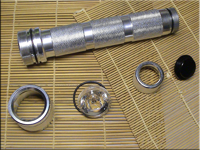

A shot of the FT3C disassembled:
The FT3C consists of the bezel ring, o-ring for the head, 30mm optic, body, and two-part tailswitch. I believe the heat sink does also unscrew, but I didn't remove mine to see.

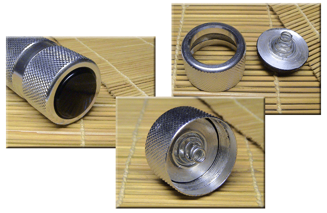

Here's a pic of the tailswitch on the FT3C:
To be honest, I really am not too fond of this switch. It's a momentary pushbutton on, with a twist for constant on. The pushbutton is rather difficult to activate on mine--it's one of those where you don't really feel like it's moving at all but the light eventually goes on. It's also difficult for me to maintain a constant beam with the button. Even the constant on is pretty flaky. At times it flickers and I have to tighten the cap extra hard to keep it from flickering. I don't know if this is limited to my specific light or if it happens in all of them. Either way, the clickie switch on the body of the M8 is much better for me.

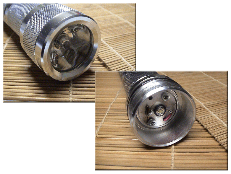

A picture of the front end shows the 30mm, 6 degree optic for the Luxeon III and with the optic removed you get a good look at the emitter. Unfortunately mine doesn't include the star, so I can't tell what bin it is. It is very white, though.

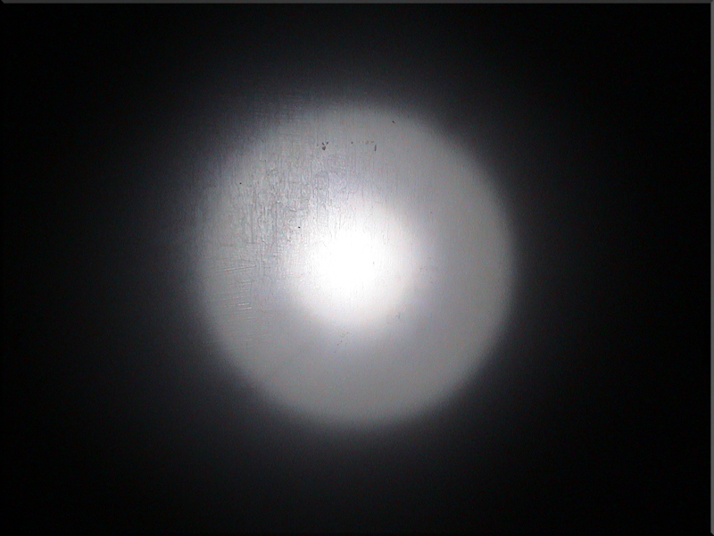

This is a shot of the FT3C beam by itself. It has a nice round hotspot in the middle with some sidespill. There is more spill that my camera didn't pick up.

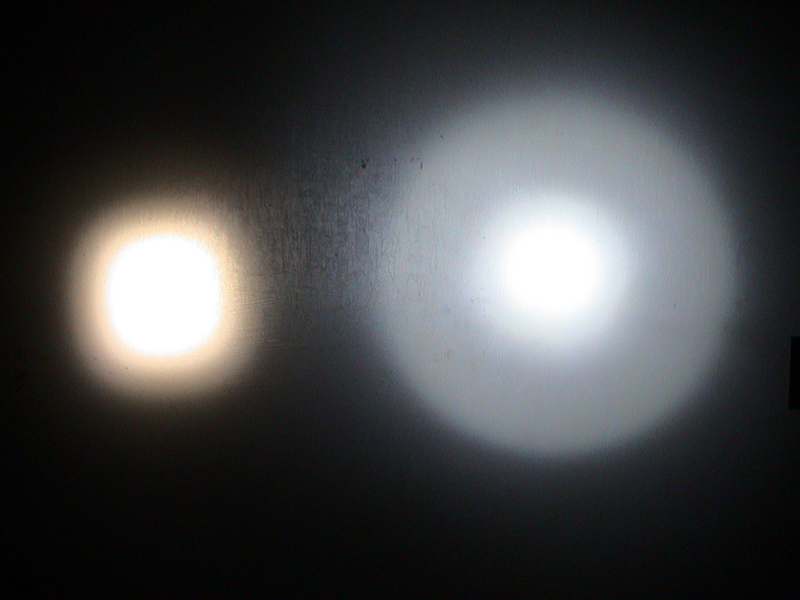

And a shot of the M8 LED (left) vs the FT3C
As you can see, the M8 LED has that squarish beam and while it isn't quite as white as the FT3C beam, it's really not as yellow as it looks in the shot. It's more of a warm white. The M8 is rated at 30 lumens (Pelican site) with a 6 hour burn time and the FT3C is rated at 72 lumens with "12 hours of constant high brightness" on NiMH C cells (Elektrolumens site). The M8 beam is a really tight beam with little to no sidespill. This does take some getting used to but hasn't really been a problem thus far. Both lights have great throw due to the Recoil Technology of the M8 and the 30mm optic on the FT3C does a nice job. I think the M8 still outthrows the FT3C, but not by very much (hard to tell since I don't have a large enough testing area).
