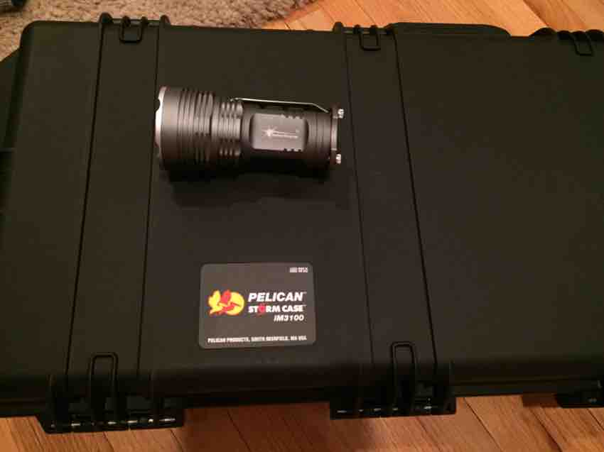

Don't have it set up yet but my first case. Awesome quality, hefty, seemingly indestructible. I need to figure out how to cut the inserts since this one has solid foam, not the prescored type.
Not sure if I have the right knife. I see ppl using electric knives in YouTube
Never tried electric, but I can see that working well. The opposing sawing motion could keep the foam from deflecting while cutting.
It depends on how pretty you want it. The first ones I did were cut with a large, thick bladed pocket knife meant for camping. Not a delicate tool, but yet it worked just fine for holding the lights, even if the cuts were a little ragged.
I use a heated Knife I bought at harbor freight for around 10 dollars. You just have to be careful because the foam will stick to your fingers when pulling it out and gloves make it difficult. You'll pick it up fast how to do it tho. I put blue tape over the entire foam then drew lines around my lights after I arranged how I wanted them. Then cut the blue tape with a utility Knife then used the heated tool to cut down to required depth then pushed it threw to size...
This was my first attempt so it can be done extremely clean with practice. With the pre-cut squares it's a little messy....
