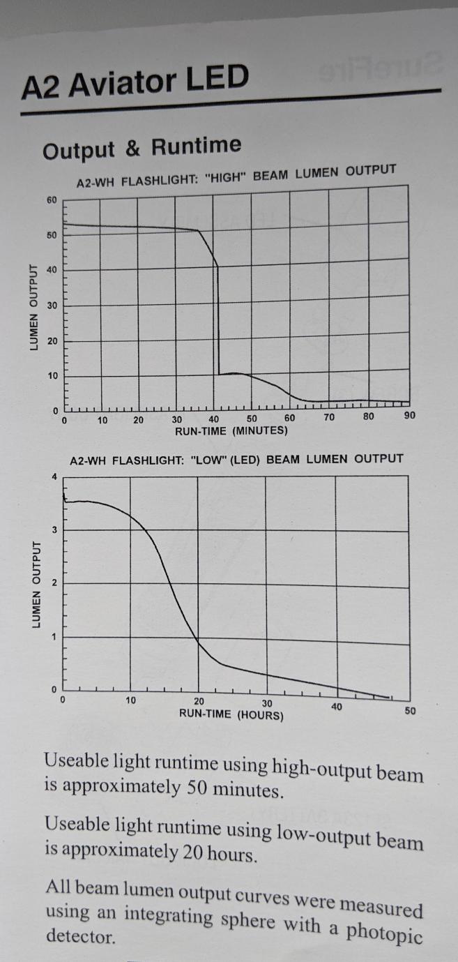

Other than Surefire, I mean.

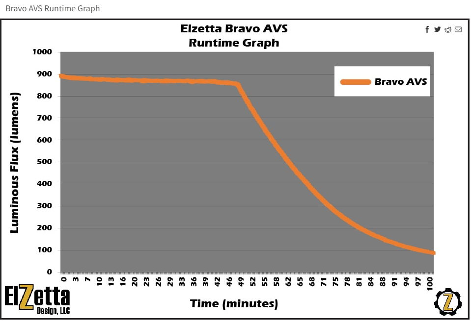

Elzetta usually includes graphs as well:
( image source )

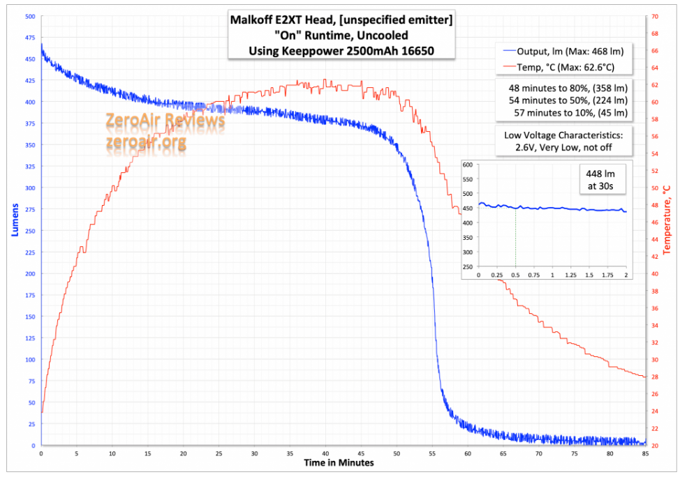

And the Malkoff stated output is usually the regulated output, so it holds it pretty well:
( image source )

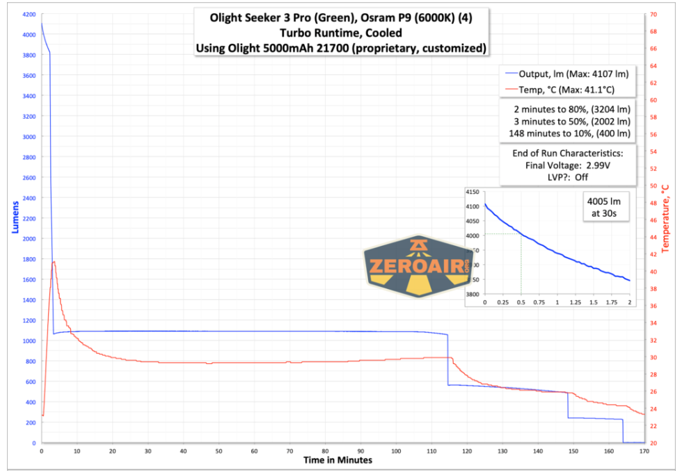

compare that to the chinesium lights, where the claimed 4200 lumens is sustained for 1-2 minutes:
( image source )
