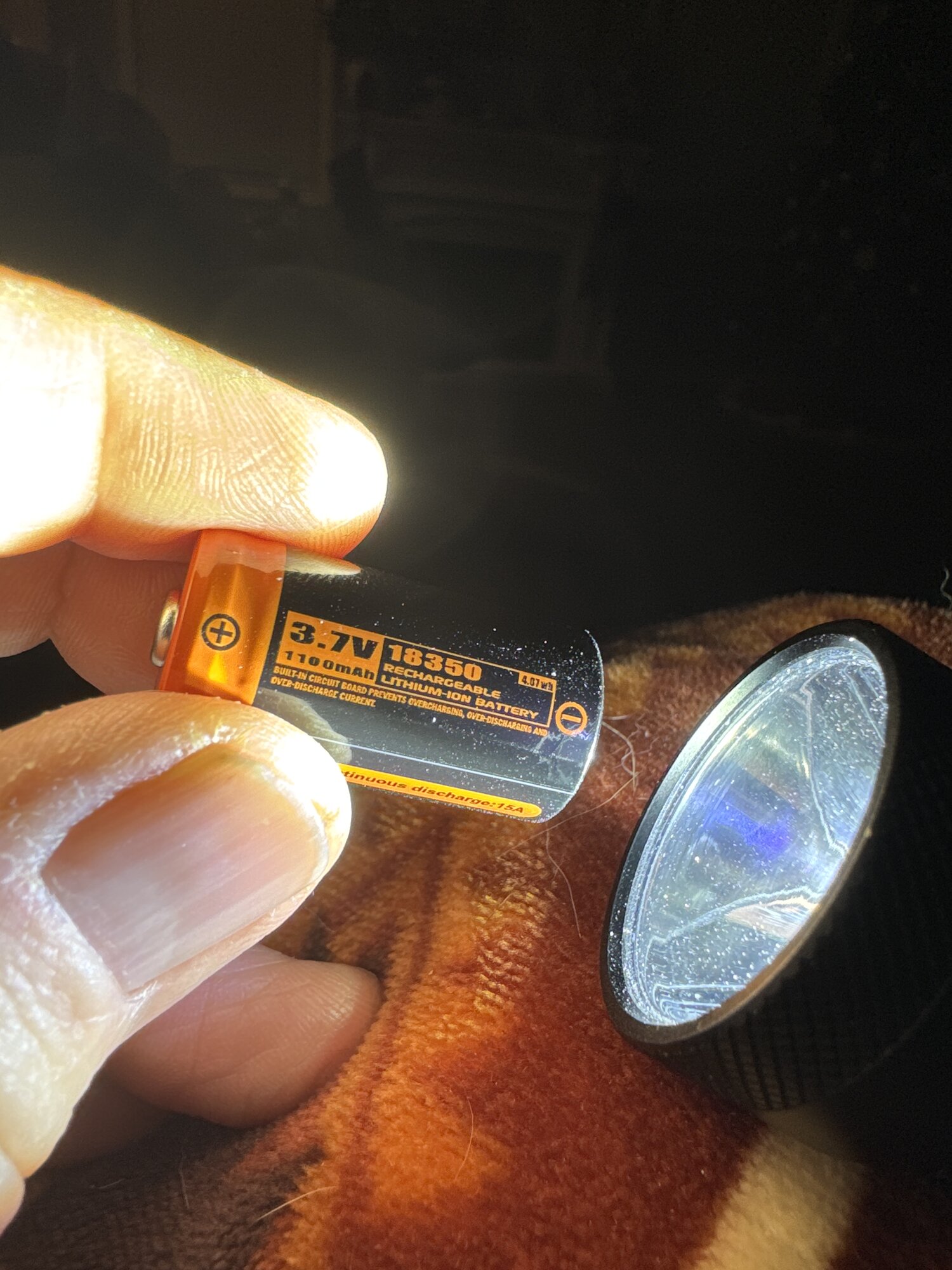

I was under the impression that a 18350 is interchangeable with a 123? I know my Manker that uses a 18350 can also use a 123. Size looks the same not sure if it’s compatible with your light though?
18350 is much wider than a CR123. Won't fit in an unmodified 6P. I think you’re thinking of 16350.

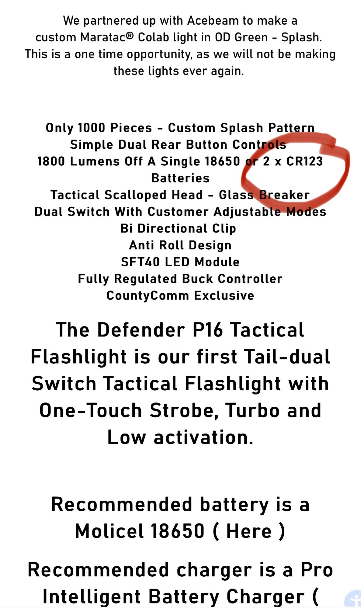

This one? I’ll check the stats i may have my lights mixed up. My Manker’s tube extends to accept a 18650. Thought it mentioned a 123 as another option. They seem similar in size but maybe the 123 fits a little loose in my light?
