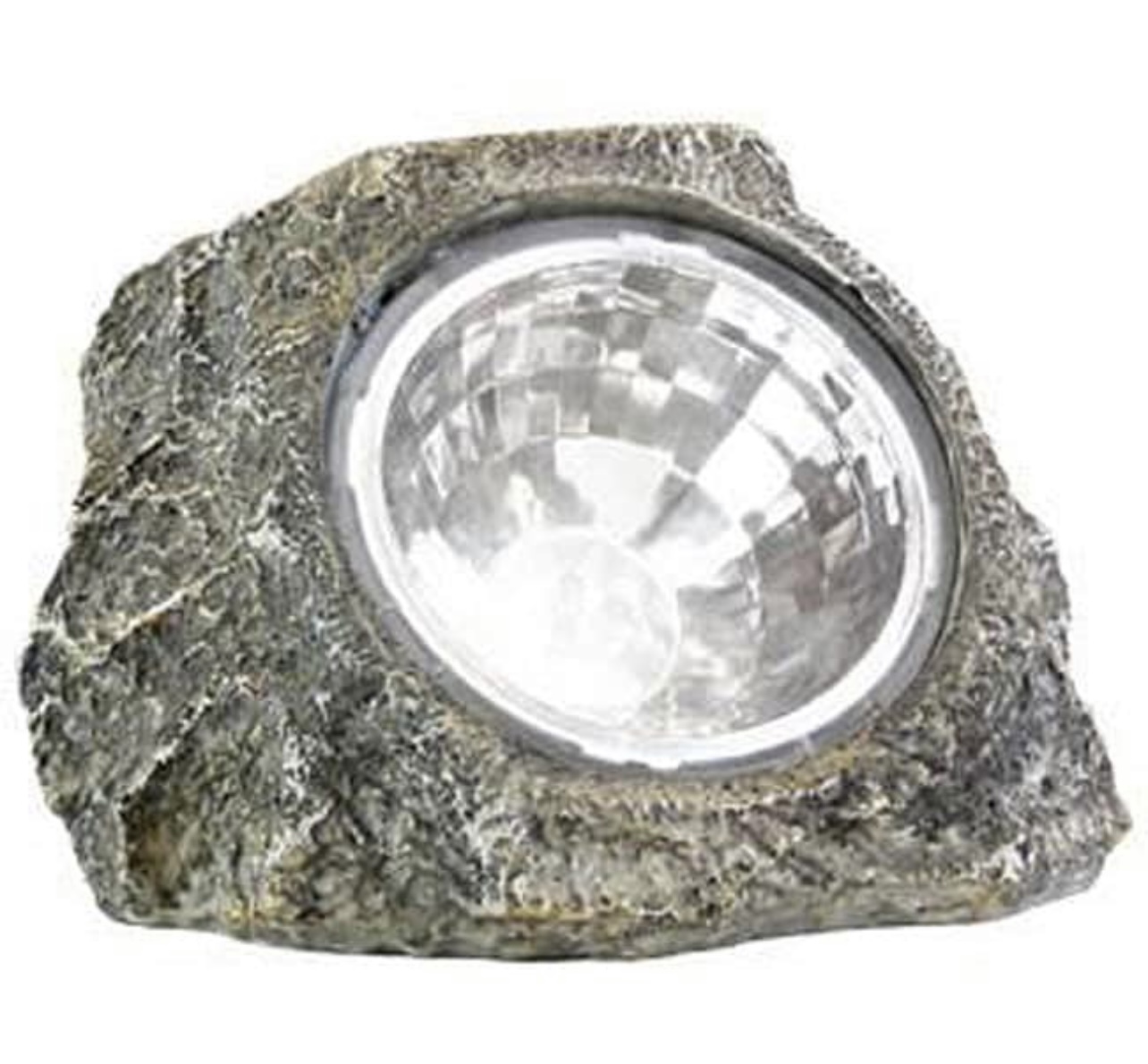

I'm in year 2 with a pair of these dudes from Home Depot. The battery stopped charging after a few months so I just replace them as need be.
They throw light about 20 feet for about 6 hours with new batteries.

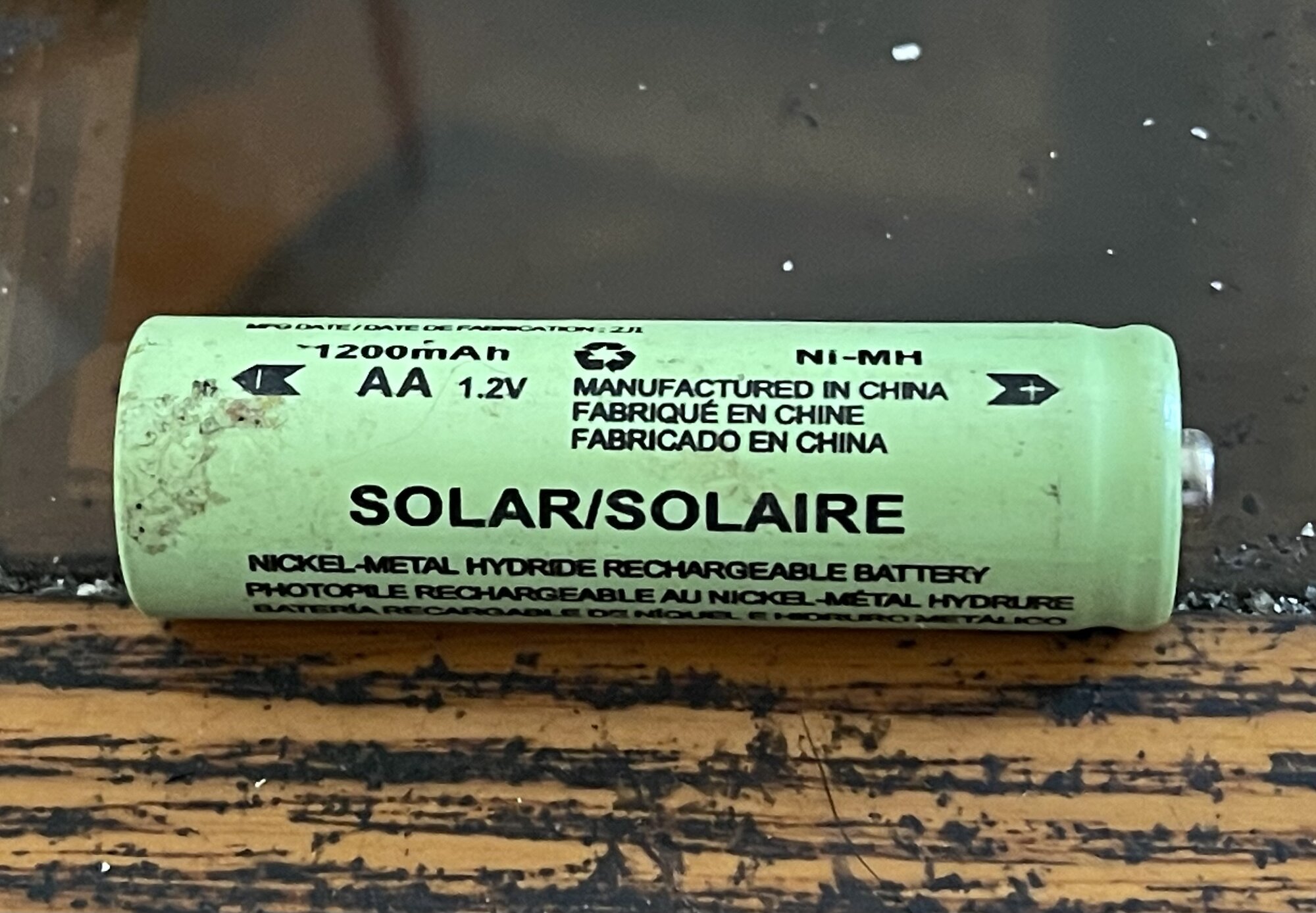

What size batteries those rock lights take? I guess just recharging and replacing batteries is a good idea, as long as you don’t have 100 of them
The solar rock lights have been around for a while, have a few small ones which are still holding up, but light output is limited. What type of cells in yours? One of mine uses 1/3AAA 200mAh.
