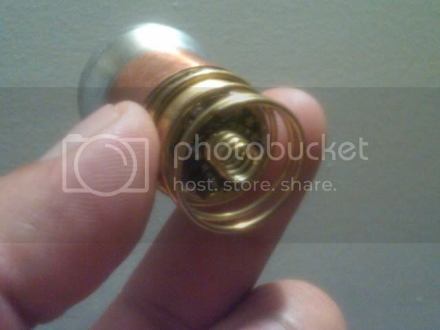

A couple of you guys suggested "using a spring?" Where exactly do I put the spring...does anyone have a pics showing how? Thanks.
Check out the pictures on the solarforce sales site. Or sbflashlights. The spring sits around the base of the drop in
Sent from my iPhone using Tapatalk

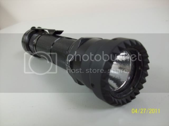

ash211 here is the photo of the spring on one of my Nailbender XML drop-ins I have on my Solarforce L2m. The copper band you see is the copper tape used by many of us to make contact with the body and help in transfering heat away to the flashlight body. If you dont have one PM me your address and I send you one that I have extra. And yeah there is nothing wrong with Solarforce flashlights they are great hosts the L2T is awesome, and thats coming from a Surefire Fanboy.
Here is my Solarforce L2m with a Solarforce cell extender, Clipped Delrin Shrouded Surefire Z59, Z44 head with GG&G Tactical Impact Device rocking a Nailbender XM-L 4500K tint.
