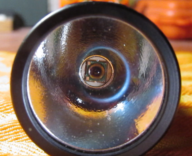

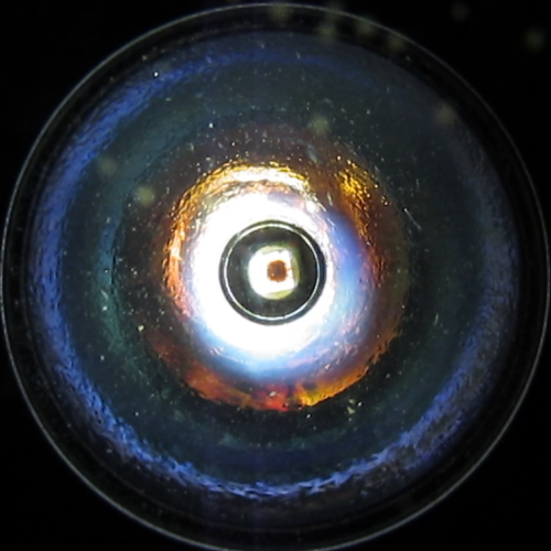

Been looking at upgrading my Surefire Fury (the 500 lumens version) to the duel fuel 1,500, so I had a browse on youtube. There seems to have been issue with LED burnout with some folks sending it back several times. Cant work out whether this is the 'intellibeam' version, the standard version or both. or is there a problem at all? Anybody here had any issues?

Old Fury also burn out, but much less often. Sent it for repair, they replaced the LED, it works without problems. Launched it to 16650, it works very well at full brightness, tried it on an unprotected battery - it can discharge it below 3 volts, but this is easy to recognize - when the battery is close to 3 V, it does not turn on the weak mode, but constantly turns on the strong one. But this should be checked on several more copies of the flashlights

I sent 3x Fury DFTs back for burnt out LEDs, the longest one lasted was 4 months, the shortest was 1 week. In the end I told them to send me the EDC2-DFT instead which I haven't had any issues with.

I have a non intellibeam Fury where the LED blew out. I will be sending it in for repair this coming week. Burnt out emitters in lights that easily cost $200 is unacceptable.
I hear ya. Burned out LEDs is not something I recall reading about too often with decent flashlights (during the years we've been reading here). This failure rate seems rather high, just seat of the pants. Someone must have made a rather fundamental design error, which was then obviously compounded by failing to catch it in 'test'. Definitely not befitting of their fine reputation. I'm sure a lesson's been learned, and hope they avoid such things going forward. Hope they fix yours up for you.
Got a soft spot for Surefire and I like to buy USA, but I'll pass on the Fury this time.
The 500 lumen Furies are still outstanding. It just bugs me that this $200 LED light burnt out the emitter without hard use. I have 4 Furies. One is bad but the other 3 are spot on. I like the long 3 cell version the most. I sure hope SF fixes my light and does not give me a "there is nothing we can do" answer. Will find out soon enough.
