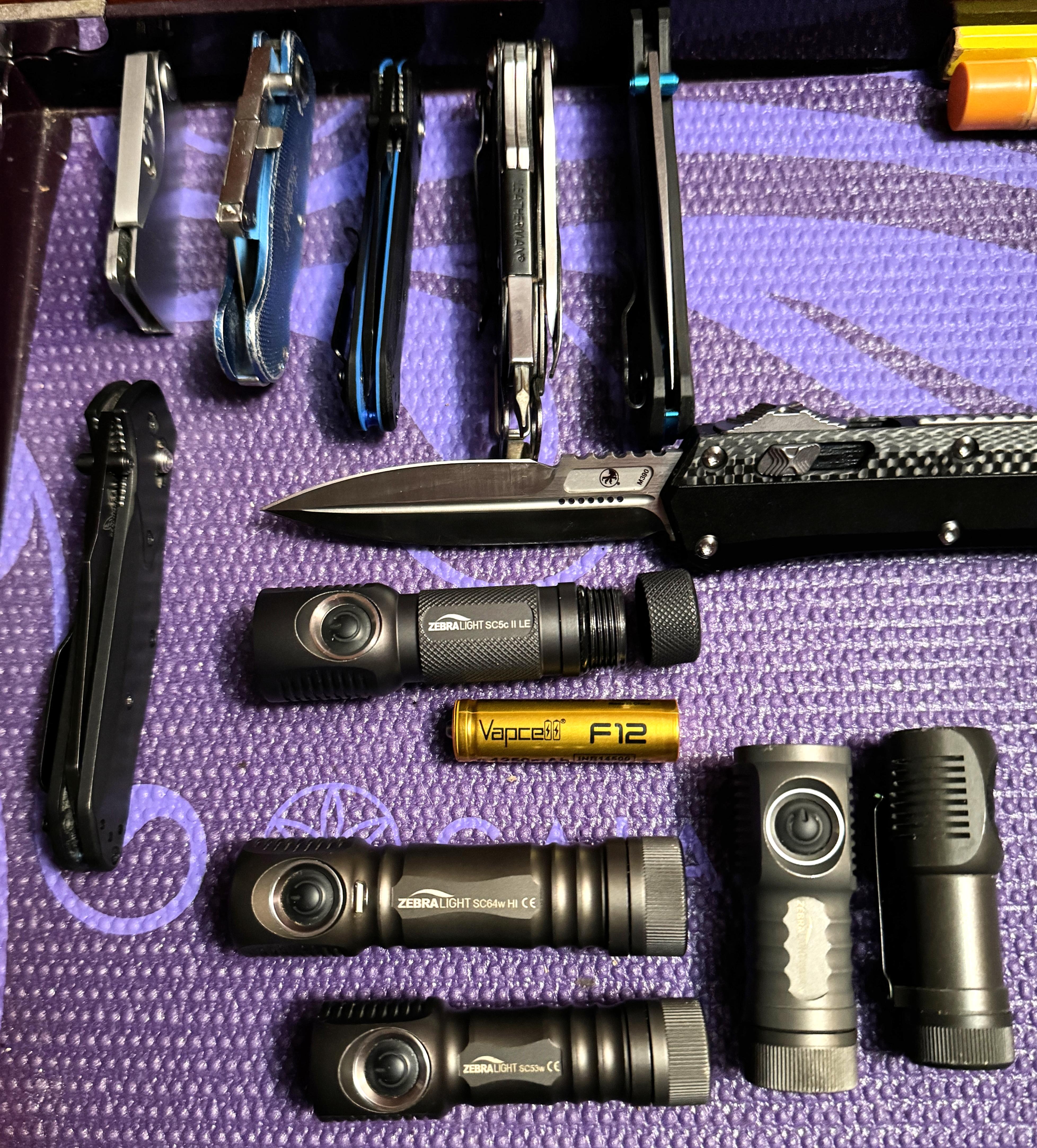

Have the SC5c II LE and run a Lith-Ion 3.7v Vapcell F12 button top with no problems for years...
I think all will run Lith Ion except the last batch-run of the SC53 and the new SC54...
