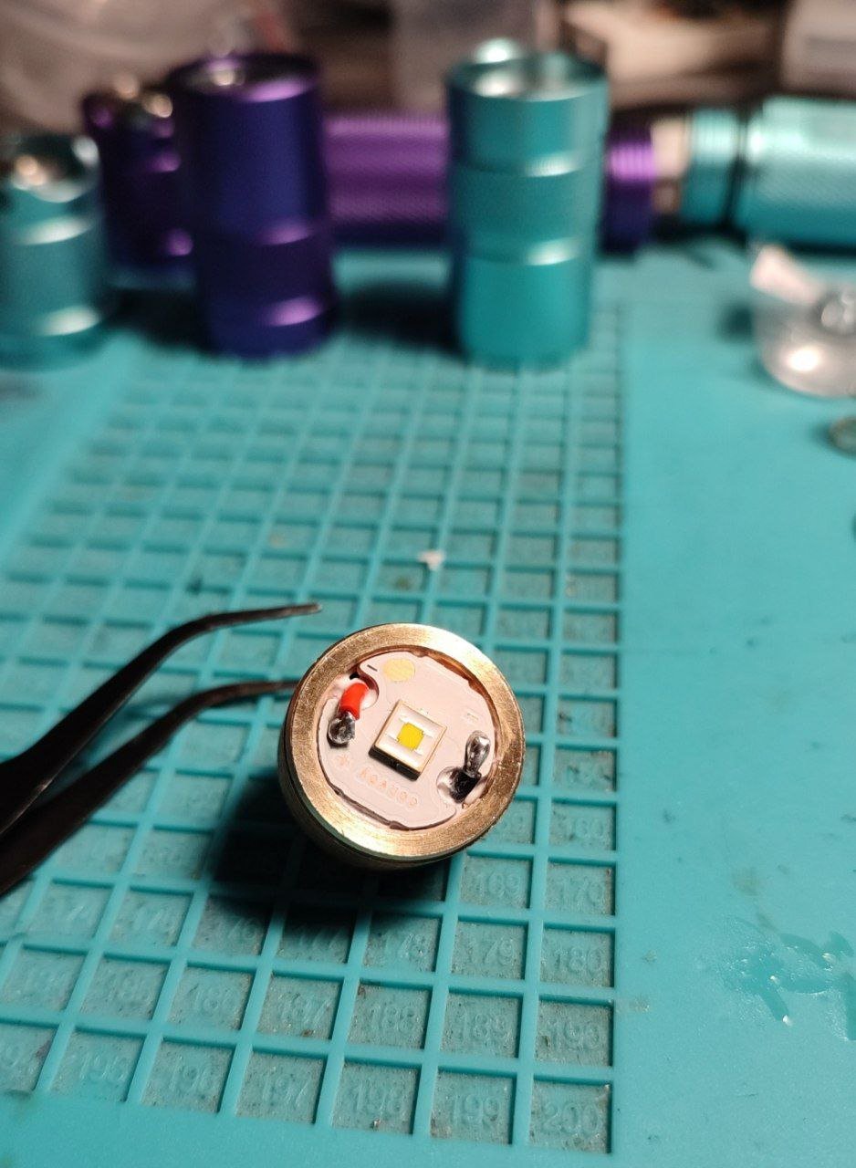

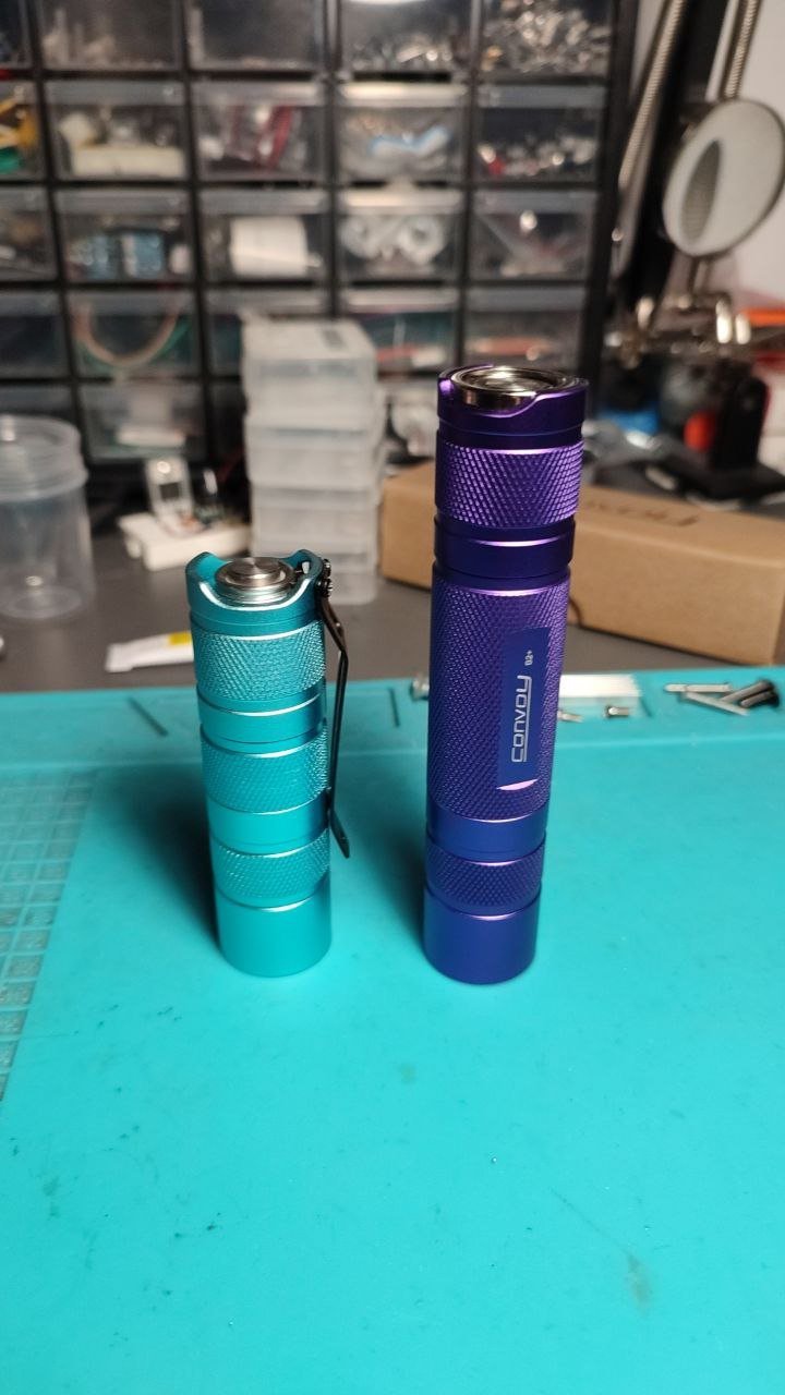

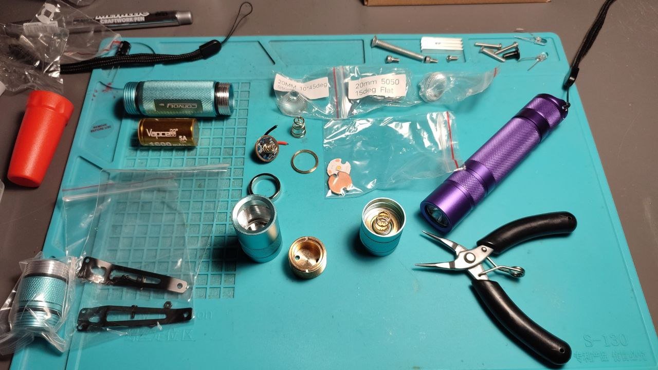

Last day some parts arrived and was time to upgrade my little Purple Convoy S2+ and mount a smaller 18350 Blue Convoy S2+.
In the Purple, I changed the standar driver for a 8A buck driver, and the SST40 for a SFT40 with a 15º flat TIR reflector.
The blue one has the short tube for the 18350 battery, the original driver from the other Convoy S2+ and a Nichia 519A with a 60º bead TIR reflector.
I also added a clip to the blue and a magnet to the purple.
Greetings.

I've made some testing with a luminance meter, and here are the results.
I measured luxes (lx) at 29cm, with 5 modes (100%, 35%, 10%, 1% & 0.1%) and convert to Candela (cd).
For the first mode, the light ramp down with temperature, so I made 2 measurements, second one at about 30" from start. The other 4 modes are stables.
Candelas are rounded to integers.
Nichia 519A + vapcell H16 + 60º Bead TIRLuminus SFT40 + 5A cdr 18650 + 15º flat TIR
ModeLuxes at 29cm (lx)Candela (cd)Luxes at 29cm (lx)Candela (cd)
100%45000-400003785-3364290000-20000024389-16820
35%21000176612700010680
10%7500631460003867
1%680575200437
0.1%Lower than ambientX1690142
I'll test again the SFT40 when I'll get a 8A cdr battery.
Greetings.
