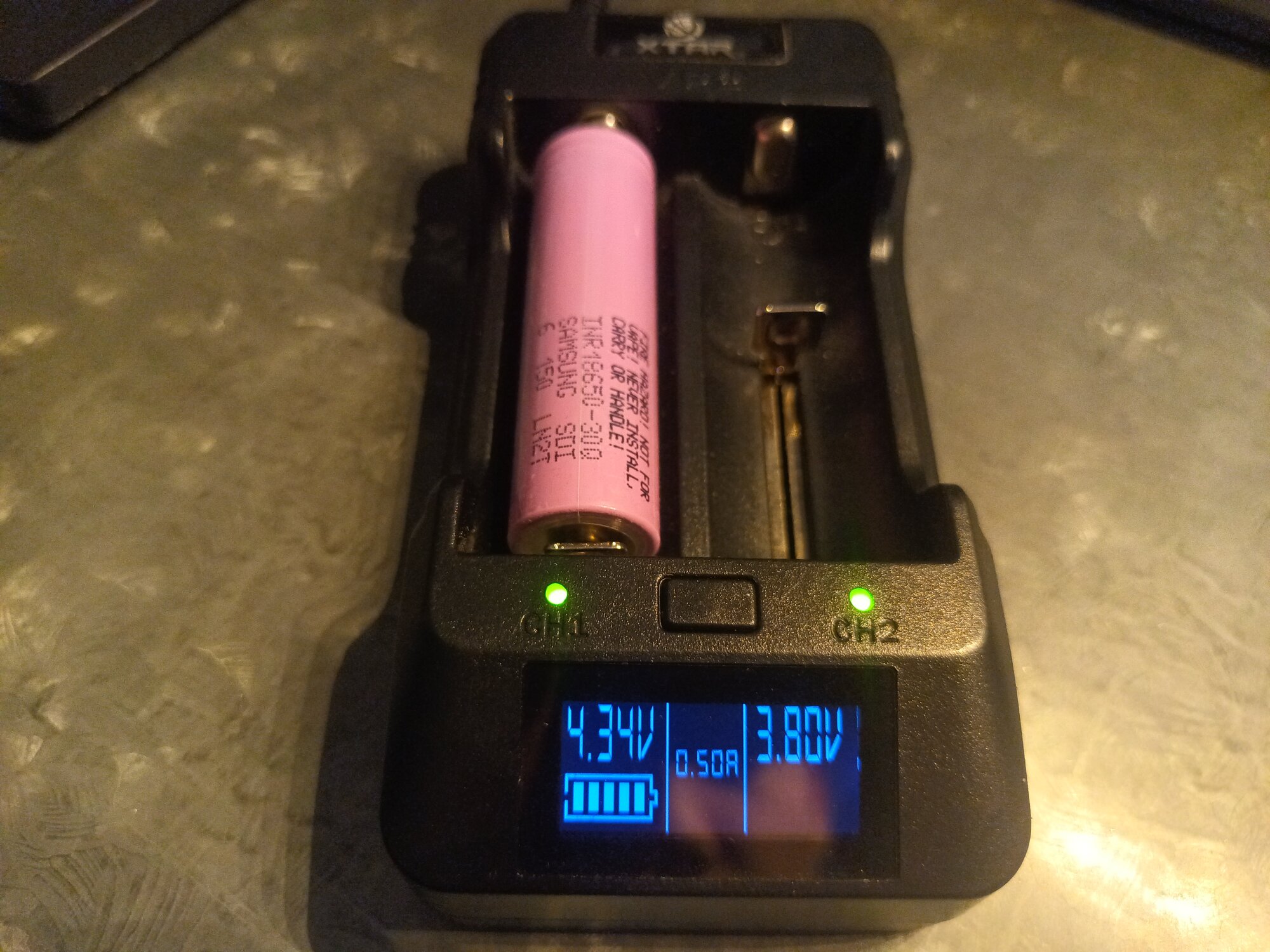

I recently noticed my charger is overcharging cells.
It has done 2 so far. I panicked with the first one a few weeks ago, and quickly lowered the voltage using turbo on my light. Not sure what to do with the current battery.
I bought the charger this fall, and have taken good care of it, what should I do? Is there a way to "reset" it? I don't have the funds to replace it anytime soon.
Thanks guys,
mark
Hmm, figured out there's a switch on the back for 3.2, 3.6, and 3.8 volts, so I did some research. I had it set on 3.8v, not knowing the difference and that would charge the cells to 4.35v. I'm sorry to waste your time.

You're welcome. I guess I should clarify too: This 'issue' is a defect in design or manufacture, and the charger should not do this, regardless of how long the cells are left in the charger following termination. In most cases, such chargers will actually likely draw a very small amount of current from cells left in a charger following charge cycle termination, if anything. In this specific case however, as the cell's voltage settles to some threshold, it will begin very slowly charging the cell, as if to 'top it off', which should not occur, and to make matters worse it will ultimately charge it to ~4.2V then, not the correct 3.6V it initially charged them to. To make matters even worse, the display will not reflect this, but instead remains showing 3.6V from the initial termination. It can be measured / verified with a voltmeter though. It's a little twisted.
That said, the scenario requires both that defect, combined with bad practice to ever occur. The user reporting it had left the cells in the charger for many hours (until some time the following day), and it takes several hours (I forget exactly how many) for it to become an issue at all.
I continue to use the VP2s I have, including for LFPs, as they're otherwise good chargers for what they do. it's effectively a non-issue for me, I just wanted to mention it, because if one charges LFPs and just forgets about them / leaves them in the charger, it will happen. Unless someone does something silly, it's a non-issue in practice. I'll call it a defect with a 'workaround' - common sense;-)
That switch is a muddle. I still use my Xtar VP2, and I was grateful to be reminded of the switch.
I'm one of the people this LFP overcharging happened to. In my case, I left two 16340 LFP cells in the VP2, set to 3.2 V, and forgot them for a week. Normally this should be no problem. Even if the cell voltage drops over time and the charger tops it off within a week, that's not ideal but is no problem. However, at least some VP2 copies will just keep going, not stopping at the usual 3.6~3.65V. In my case the cells were at a whopping 4.49 and 4.57V 😳 Somewhere in there the charger channel for the higher V one reverted to showing the nominal cell voltage, I believe this must happen at 4.50 V or slightly above, and the lower cell hadn't quite reached it yet. The 4.49V one was still showing the (also erroneous) 3.6V normal termination voltage.
