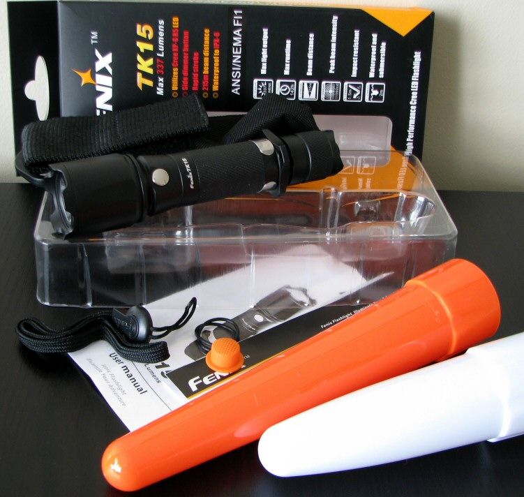

Packaging and extras are fairly typical for Fenix. Included with the light are a basic carrying pouch, basic wrist strap, spare o-rings and boot cover, manual, and warranty card. My sample came with the white and orange diffuser covers, but I don't know if that is standard or not.

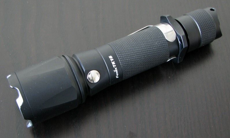

Fit and finish are very good on my sample. No flaws in the matte black type-III hard anodizing. Knurling on the body and tailcap is about average in aggressiveness. Identification labels are clear and bright.

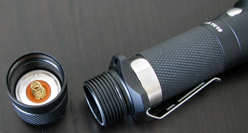

Screw threads are anodized for tailcap lock-out. :thumbsup: Screw threads seem to be high quality, with a square-cut at both the head and tail regions. Note the tailcap is interchangeable with my TK12 sample.
The grip ring is removable, but you have to take off the tail o-ring first. The clip is similar to other Fenix lights, but seems to lack the titanium coating send on my TK12 and recent LDx0/PDx0 series lights.

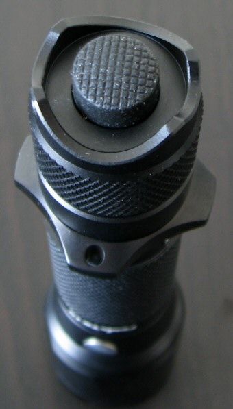

Due to the protruding forward clicky, the light cannot tailstand in stock form. But given that the tailcap sides are built-up slightly, you should be able adjust to the switch to potentially allow tailstanding. (e.g. add a washer underneath).
Note the body walls are fairly thick on the TK15, in keeping with its "Tank" family status. I imagine you could probably drive over this light with your car without much damage to the body. :rolleyes:
New from the TK12, there is a spring on the positive contact in the head of the TK15. Although you should be able to use high capacity flat-top 18650 cells, I found this variable on my sample (i.e. AW protected 2600mAh work, but not my Redilast 2600mAh or 2900mAh). This is different from my TK12 (with its slightly raised center contact disc in head) - it could take all my flat-top cells.
Switch is a forward clicky, with a slightly longer than typical traverse. No change from the TK12.

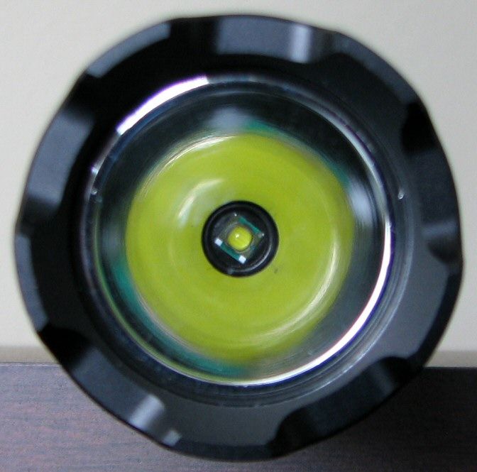

Like the TK12, the new TK15 also uses the Cree XP-G R5 Cool White emitter. The smooth reflector looks to be identical to the TK12 model.
Unlike some of the competition, the heads of the TK12/TK15 appear to be sealed. This means that reflector, bezel, etc is not user swappable. :shrug:

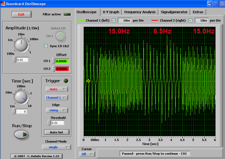

Strobe
This is new - strobe is an oscillating strobe on the TK15. You get ~2 secs of 6.5Hz, followed by ~2 secs of 15.0Hz, in a repeating loop. I presume the idea is that it would hard to steel yourself against a rotating strobe. :green:

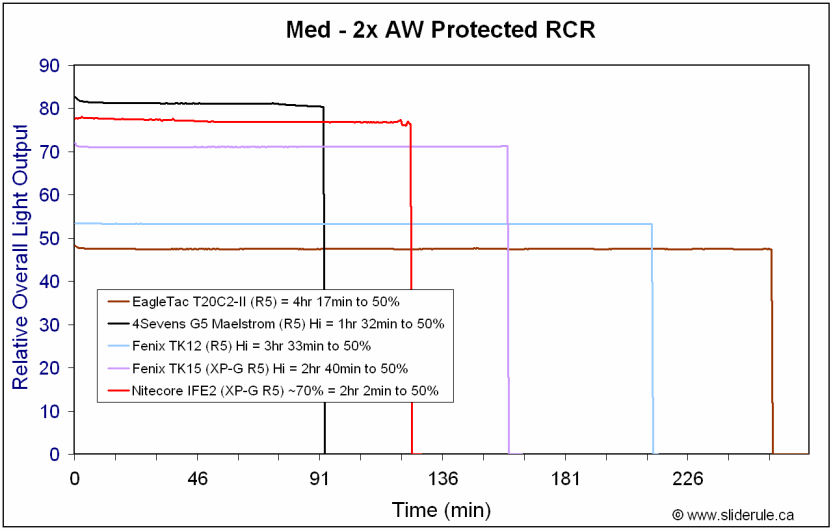

Output/Runtime Comparison:
Note the specifications claim that RCR is not supported. However, I tested 2xRCR on the Hi and Turbo levels, without apparent ill effect. :shrug: However, keep in mind the specs do not support this configuration.
As always, Fenix efficiency remains top of class for its output levels. I note that the performance on Turbo on 1x18650 is almost an exact match for the first ArmyTek Predator on SEMI regulation.

On my sample, there is a slight indication of the well-known XP-G dark-centre effect in the hotspot (i.e. a faint donut pattern to the hotspot). This is not uncommon on XP-G lights, especially those with smooth reflectors.
