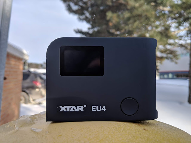

[h=2]Build[/h]The charger is constructed entirely from dark grey soft-touch plastic. The front of the charger contains the button, and the back-lit LCD display. The brand and product names are also screened onto the device here.

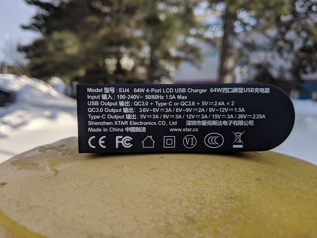

The bottom of the charger is filled with labeling. This includes the input and output specs, as well as all the regulatory labels.

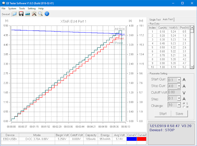

[h=3]USB-A QC 3.0 (Port 1)[/h]The top USB-A port is always active, as indicated by the "USB 1" label at the top left of the display.
With standard use, this port delivered up to 3.6 A before the over-current protection kicked in. The voltage was extremely stable, barely dropping at all as the current draw was increased.
Triggering QC 3.0, we can see that the charger has no problem delivering up to 1.5 A at 12 V, either. The power delivery dropped off after 1.5 A, but I believe that may be due to my tester trying not to cook itself. Once again, voltage was very stable throughout the test.
Even during this test, delivering over 18 W, the charger didn't get warm to the touch.

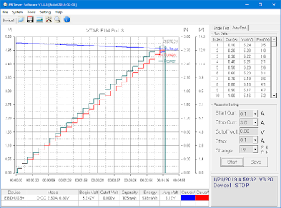

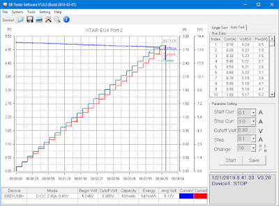

[h=3]USB-A 2.4 A (Ports 2 & 3)[/h]Ports 2 and 3 are active by default. Even if the charger is switched to USB-C mode, these two ports will reactivate when the device in the USB-C port has completed charging. When these are active, "USB 2/3" is shown in the center of the top of the display.
Testing these two ports showed nearly identical performance, as expected. Over-current protection kicked in at 2.75 and 2.70 A respectively, with both ports maintaining good voltage throughout the test. Port 3 showed the voltage dropping down to about 4.8 V right before terminating the charge, but this shouldn't damage any connected devices.
