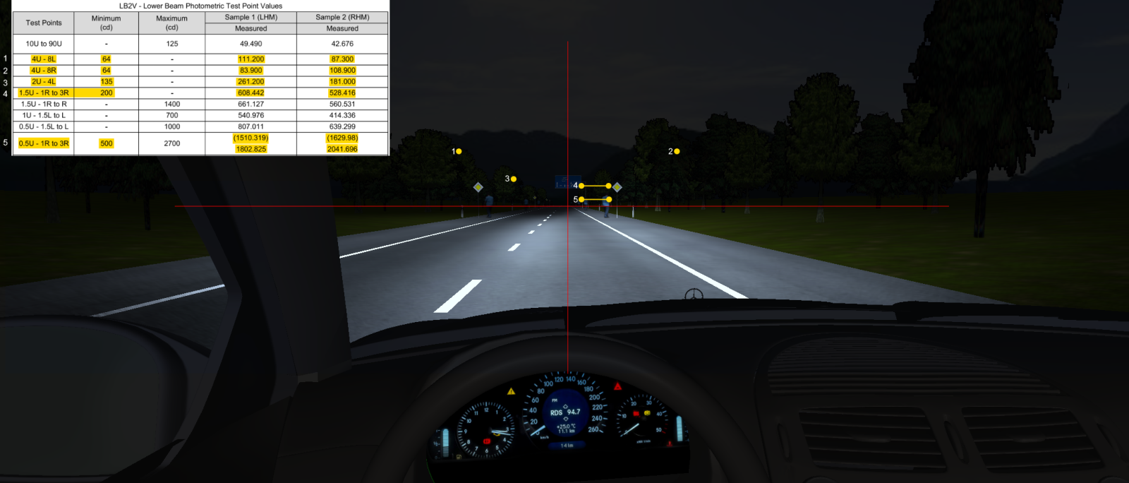

The Sierra XB LED headlamps do have sufficient uplight according to the photometry test conducted by the manufacturer, Coplus.
I plotted the FMVSS 108 uplight test points in this image to show their angles from the drivers perspective. The data table in the corner is from the report.
