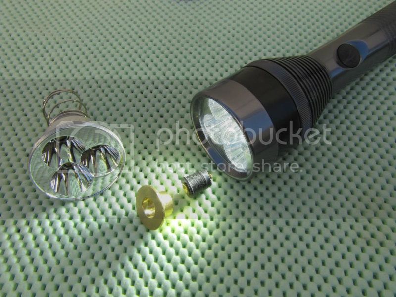

Install black extension ring between head and bezel
IMG_0482_zpsb4324cf6.jpg~
Install black positive connector instead of bulb and tighten it with brass negative connector
2C M*g using 2 protected 18650

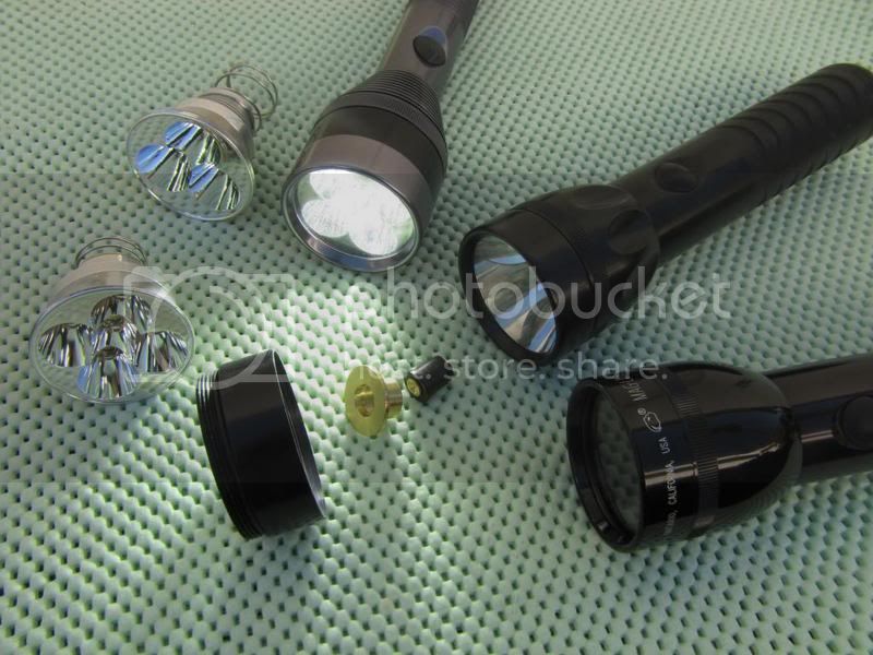

Here I have limited quantity of simple 3 XML drop in for all incand M*g "C" and M*g "D" (Will not work with M*gCharger)
No soldering needed, no skill needed and 100% reversible. Installation will take only few minutes.
Simply remove bezel, reflector and bulb of your incand M*g then install black plastic instead of bulb, tighten it by provided brass nut.
Then install black extension ring on top of head, install 3XML module with original bezel.
Head extension is made of 6061 aluminum with hard black anodized type III and will increase length of head about 18mm (no other color available)
Replacing the lens is not necessary but optional.
Please make sure total forwarded voltage to 3XML module is no greater than spec.
8.4 volt version will work in 6C or 6D (6 NiMH), 2C (2x18650) and 2D (2x18650 or 6AA), 2.5D (2x32700) and many other configurations.
12.6 volt version will work in 3C (3x18500), 1.25D (3x17670), 3D (3x18650 or 9AA), 3.5D (3x32700) and many other configurations.
Obviously, 12.6 volt version is brighter than 8.4 volt version but either one will outperform many other conversion kit.
You can also use many other type of modules such as
single P7, single XML, 5 Cree, 6 Cree, 3XML (2 cell), 3XML(3 cell) and ....
If you already have your own module, then you will need kit only without module.
What you will get in a kit includes: 3XML module, black HA head extension with oring, black plastic positive contact and brass negative contact.
Please make sure positive of batteries toward front of flashlight and negative towards the tail cap.
Warning: Reverse polarity will damage, burn and fry the module.
