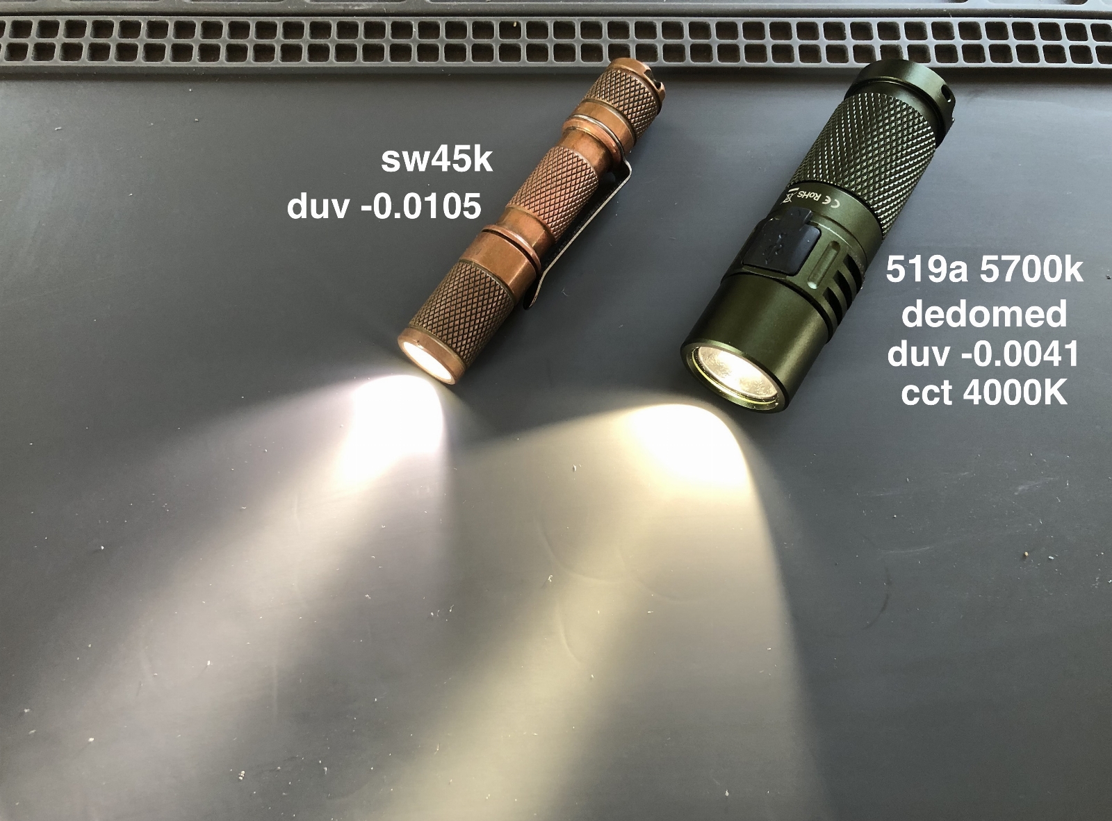

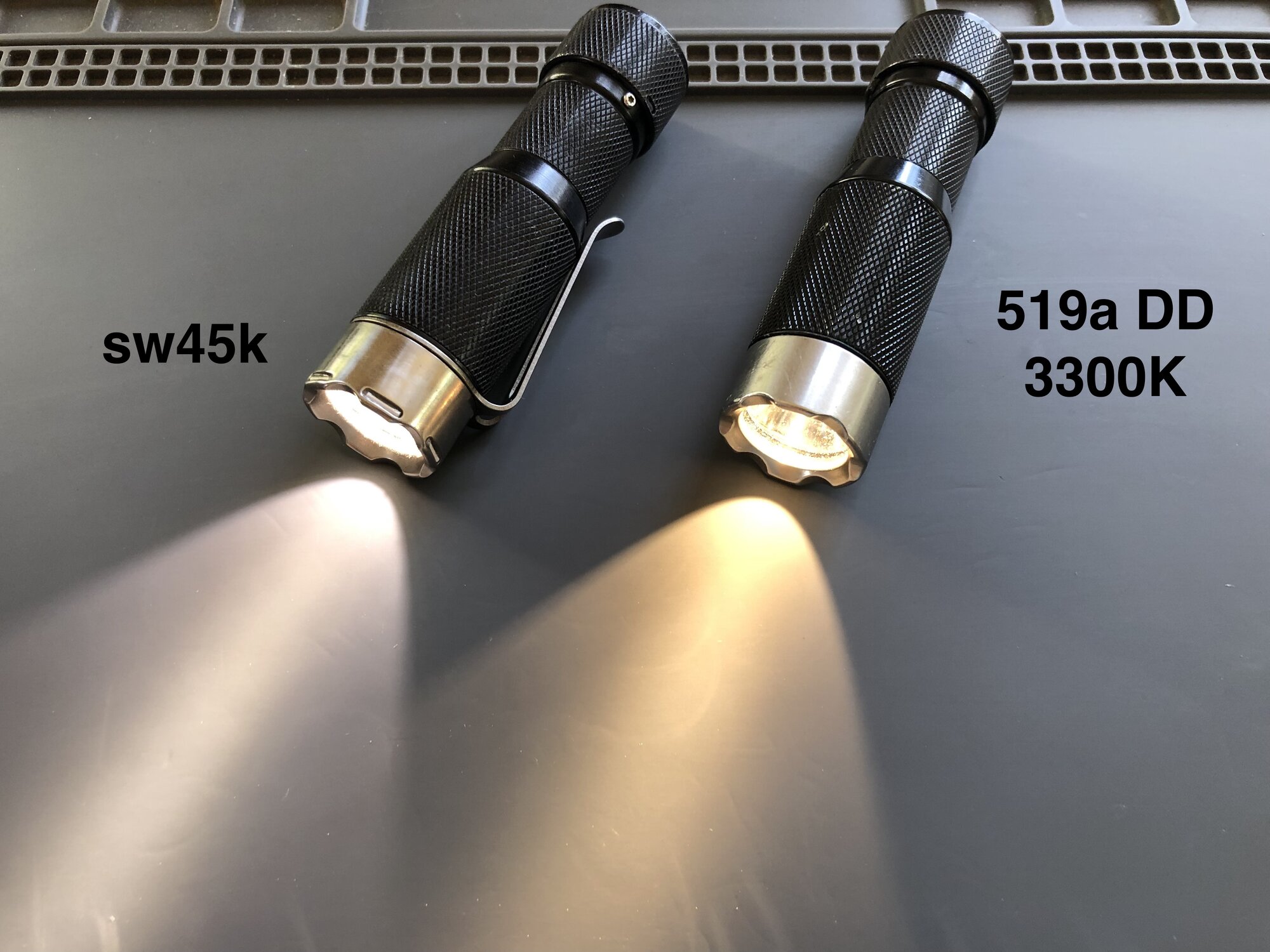

closest to 4000K atm, would be to dedome the 519a they offer. It would end up at about 4000K and look something like this (when compared to sw45k, which is still available in a more subtle degree of pink tint than pictured):
How would the beam look like, compared to the 219b? I thought about doing that, but I’m afraid it’ll be too throwy.
Tint will be nice, beam will be more throwy. Also to note, Dedoming sometimes will cause artifacts in the hotspot, depending on reflector used some may be worse than others. As long as your not white wall hunting, you won't notice.
Also, Dedoming the LED will void the warranty. I would leave it alone.
glad you mention that dedoming creates artifacts in the hotspot, it is true

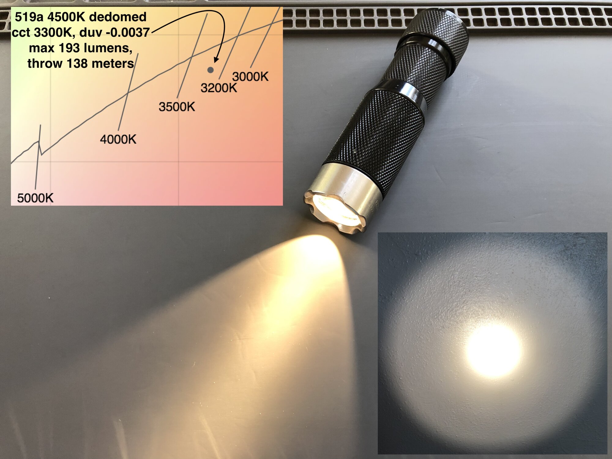

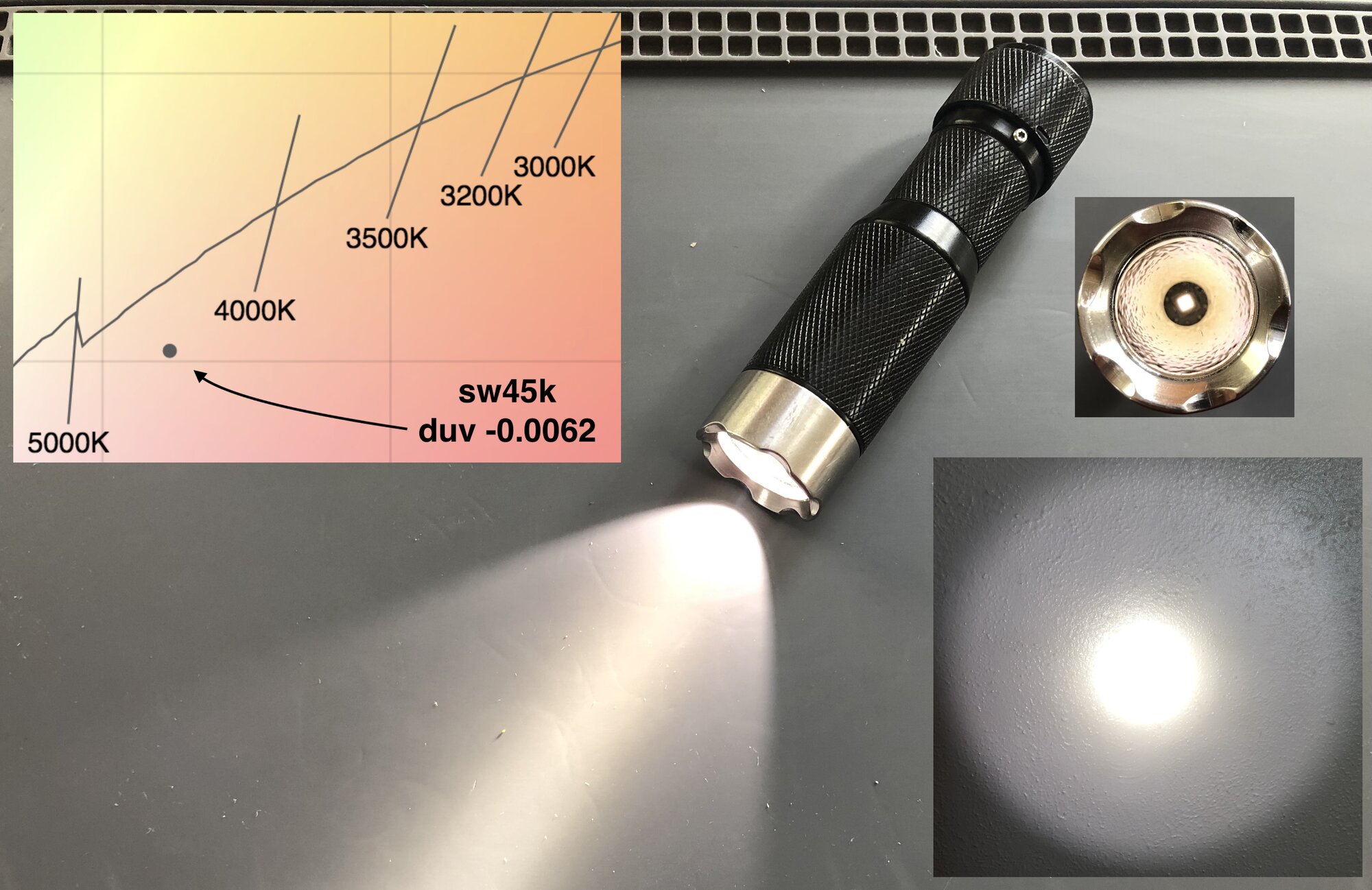

dedoming 519a loses the perfectly round hotspot perimeter. I can definitely tell the difference, although unable to capture it in these photos
219b installed by HDS:
DeDomed 519a, Not installed by HDS:
this LED was installed by a modder, the host was an older 140 model. I agree changing the LED on an HDS, voids driver warranty. Although the LED swap did not actually damage this driver, it IS possible to damage an HDS driver during a private LED swap.
Also agree dedoming an HDS installed LED, potentially voids LED warranty. Although in this case, the LED was not damaged by dedoming. The risk belongs to the person making the modification, dont expect HDS to fix it if you screw up or dont like the results.

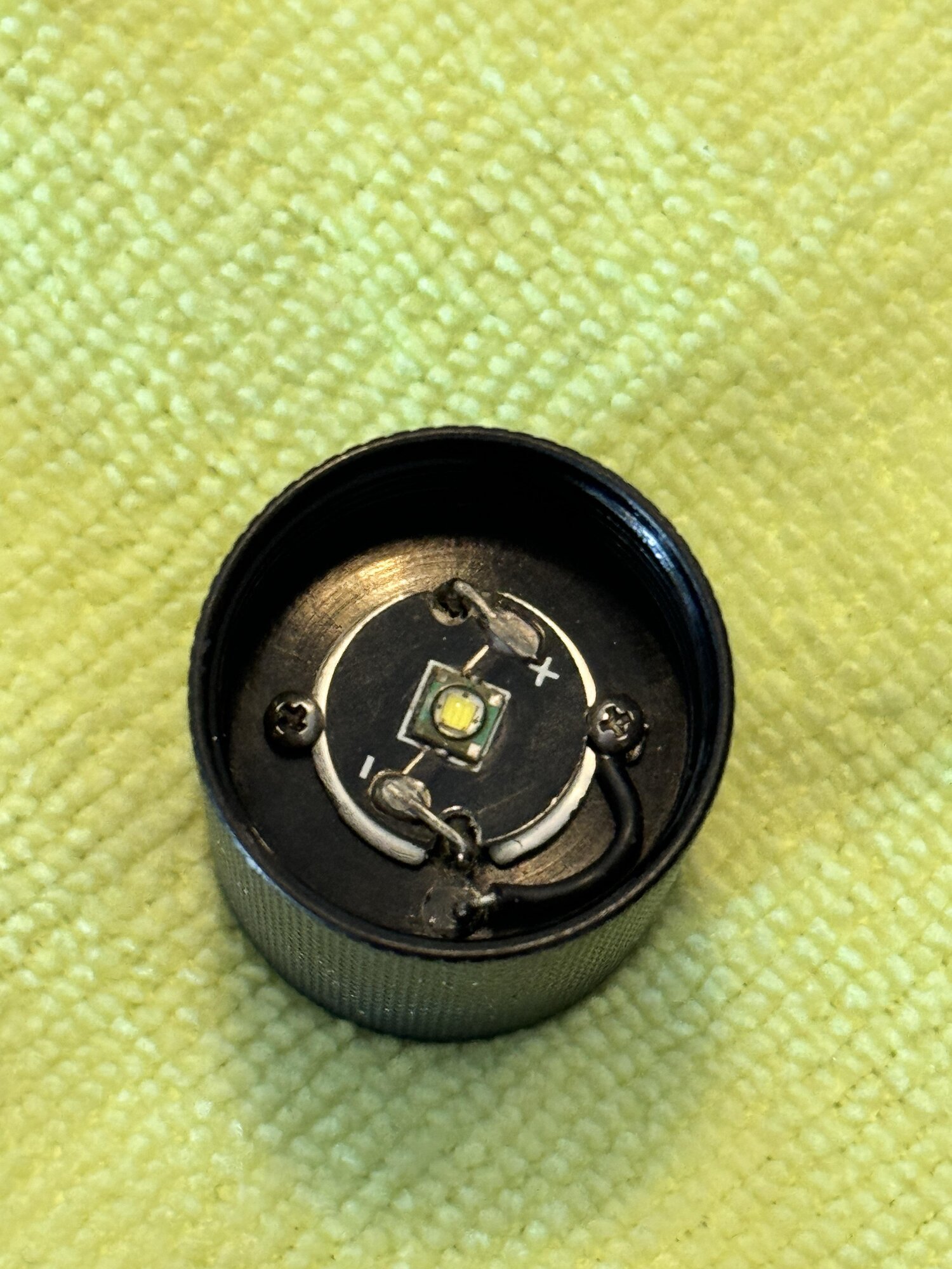

Asking the legacy HDS gurus for an ID on this Executive. Driver side has a green sticker, so I take it as a 120 lumen model. Any info on the emitter just by looking at the photo? Ideas on resale value for a fair condition Executive with this setup?

I believe that is an XP-G, and iirc HDS offered both a 6200K Low CRI and a 3200K High CRI. You can probably guess which one it is by looking at the color temperature of the beam.

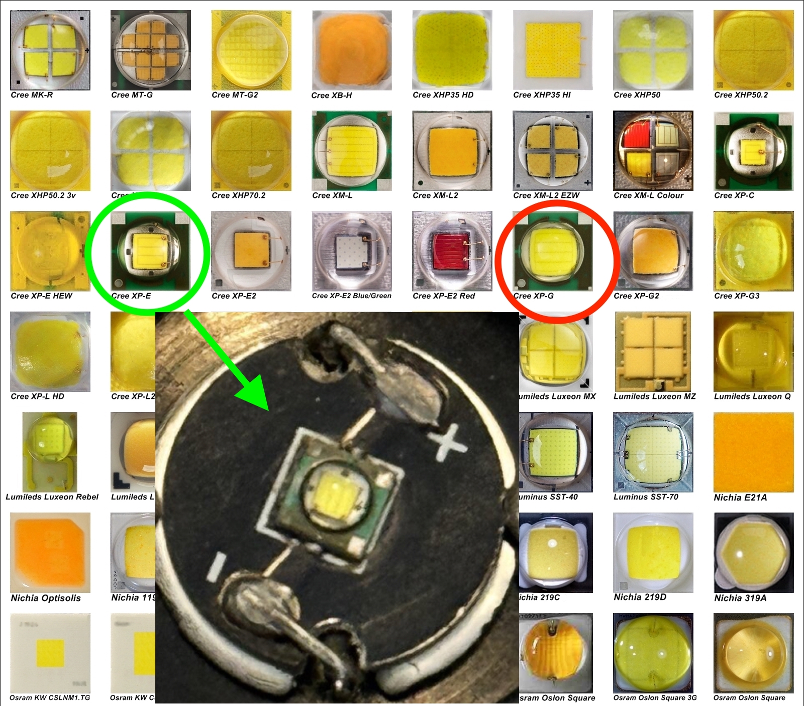

here is an ID chart for various LEDs, that includes a photo of the XP-G

That die looks too small to be an XP-G to my eye. I would have guessed an XP-E LED

Thank you for noticing that, I believe I was mistooken
In which case I believe the clicky in question may be worth less than TreeFiddy ;-)
Definitely an xp-e. Was this ever modded? I've never seen a stock HDS with a mcpcb like that. Milkyspit bored a clearance hole for a 10mm dia 2mm thick mcpcb board when he xp-e swapped my old 140n.
