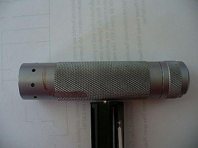

I'd always thought the Led Lenser Hokus Focus was a 3w LED Luxeon but I've read its only a 1.25w LED but quite surprisingly it still gives out more throw and stronger beam than my friends 3watt LED torch.
have that poor, expensive crap run for 10 mins, then compare brightness again (when its about half of the starting level)
I assume you mean the 7438 Led Lenser 3xAAA? I have one and it is really super bright. After a few mins the brightness goes down A LOT! When fresh it will JUST out throw my L2D Q5 which is imressive but the beam is very tight with no sidespill due to the frog-eye lens.
The quality is pretty poor for the price, ie bad seals so not waterproof, no regulation, overdriven LED etc.
I do love the switch, it feels very nice and is great quality, and the whole light feels great in the hand too!
Believe it or not these I saw these things in store (UK) for £50 late last year (thats $100 US/CA)! Unbelievable rip-off.

2 possibilities:I havent noticed any dimming after 10min of use, sometimes used mine for 30min straight,
I have used a LL V2 for over a year on work, I work nightshift, so far it works perfect, it even outthrows my P2D Q5 :twothumbs
I run mine on eneloops and usually charge them once a week, no problems so far..Ive read that using alkalines would result in a drop in brightness after few minutes.
I havent noticed any dimming after 10min of use, sometimes used mine for 30min straight, but I dont own a lightmeter, so I cant tell you for sure, I only use mine to see in darkness
The main reason it throws further is because of the optic. it focuses almost all of the light into the hotspot, so it will throw further then reflector light which allows a lot of the light to go into the spill.
Think laser pointer vs flashlight. The flashlight has more overall lumen, but the Laser has much more throw.

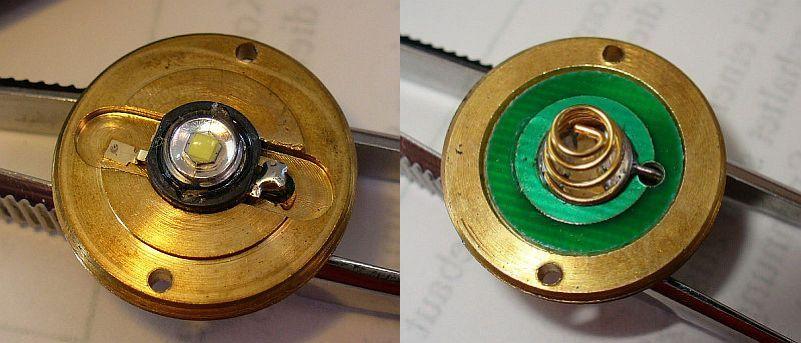

The Seoul is a mod, you'll have to do it yourself but it doesn't appear to be too hard. As long as you are decent at soldering and have thermal compound you should be able to do the mod.
