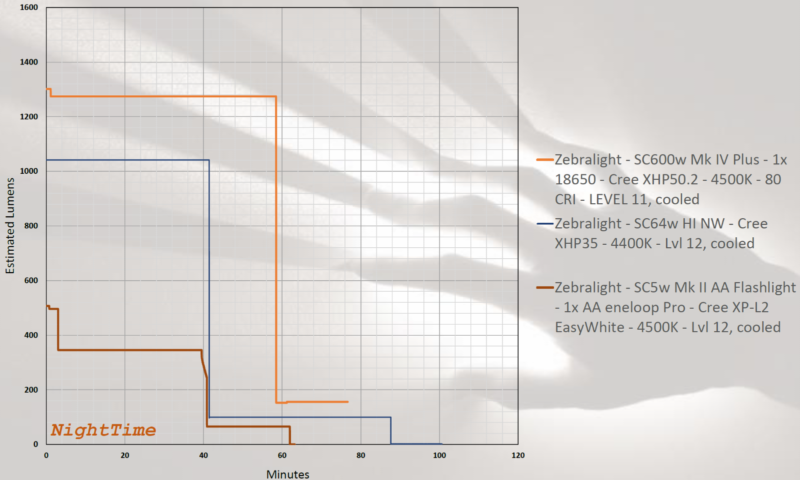

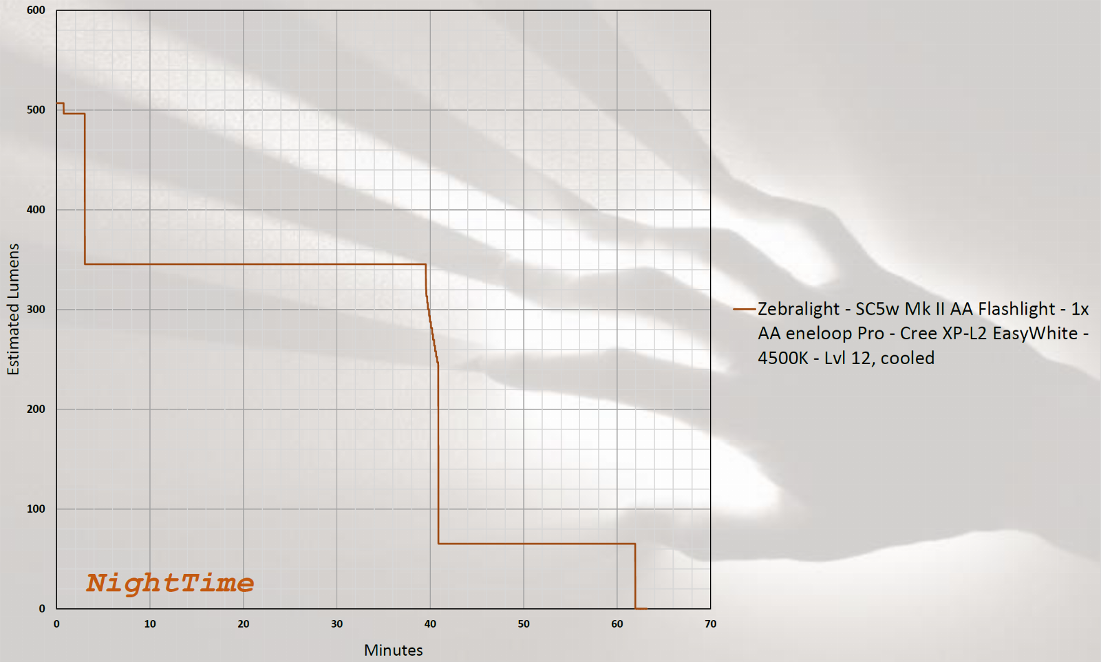

BTW, I have a SC5w Mk II AA NW (not the High CRI edition) at home. I did a runtime test for max level during holidays. Here is the result using an eneloop AA Pro:
The test was done under a cooling system.

If you need more runtime, then get the SC600w Mk IV Plus 18650 XHP50.2 Neutral White, which holds 1311Lm for 2 hours, and 358Lm for 4 hours. You may even get more with a high capacity cell like NCR18650GA 3500mAh or Vapcell M35 INR18650 3500mAh.
From what I've seen based on some other reviews, Zebralight claimed runtimes are based on ambient temperature. At these high levels, those relatively small flashlight are heating up. Then the PID (Zebra's thermal regulation tricks) kicks in, the output gets lower, and then you get more runtime. Personnaly, I rarely use the high levels for very long, so the PID don't really have the time to kick in. That's why I prefer to see "cooled" runtime test like Selbuilt was doing or Zeroair is now doing. This represents my needs. I don't know your needs though.
2x AA flashlight are quite big in a pocket. At this point, I also prefer to go with a 1x18650 flashlight. Actually, the only reason I carry a 1x18650 flashlight is because Zebralight exist. They make them small, powerfull, lightweight and efficient. The SC64w is amazingly small and lightweight (before adding the battery of course). But, if you can go a bit heavier/bigger, then get the SC600w. The extra mass, really makes a difference with the heat management. Depending on the variation you choose you can also have a very powerfull light. My SC600w (using a XHP50.2) is more efficent then my SC64w (using a XHP35):
The 18650 used was NCR18650GA@3500mAh. The AA was an eneloop Pro.
