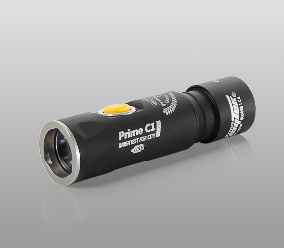

ArymTek Prime C1?
It has 3 firefly modes, 0.4, 2.5 and 6 lumens, and also the usual med and high modes, small, reliable.
