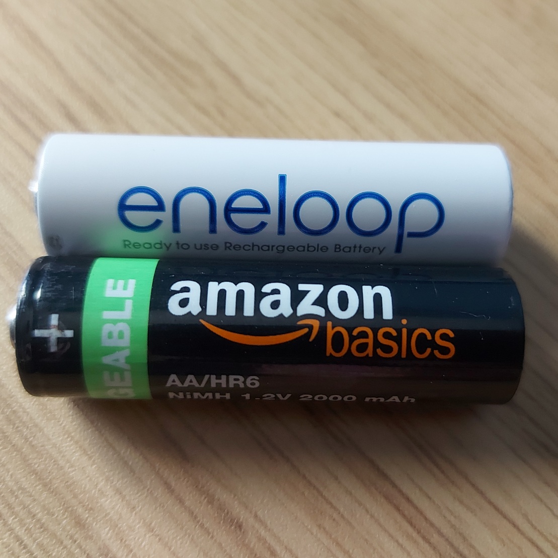

Hello. I have these Sanyo Eneloops AA and Amazon Basics AAs:
When I use them in coffee whisker I notice that with Amazon ones it turns slower than with using Sanyo batteries. Why is that?
After fully charged, Sanyo (1900mAh) give out 1.33v and 1.35v while Amazon (2000mAh) give out 1.2v and 1.25v but both have 1.2v NiMH on their label. Both were bought about 8 years ago.

I would say your Amazon batteries most likely have not aged well. Their ability to produce current is not as good under a load. The Eneloops have held up better with time.
I used them rarely so might have to do with not aging well too? The Amazon ones are made in China. Sanyo is made in Japan. Looks like it says all.
I thought to buy battery charger like LaCrosse or Powerex because they recondition batteries and can even bring back dying batteries to working state. Have been putting off amd using Camelion charger. Someone told me these typical chargers use simple algorithm which is not optimally adaptive to each battery and wears them out with time.
The made in china ones (Rayovac Hybrids) tend to charge to a lower voltage and be more fragile even though they have slightly more mah (2100 vs 1900 for eneloops) You need to be more careful with the chinese LSD cells as in series they are more easily damaged when overdischarging them causing sometimes a reversing of the voltage that can give you a loss of about half capacity sometimes.

I don't know if Amazon ones that I have are Rayovac Hybrids. I thought my charger is sub-par and worn them out. When you say overdischarging, you mean like in lithium batteries? When you day in series, you mean when there is more than 1 battery used in device?
often you use more than 1 in series and as they are drained one can be discharged completely leaving the other driving it reverse voltage thus damaging it. You can also discharge single sells way too low in some devices too (0v)
@Lynx_Arc and @Lou Minescence Do you know if Amazon ones in question can be reconditioned back to their normal working state with chargers like Lacrosse or MAHA?
I have a lacross and the chinese (hybrids) ones typically don't recover fully when they get damaged, the duraloops (japan) tend to recover a lot better but still can be damaged. The AAAs are more fragile than AAs even in the eneloop (japan) variety. Now if it is just loss of capacity from lack of use then it can often be recovered totally or at least mostly.
