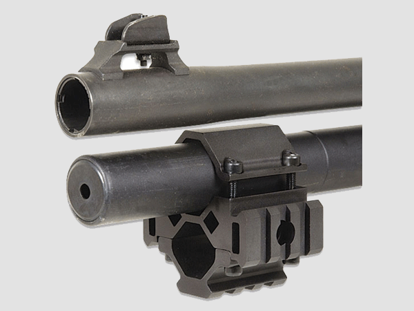

Cool, I plan on mounting on mossy 500. But i have been told the diameter of the tube make a mount that fits well hard to find. I am pretty well confined to Internet ordering where i live, so trial and error of well fitting mounts could be a tiring process. SO what mount did you find?

I put about 50 rounds of double aught and 20 rounds of slugs down range with the light. That does not mean it couldn't fail at number 51or 21. My TLR-1 has 235rounds through with it. It might fail at 236.
As for a mount, Brownells has the brand light mount technologies and they are a great light mount for shotguns. I have hundreds of rounds down range withis mount and it has never shifted ormovedunder recoil.
