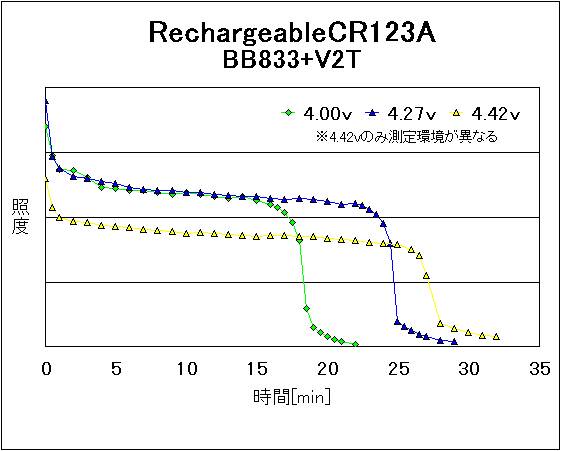

See this page for the runtime of the BB500/Luxeon V (WX1S)/1x123 combo. Even with this not-so-high-output BB and very-low-Vf Luxeon V, the single CR123 cannot provide enough power to keep regulated.

Just wondering how you got 30 minutes of runtime from a Lux-V BB833 running the new JSB123 when I only got 12 minutes from a Lux-V BB750? Where those the bare cells from earlier?

/ubbthreads/images/graemlins/awman.gif I was wrong.
Here is a link to the pictures of the run time
It turned off about nine minutes after the second picture. Took it out and the reading was negative. Let it sit for about ten minutes and it read 3.789 popped it back in and ran upto and past the last pictures time.
/ubbthreads/images/graemlins/oops.gifSorry I was off.
Please don't /ubbthreads/images/graemlins/twakfl.gif /ubbthreads/images/graemlins/twakfl.gif /ubbthreads/images/graemlins/whoopin.gif /ubbthreads/images/graemlins/whoopin.gif me.
I still think it is a great length of time for it to be running at full power.
mut
