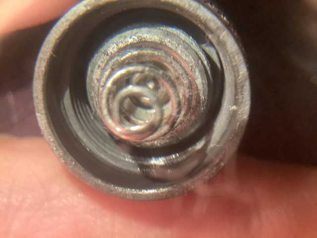

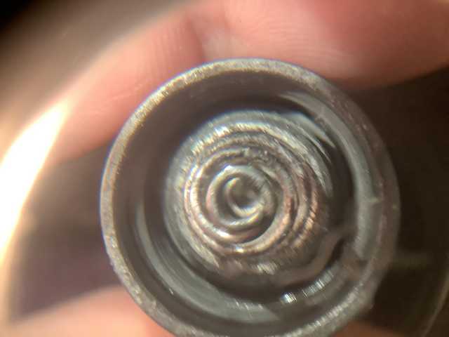

Anyway, I can see something like what Eric242 describes in a z68, but not in the z52 (which are embarassingly grody up close). Looks like there's a ring in there, but nothing pliers can grab, and it looks soft, rubbery.
Fasttech has silicon and rubber boot sets of 50 and 100 for $5 and $8, but I suspect they're too large: 17mm base and 15mm button width. My tape measure doesn't metric. I have seen other posts claiming the button is 13mm wide. Anyone have an E and a ruler with metric? Or happen to just know E boot dimensions? thanks again guys
Yeah I didn´t think about the older switches like the z52 and the black z54. These don´t have a retaining ring. But I think I see a hex screw in there which you should be able to unscrew and solve the problem from "the other (threaded) side". Since I have two E switches with shrouds it is rather easy so access the boot. I just measured the button with 13mm and the base with 19mm.
I can't quite tell from the picture but in the center of the spring, is that a a hex socket? You can pull the spring out and put it back in later ( I would give it a brush clean first). The soft ring is to prevent side contact of the negative switch (so the twisty can work properly). Otherwise, if it is rivetted, you can pull the negative contact out with a plier or punch through from the rubber boot side (given you are trying to swap out the rubber cap, this shouldn't be a problem).
