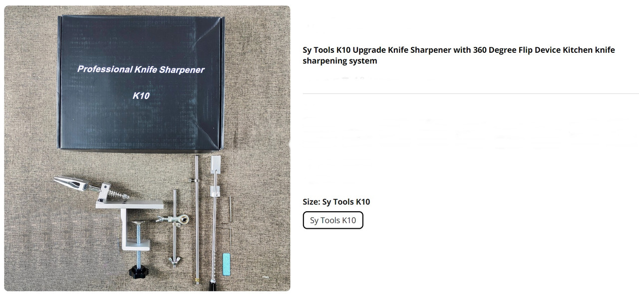

Just got my new Knife Sharpener System .
I already have loads of inserts , so I got me the base system .
A) I love the way it mounts to a table .. My other systems are really bad for mounting ( Clamping ) .. But this K10 is simply fantastic .
B) I like how well and solidly it holds the knife . A big bonus is how straight the system is as well for laying down accurate edges
C) It actually turned out to be very easy to use / set up / and sharpen a knife .
I will most likely have to do a video on just how easy it is to use .. But I only just got it ( last two hours ) and I sharpened a knife right away with it .
So right now ? = Nothing to complain about .
Took a while , = Bad weather ! ( Hot N Humid )
SyTools K10 guided system .

Anyway , I like the k10 sharpener .
The split knife holder / forks / grips are nice because each fork self aligns . This makes for a better grip and better stability for the knife in the sharpener . Most sharpeners with a large single tine / fork / grip have issue with alignment , especially if you have a funky blade with odd angles .. ( Looks good , but is bad for stuff like guided / clamped systems )
