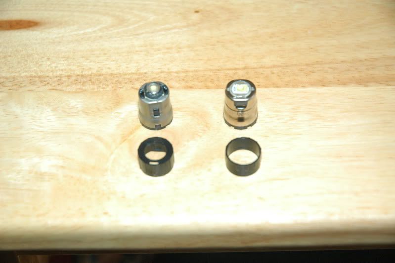

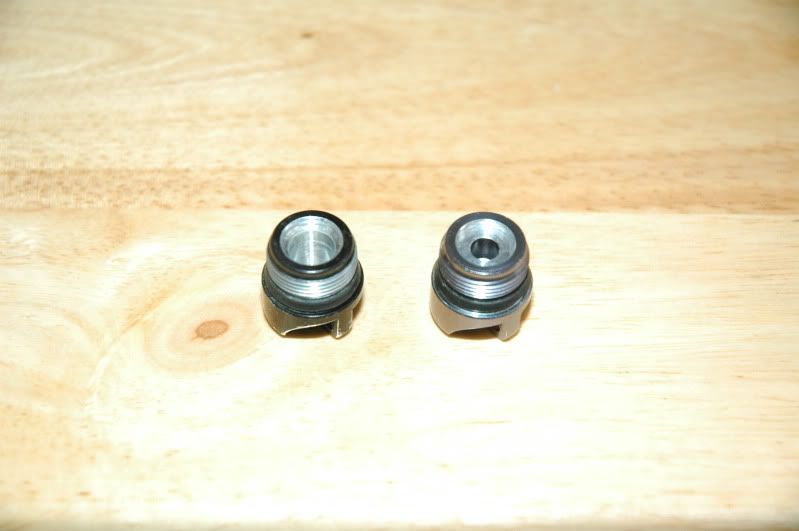

    I'm just swapping the module assemblies. The 2D lights have a spacer that slides into the switch, the Led module sits inside of the spacer. Once you take the pill/module out of the 2D spacer, the modules are identical.... a direct drop in. The module is held into the AA by a black plastic ring.
    2D single-mode 090 on left. 2AA multi-mode 090 on Right.
    AA mini maglite with emitter installed.
    2D switch with bulb installed on left, AA bulb/module with retaining ring installed on right.

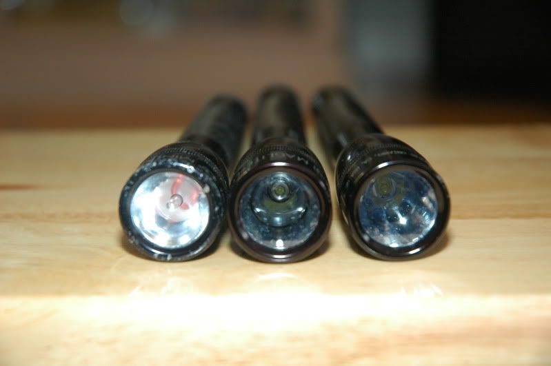

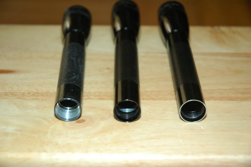

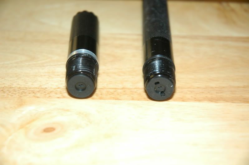

    I climbed into my 24 degree vehicle this morning and the eneloop fed ML25 lit up just fine.
    It has a tailcap with a wrist strap attached.
    It's polished silver
    A pair of holes at right angles.
    The holes did not penetrate to inside the tailcap.
    Basically I had a broken ML25 so I measured 1/8" down the shoulder and drilled a hole 1/8" deep with a 1/8" bit. Then on the flat end I measured 1/8" away from the edge and again drilled a hole 1/8" deep. That met the hole at a 90 angle. Then I inserted the wrist strap and pushed it forward with a toothpick. That revealed a bit of the strap to appear in the side hole. I tugged on it from the side with the toothpick and from there did what you do to loop the strap around itself. One could use a split ring if they choose and place the wrist strap onto the splt ring.

    I currently have four generations of 2AA Mini-Maglites in my posession so I decided to do a photo essay on them to show the differences between them all.
    They are: early Mini-MagLite, later Mini-MagLite, Luxeon Mini-MagLED, and later Rebel Mini-MagLED. Note that there was an earlier version of the Rebel Mini-MagLED that is the same size and has the same configuration as the Luxeon Mini-MagLED but has the newer Rebel LED module and plastic mounting ring. I don't have one of those currently. I do not know when the different versions came out. The Luxeon Mini-MagLED is a single-mode light that draws about 400mA from two NiMH cells at 2.4V resting. The later Rebel Mini-MagLED is a multi-mode light that draws about 220mA from the same batteries on high, about 50mA on low, and has blinking and SOS modes, all obtained by turning the light on, off, and on again quickly. The newest Rebel Mini-MagLED is visibly brighter than the older Luxeon MagLED, despite drawing less power from the batteries.
    On to the pictures:
    Left to right in all of the picture: Mini-MagLite, Luxeon Mini-MagLED, and Rebel Mini-MagLED
    You can see the height difference between the three shows the old incandescent Mini-MagLite being the shortest and the Luxeon/early Rebel Mini-MagLED are the tallest and the newest Rebel Mini-MagLED is right in the middle, length-wise. The old Mini-MagLite belongs to csshih.
    Here are the pictures of the lights dismantled:
    The business end of the three lights
    The heads taken apart
    The light engines removed from their hosts
    The body tubes
    The last photo shows the differences between the ways that Mag has used to make contact between the tail caps. The incandescent Mini-MagLite uses bare aluminum on the threads. The Luxeon Mini-MagLED uses an exposed contact ring that can be seen inside the battery tube past the threads. The latest Rebel Mini-MagLED has bare aluminum on the end of the body tube.
    The different tail caps
    The incandescent Mini-MagLite tail cap has bare aluminum threads. The Luxeon Mini-MagLED has two metal contacts and an oversized spring. The last tailcap is not a Rebel Mini-MagLED as it has bare aluminum thtreads while the correct one has anodized threads and a ring of bare aluminum at the point where it makes contact with the body of the light.
    Here you can see the differences between the incandescent Mini-MagLite and the current Rebel Mini-MagLED tail cap with the springs removed
    You can see the larger hole on the left tail cap that is drilled deeper than the Rebel version
    The Luxeon and early Rebel Mini-MagLEDs have a longer body and a different tailcap that is not compatible with the earlier and later Mini-MagLites nor with the later Rebel Mini-MagLED. The Mini-MagLite tail caps can be used with the latest Rebel Mini-MagLED flashlights if you remove the anodizing from the area of the tail cap that makes contact with the bare aluminum at the end of the body of the light. The tail cap used on the latest Rebel Mini-MagLED can be used on the Mini-MagLite if you remove the anodizing from the end of the flashlight body. The longer tailcap of the Luxeon Mini-MagLED is not compatible with either short
    tail cap lights.
