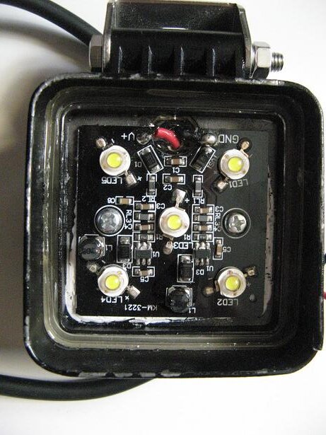

I can only speak for what I find retail OTC in Canada, which is a good selection of round, square/rectangular and bar-type after-market "auxiliary" LED vehicle lighting. Typically they run from 10-30vdc. Mounting is typically small bracket or two for smaller units. I can't confirm operation on vehicles as I've only used them indoors but ones I've obtained (and opened up a few) show rugged construction with good heatsinking, and overall good quality.
I agree on CCT, all seen here have been 5000K and above. As for changing LEDs. these lights are very well sealed and difficult to open without damage, at least to the plastic lenses; possible but difficult.

Image is inside a small 5-LED lamp, about 1000 lumens, lens removed. It is an older design.
