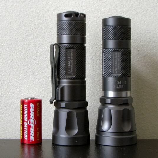

For the sake of the rest of this review, close-up shots will be in comparison to the original Jet-II IBS. The Jet-II PRO is on the left for all build pics.
Above, you can see how it compares in overall height - the PRO is 3mm taller than the original Jet-II IBS (i.e. PRO is 99mm vs IBS 96mm). However, width of the bezel is 3mm less at the opening in the head (i.e. PRO is 29mm vs IBS 32mm).

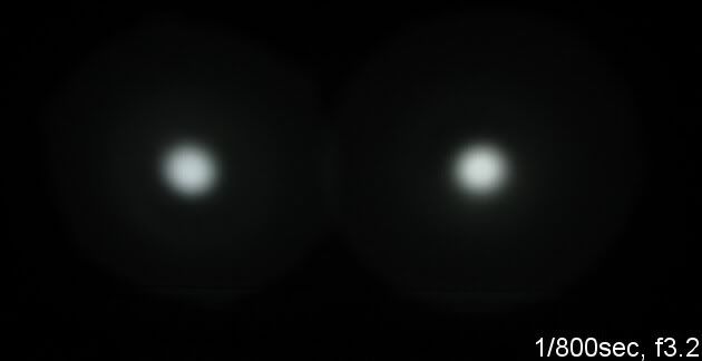

Comparison Beamshots
Both lights are on 100% on AW protected RCR, about 0.5 meters from a white wall.
As you can see, the overall output on max on RCR is comparable. Beam patterns are similar, although the Jet-II PRO has a slightly more narrow (and slightly brighter) spillbeam than the original Jet-II IBS. This is presumably due to the narrower reflector in the PRO version. You'll also notice it shows the "dimples" from the bezel retaining ring more prominently in the beam pattern up close (these disappear at further distances, and aren't typically noticeable in every day use).
Of course, the Jet-IIs are designed for throw, so these up-close shots don't tell you what you REALLY want to know.
I'll discuss the beam patterns in more detail after the Throw/Output and runtime comparisons below. I will try to do some longer distance beamshots and add to this post when available.

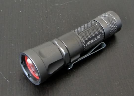

Like my Jet-II IBS, this revised PRO version was also a full shipping version with all package accessories. The light comes in a thin cardboard box with foam inserts and magnet to keep it closed. Although not very sturdy, the package arrived intact in the mail (where it was just packaged in an EMS shipping envelope).
Inside, you'll see the light comes with warranty card, manual, wrist lanyard, and spare parts (o-rings, extra black tailcap cover). Quality of the lanyard seems decent.
Exterior styling is very nice. Light comes in a dark slate grey HA finish, similar to their other models. Lettering is ok, although it is not as sharp or clear as some other makers. Like most Jetbeam lights (except the MK series), the light has knurling along the body tube to help with grip. Knurling is not overly aggressive, but it is slightly more raised than most Chinese-made lights. The smooth head has indentations to also improve grip.
And of course, there's the new bi-directional clip. Although some have called this is a "reversible" clip, that is not literally correct. The clip fits on in one direction only, but is designed so that you can clip the light in a bezel-down or bezel-up orientation (i.e. attach between the curved prongs, or between the clip and the body). AFAIK, Surefire was the first to make use of this excellent design in a mass-produced light (for their E1B Backup). The Jetbeam version is not made from as stiff metal, but still works well in my practice. And of course, it also serves as a very effective anti-roll device.

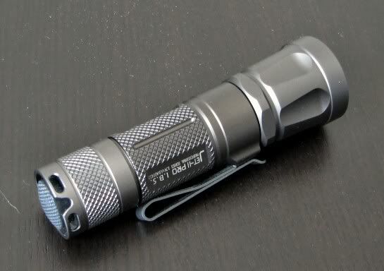

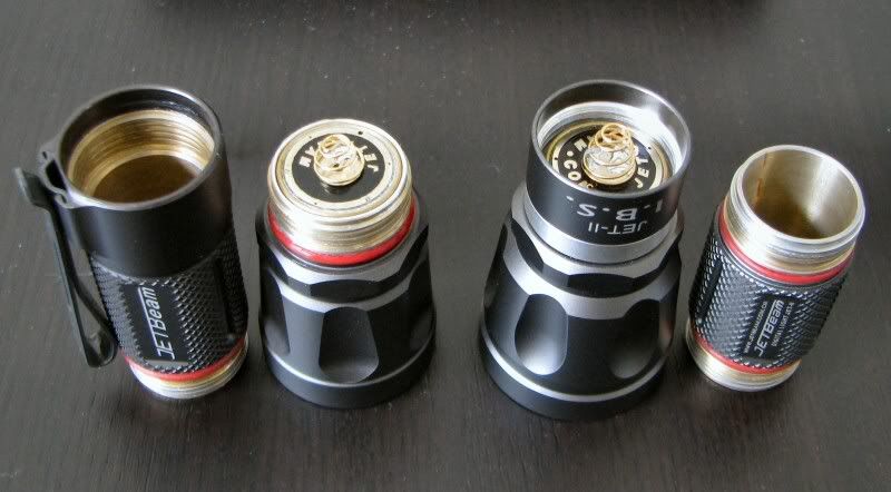

The tailcaps are interchangeable between the two models, but there is one key difference - the Jet-II PRO has anodized tailcap threads. This allows you to lock-out the light by twisting the tailcap - a very useful feature for travelling, and one I'm glad to see Jetbeam re-introduce. :twothumbs
As with all Jetbeam lights, the tailcap switch retaining ring is made of plastic. This is a concern for some in terms of long-term stability, although I haven't experienced any problems as yet on any of my Jetbeam lights.
The reverse clicky switch on these Jet-II lights seems to be larger and more substantial than on the 1AA model lights (i.e. MK IBS, Jet-I PRO). It also seems less "stiff" to me, but I suspect that's partly because of the larger rounded tailcap boot (see my Jet-I MK IBS review for a comparison, and a discussion of potential mods for the 1AA lights). The protruding tailcap boot means the Jet-II series cannot tailstand like the 1AA lights, but I personally find it much easier to enter the "hidden modes" with the quick 3-time flash (see below for an explanation of the interface).
As you can see, there are substantial build differences between the lights. The original Jet-II IBS actually comes apart into 3 sections, as the head can unscrew completely from the emitter/pill (see by original Jet-II/III IBS review for more pics). The Jet-II PRO is a single piece head that can't be open, similar in design to the Jet-III IBS (again, see the earlier review). The head contact board has a spring on it, so flat-top RCR batteries can easily make contact. I don't find the increased resistance due to this second spring to be a problem with any of my protected RCRs or primaries.
Both lights come with single o-rings at both openings, although they are a bit thicker on the Jet-II PRO. While this may help with water-resistance, I've found that the tailcap o-ring on my Jet-II PRO often tends to pinch up and bulge out around the tailcap lip when tightening. Personally, I think I'm going to replace it with the spare thinner o-ring from my Jet-II IBS
Screw threads are identical on both tail ends, and have the same square design as the Jet-I PRO. Like the Jet-I PRO and other high-end Jetbeam and EDGETAC lights, the non-anodized aluminum portions of the body has some sort of anti-oxidant coating that is brassy in color.

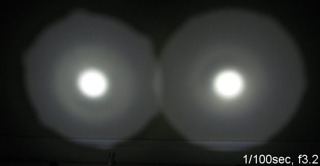

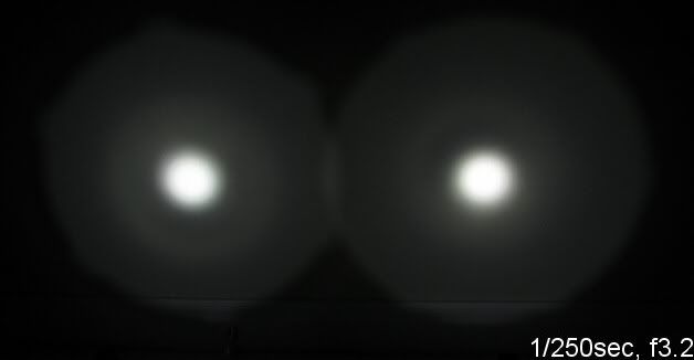

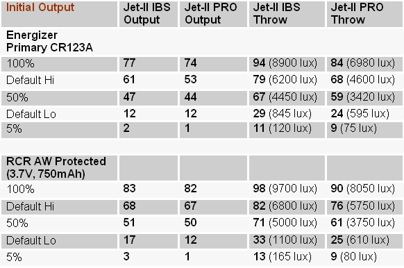

Testing Method: All my output numbers are relative for my home-made light box setup, a la Quickbeam's flashlightreviews.com method. You can directly compare all my relative output values from different reviews - i.e. an output value of "10" in one graph is the same as "10" in another. All runtimes are done under a cooling fan, except for the extended run Lo/Min modes which are done without cooling.
Ceiling Bounce Output: (on RCR on 100%)
Jet-II IBS: 9.0 lux
Jet-II PRO: 9.0 lux
At first glance, you can see there's no apparent difference in initial overall output between the lights on RCR (at least on med-hi levels), and a slight reduction of my PRO on primaries. I'll have more to say about this after the detailed runtimes below.

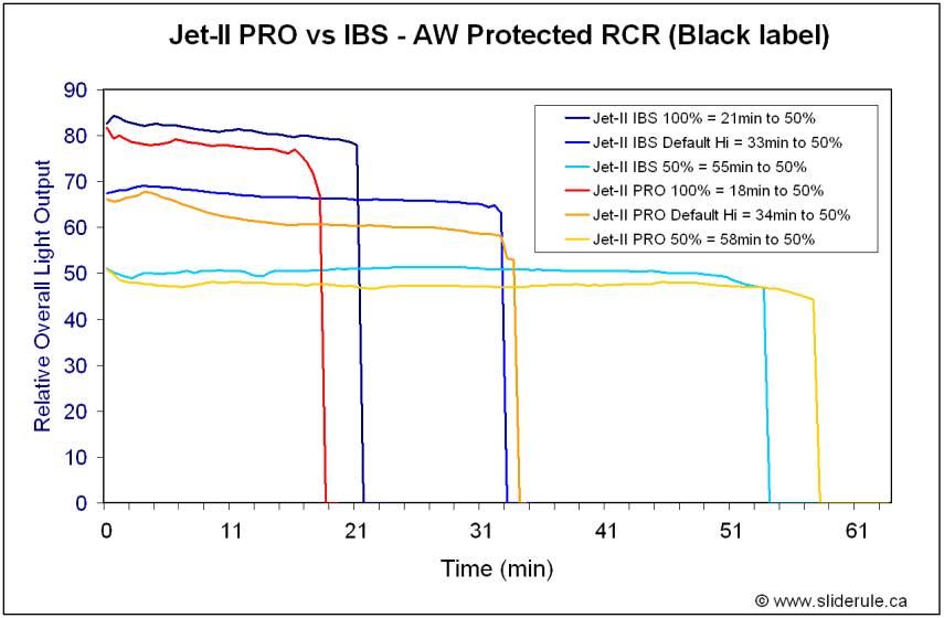

Output/Runtime Comparison:
RCR (AW Protected, black-label)
- As you can see, there is basically no real difference in output or runtime between the two lights on RCR. :thumbsup:
- The initial output on Default Lo is lower on the PRO version - in fact, it is actually better regulated now (the IBS version starts out brighter and slowly decays to a similar regulated level).
- Although output seems slightly lower on the PRO on the graphs above, this difference is less than 5%, and falls well within expected variability of the emitter output bin. In fact, I had noticed much same relative difference with my Jet-III PRO.
- Runtime seems lower on 100% (i.e. 18 mins on the PRO vs 21mins on IBS). In fact, my original IBS was a consistent 20-22 mins on each of my AW black-label RCRs - but when I tested the PRO on a different battery, I got only 13 mins. This is not surprising to me, since others have reported similarly lower runtimes on their original Jet-II IBS (see my original Jet-II IBS review thread). I suspect the problem is the incredibly high discharge rate at 100%, which seems to be >3C. This is not good for Li-ion cells, so I suspect we are seeing earlier termination in some lights due to the variation in battery current draws needed to produce the max output. I personally do NOT recommend running any of these lights on RCR on 100% for any period of time - for both the heat produced and the excessive discharge rates.
- It seems PRO runtimes are a bit longer on lower modes, but this again is not significant in my view.

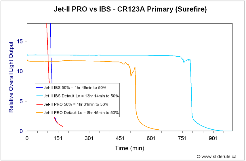

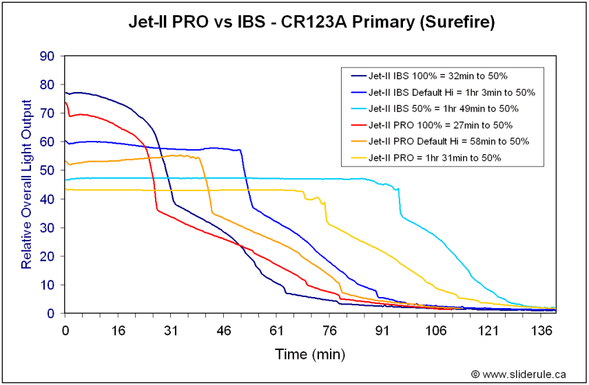

Primary CR123A (Surefire)
- Output on primaries is also lower than on my original IBS (typically, ~10% less). Again, I don't consider this to be a difference between models, but rather reflecting individual emitter output characteristics.
- Runtime is also reduced, typically 15-20% at the higher output levels (and more at the lower levels). I can only assume that this particular emitter was unlucky in its Vf characteristics (I don't know if Jetbeam selects on the basic of Vf as well as luminous flux output bin). Although I'm not sure why that should only affect primaries and not RCR runtimes (maybe something to do with the boost of lower voltage of CR123As?). I'll have to leave that to the electronics experts to comment on.
