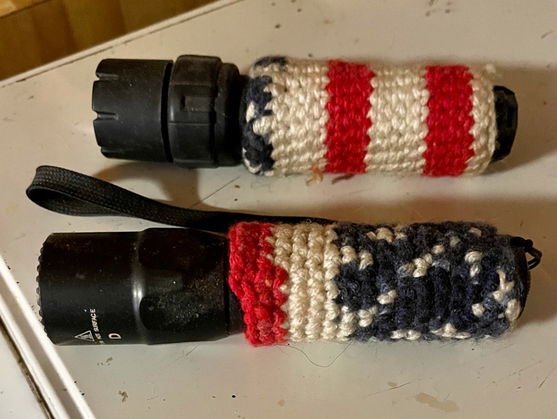

I put a glove over my flashlight if it has to be out in really cold air. Seriously. Same reason I wear a glove on my hand, to trap heat inside.
That and keep spare cells inside my jacket to stay warm.

I've noticed on low draw modes it'll last along longer, mittens for my torches do nothing in this weather, only having in on an interior pocket (under my overalls) for a while fixes this… my primary lights handle this better I wish there was a torch for cold weather but it seems no one has any additional advice which just means the tech isn't meant for cold weather which is exactly when I use torches ughhh (I edc a small one year round but my expensive ones are sort of bricks now for a month or two a year)
