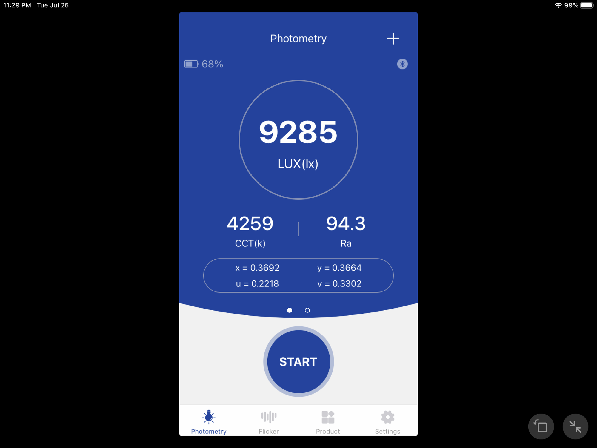

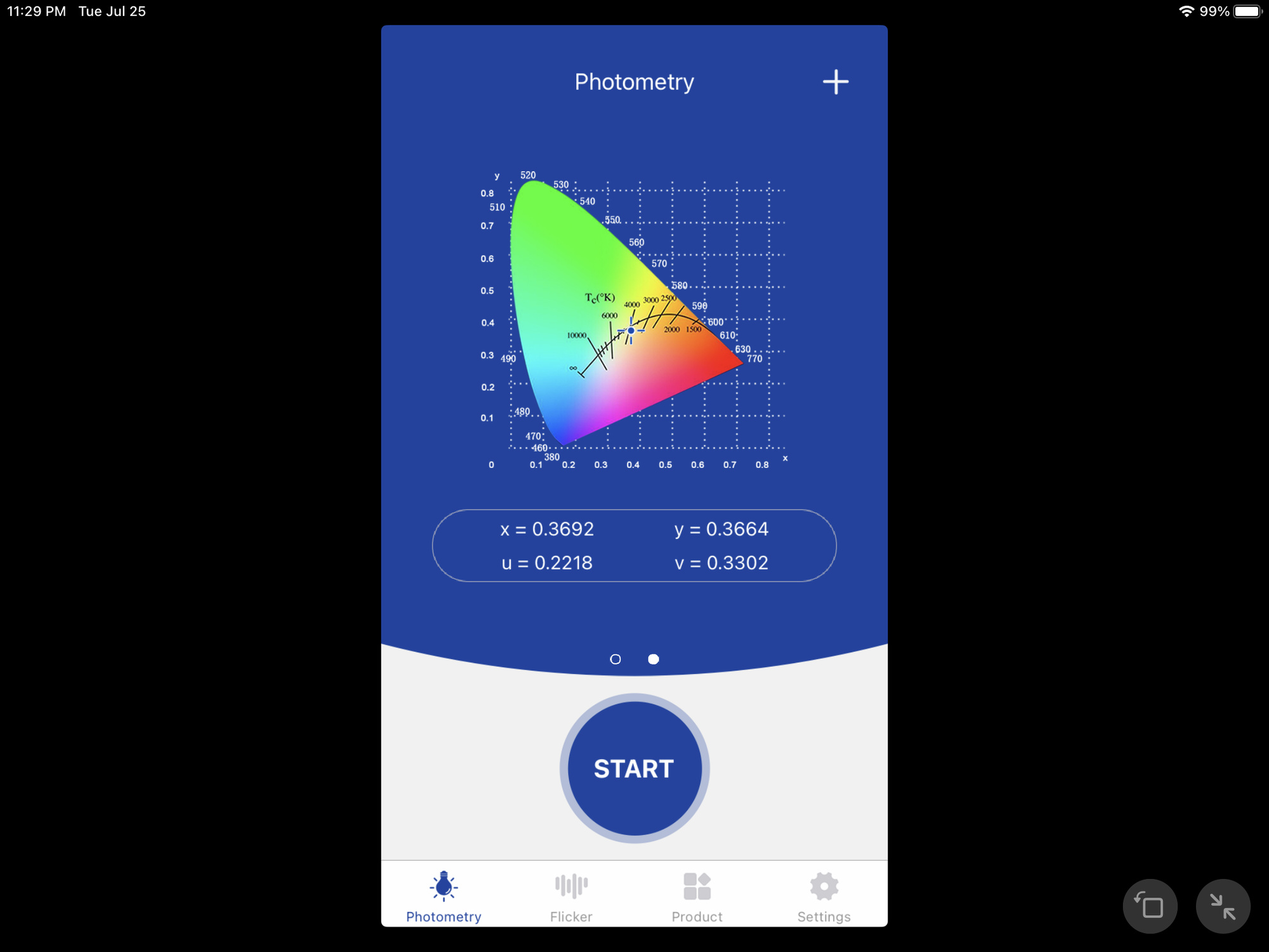

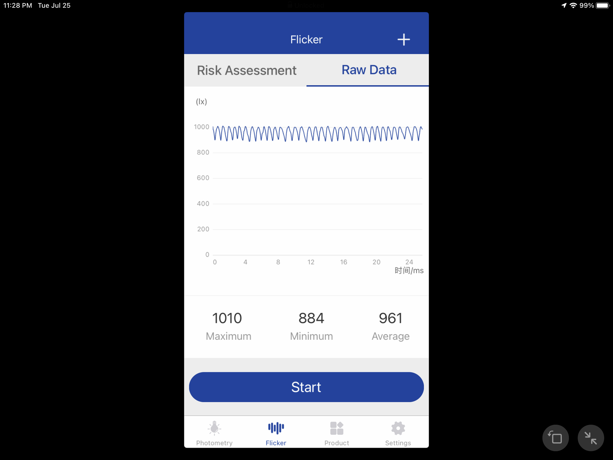

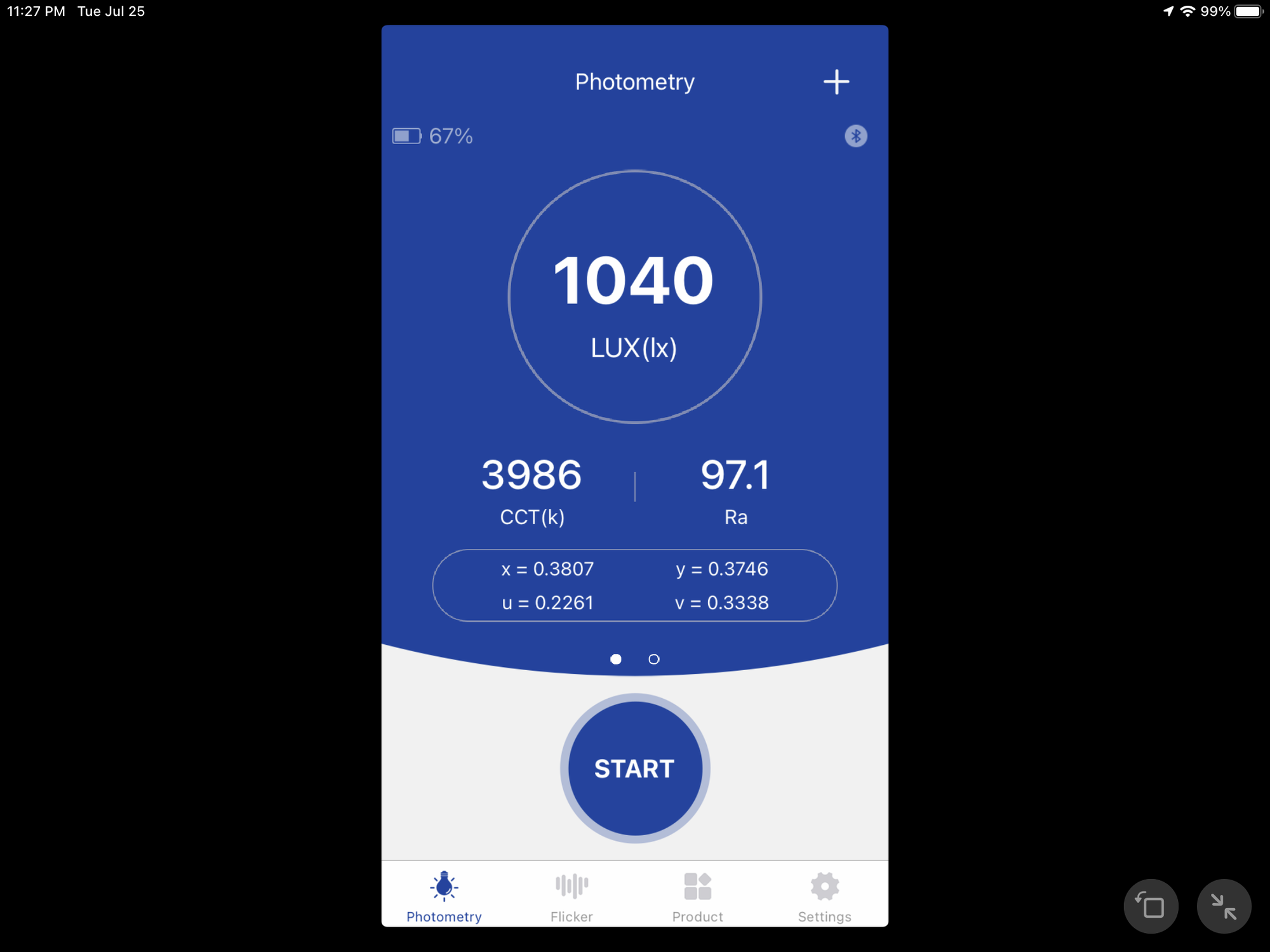

Lips
Mar 14, 2005
1,472
Louisiana - USA
Opple 3
1 meter away (Lux = Candela)
SC65c HI
This is what I got...
Duv -0.0015
Medium M1
Duv -0.0011

Level of confidence with these numbers?
I have no way to tell! What the Opple 3 read from 1 meter away. I think it's around what others have measured. I see no green in the beam, makes some other LED's look green on side by side. Each LED will probably look a little different if you have 5 lights shinning together...
