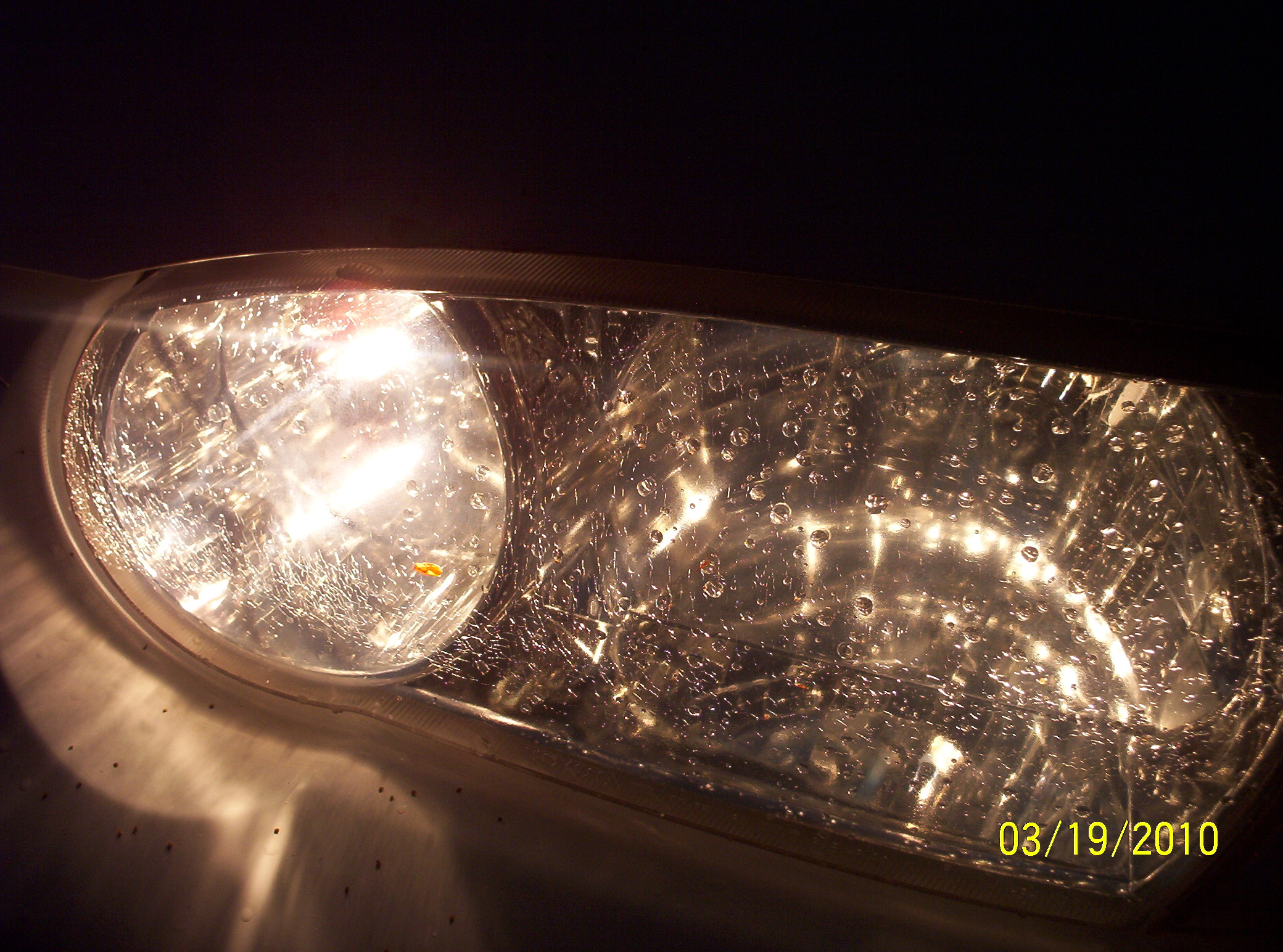

Probably one of the simplest 'upgrades' on a slightly older car is to polish up the headlight lenses and recoat them.
Time and again, Scheinwerfermann has said to get the kit from DoubleHorn Products, and the Allpar forums has their own photoessay on using the kit.
Here's my own results on a 2001 Corolla LE, mostly garage kept:
Let's start with the left headlight turned on to the high beam position. Eww.
Moving on, some closeups of the light turned off:
Notice the top edge of the lens is really hazy from UV exposure here:
Here are the lenses scrubbed up with the rough side of the included sponge and using their cleaner, keeping the lens wet while scrubbing:
I ran wet fingers across the lens here, otherwise it looked like the left one but less heavily scrubbed:
Then the right hand polished:
Then closeups of the left one after being sprayed with the protective coating
I'll add another "on" pic of that left headlight light tomorrow.
Let me be the first to tell you that while I'm extremely obsessive compulsive about "doing things right", I'm also strangely lazy. I'm sure other people are much more patient than I am when doing a project like this, yet despite my impatience the results are excellent.
Because this is pic heavy, be nice to your fellow CPFers and *don't* quote the images when quoting me in replies.

I have noticed what appears to be fine cracks all throughout the headlight lenses now... Were they always there and I couldn't see them before, or did I press too hard while polishing? Or maybe it was that it was pretty cool out (below 50F) when I sprayed them?
I have so much of the kit left that I could just scrub them back down again...

Here's the lights the next day illustrating the "cracks". Lenses are now wet and dirty as it started raining earlier when my wife drove the car home.
And here it is lit. I'm guessing white balance comparison between yesterday's pics and the day before will be difficult because it was overcast and rainy yesterday; still relatively clear the day before. Still, it should illustrate the difference between the clarity of the lamps.
Scheinwerfermann: Do you expect the crackling will be a problem for oncoming drivers, or should I not be extremely worried?
Maybe it's not crackling in the lenses-- maybe it's crackling in the spray due to some of the micropolishing compound not being totally cleaned off and the lenses also not being absolutely dry before spraying (I thought I'd cleaned it off well enough and the lenses had dried sufficiently).
Can't tell for 100% certain from these pics, but it looks to me as if the lens itself -- the actual polycarbonate -- has crazed with age, heat, and UV exposure. The only way to tell for sure would be to remove the coating and check again. These craze marks will have the same effect as surface pitting: more glare/stray light. Are they bad enough to worry about? It depends on how much you care.

I *do* care that it could cause some glare for other drivers; I rationalize that surely it's less now that the hazing itself has been removed.
I suppose that the original anti-UV coating of the lens was mated to the surface such that it wasn't apparent that the crazing was there, and stripping it revealed it. I may be able to just polish down further into the lens as it may yet be on the surface, not deep enough such that removing lens material will just go through to the other side or even substantially weaken the lens.
Doing the A/B comparison here (I'm allowed to quote my own pics :) )
(Full size pic links before and after)
Odd. I sure hope I didn't crack it getting overexuberant with scrubbing/polishing by pushing too hard and flexing the lens.
Well, I don't know how hard you pressed/flexed, but yes, crazing of the type we see here will definitely result from flexure of polycarbonate, and the amount of flexure required to cause it gets lower as the material ages and goes through thermal cycles, UV exposure, etc. So if you really threw muscle into polishing these lenses, it's possible you might have caused or aggravated the crazing. This kind of appearance does not result from applying a coating of this nature over not-entirely-dry substrate.
