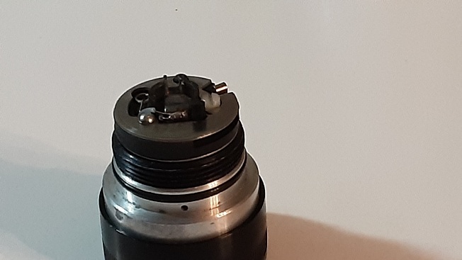

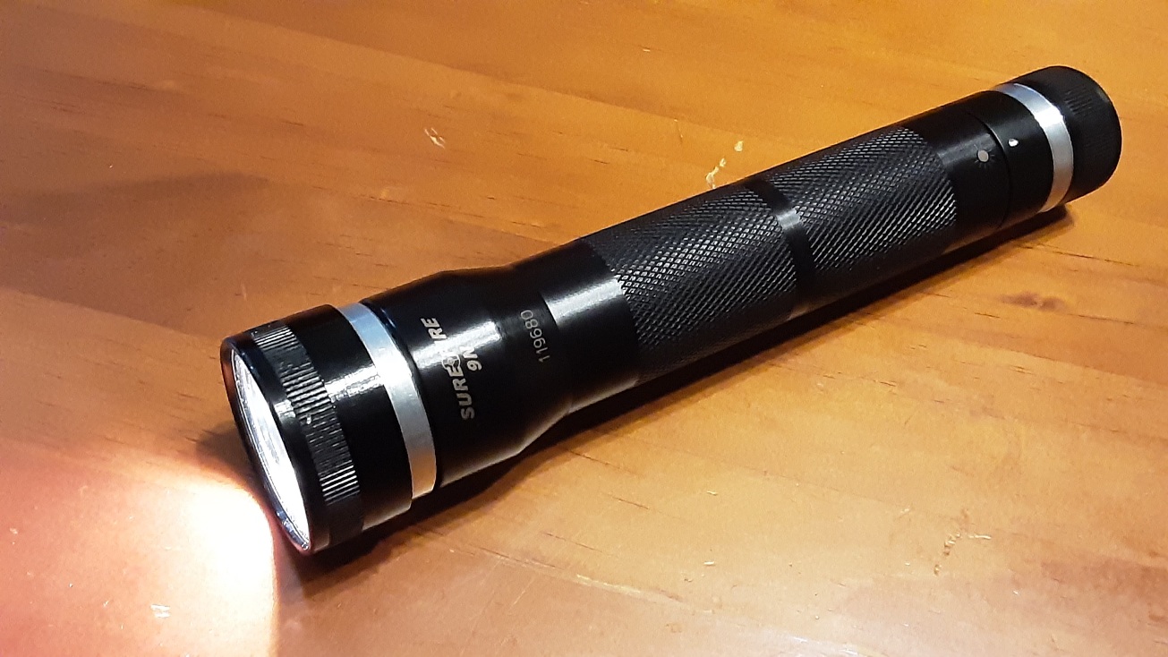

I purchased this unique light many years ago during an "acquisition stage" but have only recently taken it out of storage again, the B90 NiCD stick is holding a charge after 10+ years so definitely a testament to Surefire, my only issue apart from tarnished contacts (easily cleaned) is the n90 lamp appears to have continuity issues for the primary lamp which works intermittently, a Google search reveals these lamp modules to be unobtainable leaving only Lumens Factory LED drop-ins & Tad Customs bi-pin Strion adapters (both of which defeat the twin lamp function).
I think modding the n90 might be good fun but not if I can't secure another 🤔

I am a collector and found the 9N desirable but opinions/tastes vary, batteries are no issue with NiCD, NiHM battery sticks readily available, alternatively 3 sub C cells or an 18650 + adapter, my primary wish/intention is to maintain a working dual bulb arrangement (even if one is a 5mm LED).

NIMH sticks don't last nearly as long as Nicad's IME. I had an electric razor from the 90's, which the two Nicad AA batteries just finally died for good recently. NIMH last.. 2 or 3 years it seems. And their capacity starts going down right away. They lose charge quickly, though not as bad with Eneloop style batteries. They have problems if the temps are not just right.. No reason not to use a Li-ion adapter in this light these days IMO. And I've used IMR's and protected ICR's and all kinds of lithium ion batteries, they all work fine, and you get a little bit more brightness, but not to the point where it really stresses the lamp assembly.

When the "low" bulb
(it is not low, but in this light here, it is the low one.) :)
finally poofs :poof:, You could carefully remove it, keep the wires as long as possible, shorten the black holding rod, put a white 5mm led in and so "repair" the light insert.
(shorten the rod is not that important, but because the led has its own reflector, it has no need to extend much outside of its hole + nothing blocks the main bulb's beam inside the main reflector)

You want to use non rechargeable batteries? Lumens factory makes a great adapter to run 18650’s if you want to go that route.
If I were to choose the "casual user" path, 3 single sub C cells (still rechargeable) would be my preference because choosing AA cells instead would require a DIY battery carriage 👍
